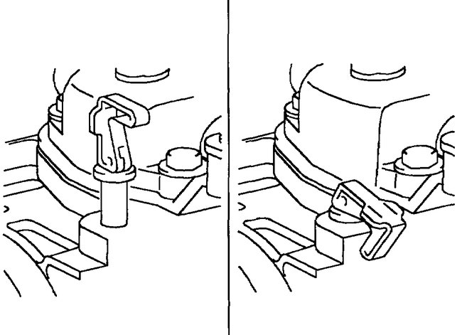

One last thought. Make sure the fluid is clean and full. Here are directions on how to check it. The attached pic correlates with these directions.

Pic 1
1. Park vehicle on level ground with engine off.
2. Flip the handle up and then pull out the oil level indicator (dipstick). Wipe the oil level indicator off with a clean rag or paper towel.

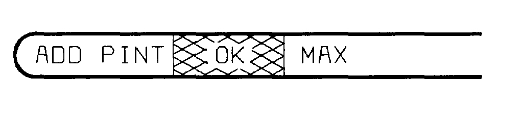

pic 2
3. Push the oil level indicator back in all the way and then remove it.
4. Check both sides of the oil level indicator, and read the lower level. The fluid level must be in the cross-hatched area.
5. If the fluid level is in the cross-hatched area on the oil level indicator, then push the oil level indicator back in all the way and flip down the handle to lock it in place. If the fluid level is below the "ADD" mark, then add only enough Saturn Transaxle Fluid to bring the fluid level up to the middle of the cross-hatched area on the oil level indicator.
