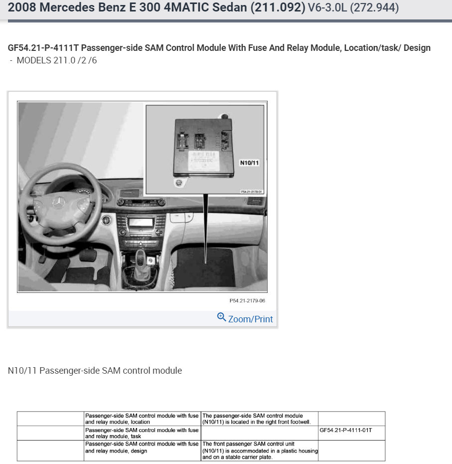

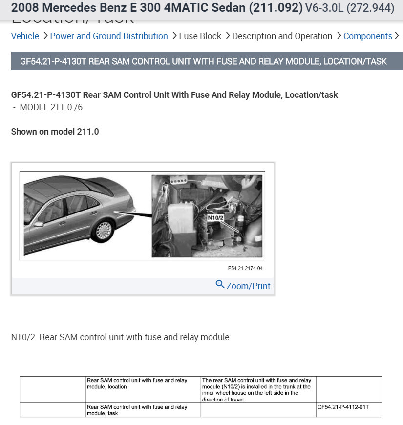

I would start by checking the fuses. Here is a guide that will help. Also, check the rear sam units for water damage which is common. Remove the connectors to check for corrosion.
Check out the diagrams (below). Please run some tests and get back to us.
