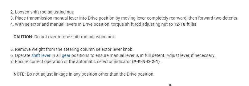

Engine does not rev up, all forward gears work, no reverse and in park
1992 FORD F-250
150,000 MILES
JAMES CODY
i changed the fluid and filter. helped a little. but somethings still wrong. won't rev up and i have neutral in the reverse position when i turn it off. i have looked at the linkages but haven't gotten any further. i haven't adjusted any of them. they seem to be tight, no slop.

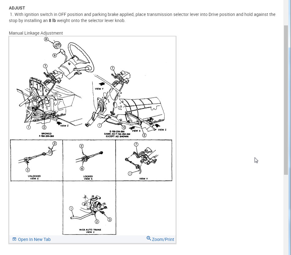

This issue is most likely caused by your shifter linkage is out of adjustment. This means when you think you are in drive according to the shifter it is actually not fully engaged. This is why when you turn it off, it says it is in reverse. It is not actually in reverse but the shifter needs to be adjusted so that when it says it is in D it is actually in drive.
I attached the process of how to do this. Let me know if you have questions. Thanks
