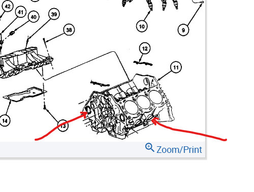

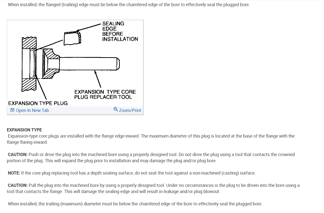

Freeze plug locations on the car listed above?
Jan 26, 2023 at 4:53 AM
  • 55,433 POSTS

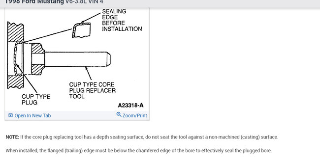

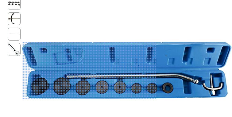

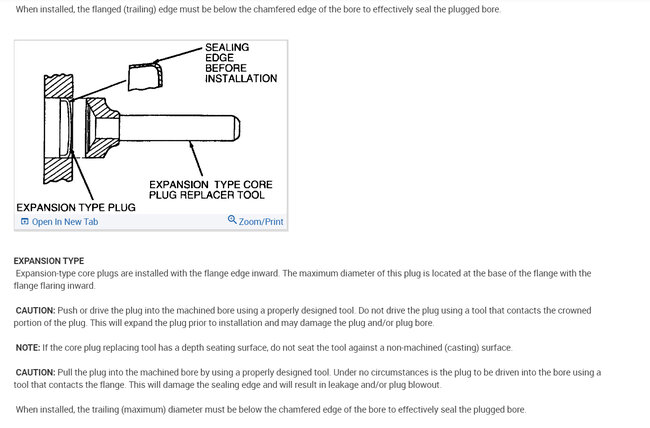

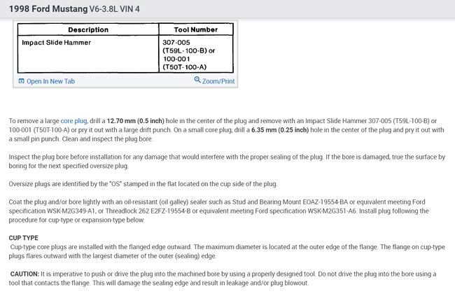

You have freeze plugs down either side of the block and in the front and rear of the block as well. here is an image of the locations and how to change them out as well. Check out the tool they use to do the job. Check out the images (below). Please let us know if you need anything else to get the problem fixed.
Jan 27, 2023 at 4:09 AM
ANTCORTEZ
Do I have to remove the transmission?
Jan 27, 2023 at 4:42 AM
  • 55,433 POSTS
To get the ones in the rear of the engine yes.
