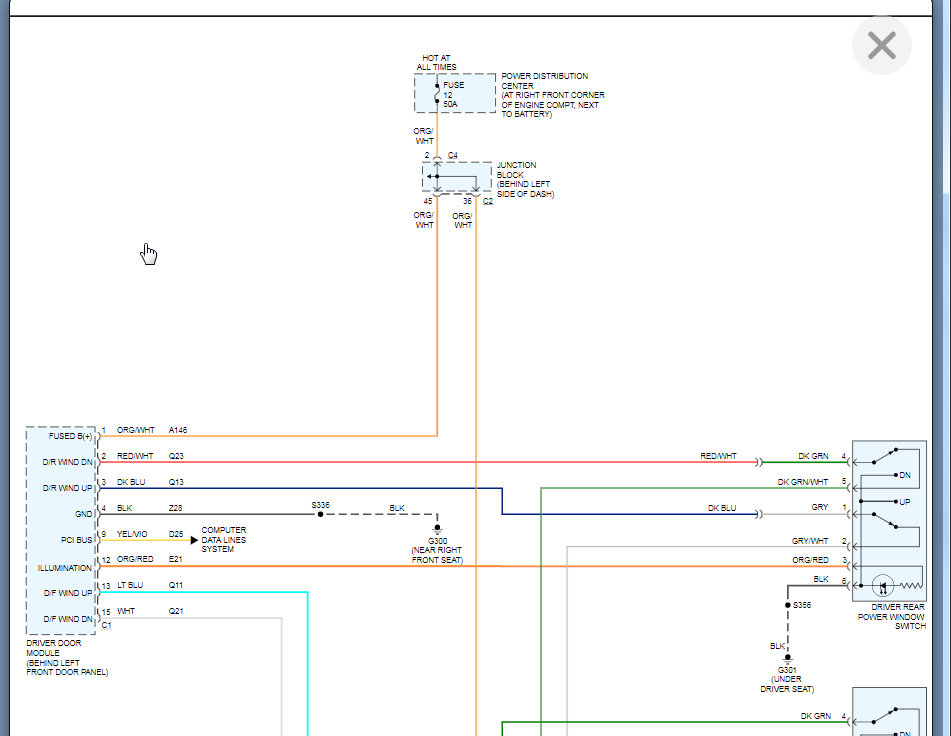

All four windows will not roll up or down
2004 JEEP GRAND CHEROKEE
140,000 MILES • 4.0L • 6 CYL • 2WD • AUTOMATIC
GRANDMAHONKY

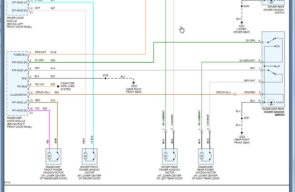

Need the fuse diagram and the circuit relays. I know where they are but don't know which ones are for the windows. There was a broken black ground wire but I have fixed that and they still don't work.
Apr 10, 2020 at 3:21 PM
Here is the diagram. There is one fuse that feeds B+ to the front switches and then they feed the rear windows.
Let me know if you need ore info on this and we can go from there. Thanks
