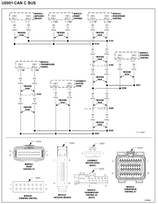

Thanks so much for responding!! Sorry, I thought hey why not ask about the other problem. Attached is what the mechanic pulled the first time I brought it in. I do believe the battery is good, but will double check. Not sure about alternator output, but will check on that as well. I talked with the previous owner this weekend, and he said he had problems with the sunroof for years, but has never been fixed. The mechanic is probably going to start there, along with the two other areas where voltage output is low. One of them is the ABS, and oddly enough I had brought it in about a month prior because the ABS light came on and wouldn't shut off. The mechanic pulled the codes and it was a "stored" ABS code so he cleared it and ran fine until the problem above. Thanks so much for your expertise.
Sep 8, 2019 at 10:54 AM
JIS001
  • 3,412 POSTS
Thank you for the reply and as suspected, darn U codes. Those are a lot of codes. I believe we need to focus on U0001 Can C Bus. Diagnosis shows if every test is good then the front control module will need to be replaced. But since it looks like you had body work you may need an engine harness. Here is what needs to be checked..

U0001-CAN C BUS
U0001 - Can C Bus
Open In New TabZoom/Print
WHEN MONITORED
With the ignition on.
SET CONDITION
The FCM detects a short in either CAN C Bus circuit.
POSSIBLE CAUSES
- (D65) CAN C BUS (+) circuit shorted to ground
- (D64) CAN C BUS (-) circuit shorted to ground
- (D65) CAN C BUS (+) circuit shorted to voltage
- (D64) CAN C BUS (-) circuit shorted to voltage
- (D65) CAN C BUS (+) circuit shorted to (D64) CAN C BUS (-) circuit

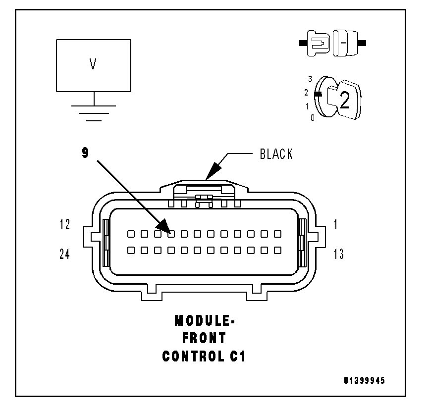

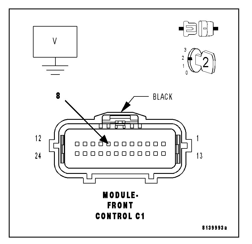

7. (D65) CAN C BUS (+) CIRCUIT SHORTED TO VOLTAGE
Turn the ignition off.
Disconnect the Front Control Module C1 harness connector.
Turn the ignition on.
Measure the voltage between the (D65) CAN C Bus (+) circuit and ground.
Q: Is there any voltage present?
YES: Repair the (D65) CAN C Bus (+) circuit for a short to voltage.
Perform BODY VERIFICATION TEST - VER 1. See: A L L Diagnostic Trouble Codes ( DTC ) > Verification Tests > Body Verification Test
NO: Go To 8

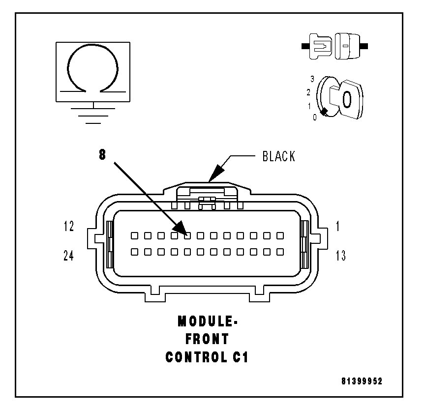

8. (D64) CAN C BUS (-) CIRCUIT SHORTED TO VOLTAGE
Measure the voltage between the (D64) CAN C Bus (-) circuit and ground.
YES: Repair the (D64) CAN C Bus (-) circuit for a short to voltage.
NO: Go To 9

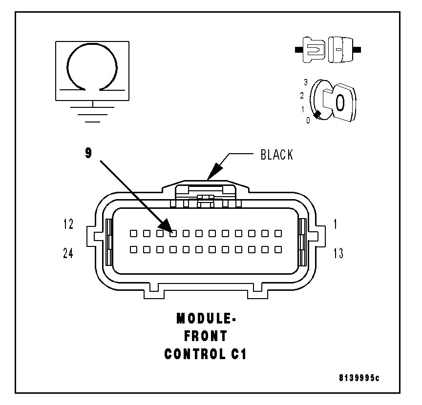

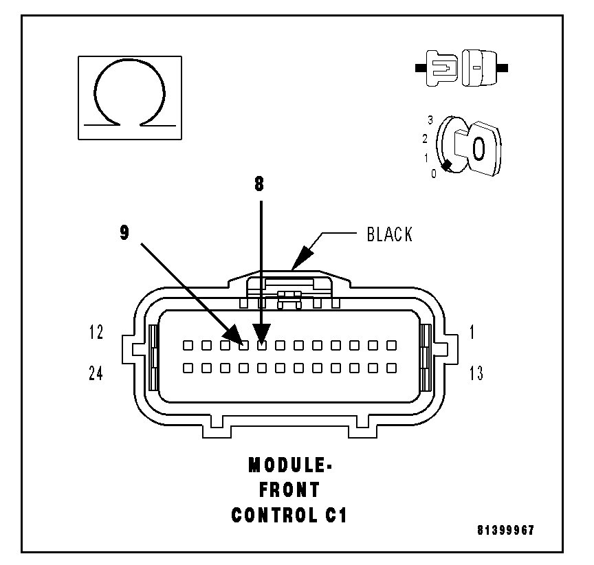

9. (D65) CAN C BUS (+) CIRCUIT SHORTED TO GROUND
Measure the resistance between ground and the (D65) CAN C Bus (+) circuit.
Q: Is any resistance present?
YES: Repair the (D65) CAN C Bus (+) circuit for a short to ground.
NO: Go To 10
10. (D64) CAN C BUS (-) CIRCUIT SHORTED TO GROUND
Measure the resistance between ground and the (D64) CAN C Bus (-) circuit.
YES: Repair the (D64) CAN C Bus (-) circuit for a short to ground.
NO: Go To 11

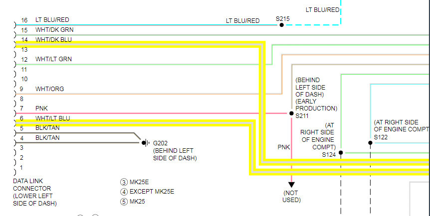

Something like this and especially if you may have been in a collision I recommend you go through your insurance since diagnostic like this can be very expensive. I have seen this too many times where a vehicle comes in especially with a salvage title where diagnosing network problems because a body shop solder something wrong painted over a ground point, or wires are damaged that it makes it very difficult to diagnose and very expensive.
If your mechanic is up to the challenge then the info I gave you should give them a starting point. But he may decline because of the work will take way too long without charging hours of diagnosis. I am sorry if this is not the news you wanted to hear but every wire on that procedure, every connector that needs to be disconnected and resetting codes to see what comes back on is very difficult to pinpoint. The C Bus failure pretty much narrows down all the module faults you have posted.

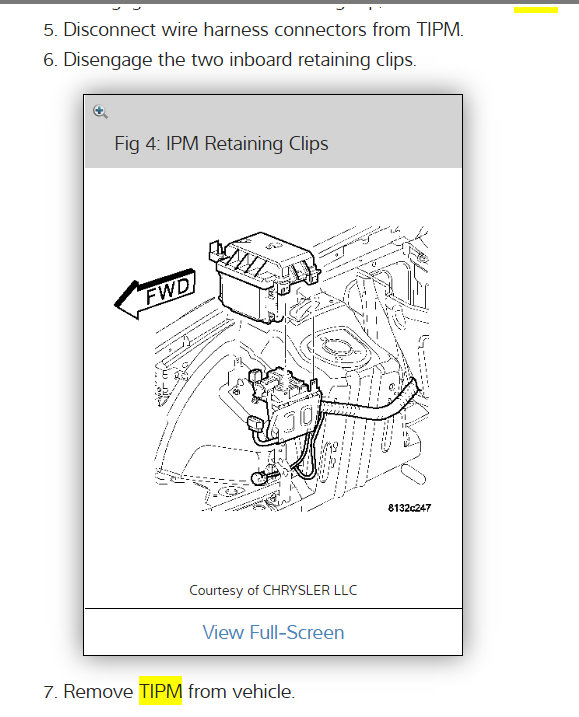

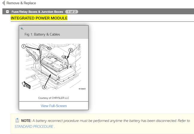

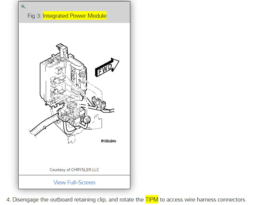

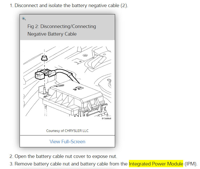

This is common when the TIPM goes out but the good news is they are easy to replace because they self initialize. Here are the instructions on how to replace the unit in the diagrams below. Check out the diagrams (below). Please let us know what happens.
Sep 11, 2019 at 3:28 AM
Just to jump in and add my opinion, I would agree with the most common cause of something like this is the TIPM. The only thing I would caution is if this vehicle was in an accident that a compromised harness is causing the issue as JIS mentioned.

You can do this by hooking into pin 6 (CAN +) and 14 (CAN -) of the data link connector. Monitoring these circuits will tell you if you bus is down. You voltage should be 2.3 volts and 2.7 volts, +/- .3 of a volt.
If it is down, one or both of the legs of the bus will be off and these two voltages will not equal 5 volts. A properly operating bus network will equal 5 volts and be within the .3 of a voltage range when monitored with a multimeter. Then you can test each pin (6 and 14) for a short to ground, power, and shorted together.
If you find an issue with the bus voltage not being proper then the next step is to continue to monitor it and start unhooking modules one at a time until it returns to normal. If no module causes it to return to normal then you have a wiring issue, however, you should have found this when checking power, ground, and shorted together.
Hopefully, this helps but these are not the easiest to track down but it is possible.
