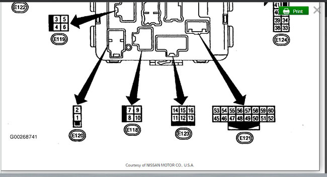

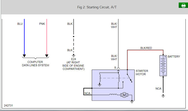

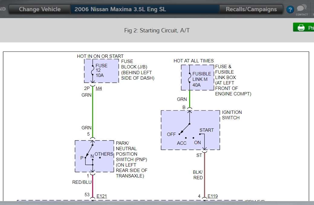

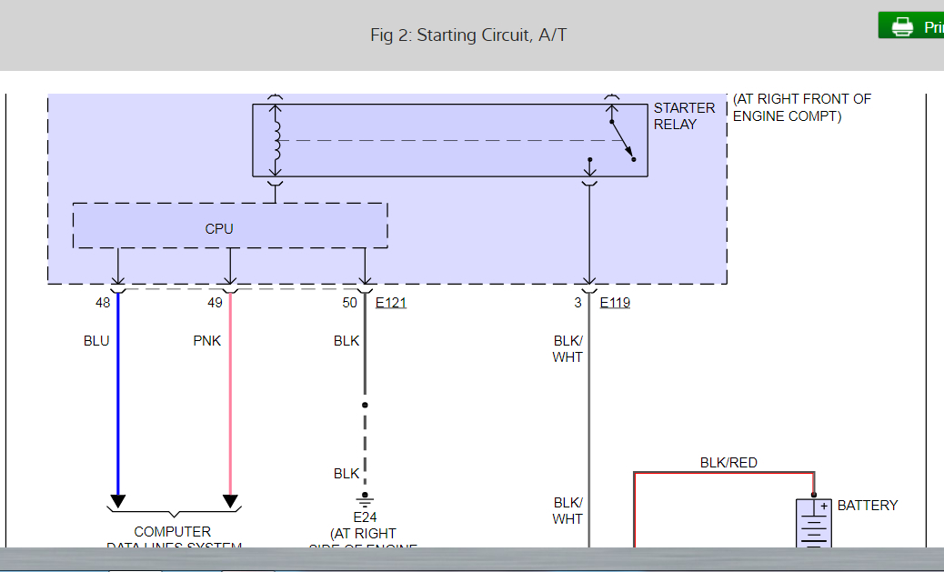

I have all dash lights, car runs through system test when I turn the ignition over it just clicks. I've replaced the starter, neutral position safety switch and the dtrl relay. still just a click when I try to start the car in park or neutral.
Apr 20, 2019 at 8:51 AM
SCGRANTURISMO
  • 4,897 POSTS

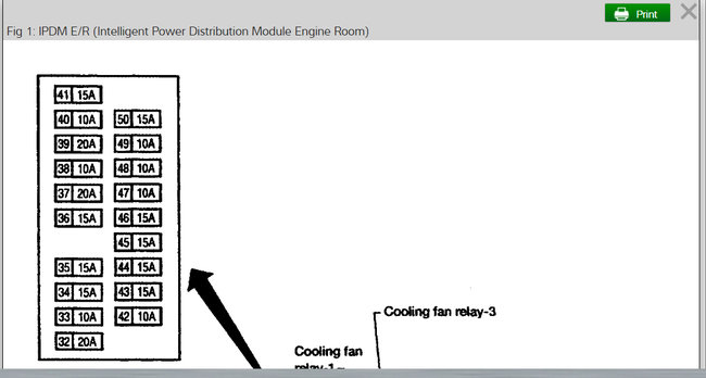

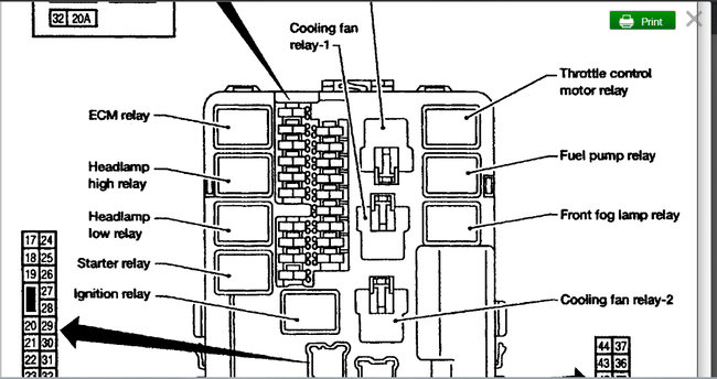

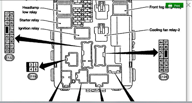

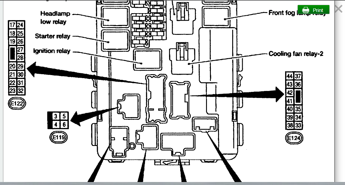

This could be a problem with your vehicle's starter relay. It is located in the PDM E/T which is at the right front of the engine compartment. I have included a link below for you to go to:
In the diagrams down below I have included wiring diagrams and component diagrams for you to go through as well. Please use these guides to test the starter relay and get back to us with what you are able to find out please.
