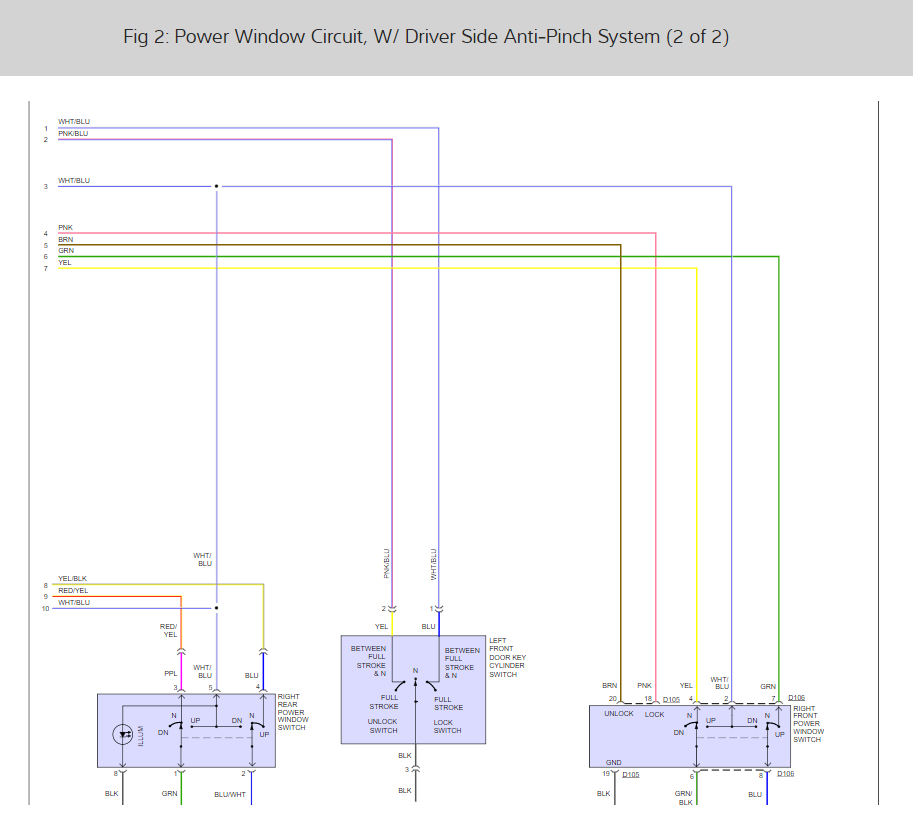

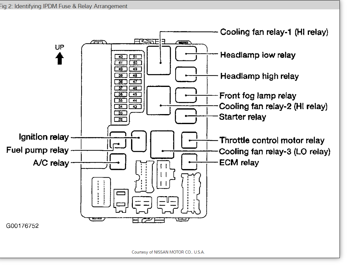

All four power windows will not work
130,000 MILES • 4 CYL • 2WD • AUTOMATIC
MARK PETERSON2
I changed the master switch. what else can i do?
Feb 18, 2019 at 3:21 AM
PATENTED_REPAIR_PRO
  • 1,853 POSTS

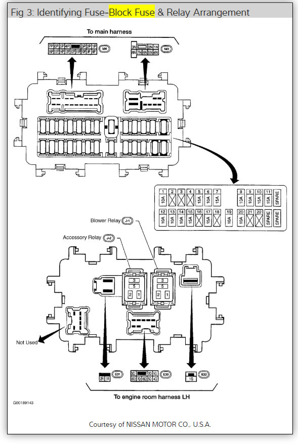

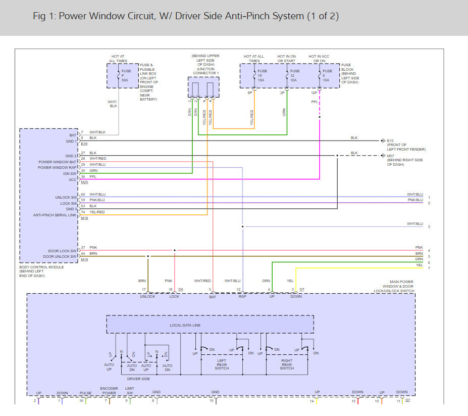

They are normally all protected from the same circuit breaker, find it and try a new one.
Feb 18, 2019 at 3:39 AM
  • 55,560 POSTS

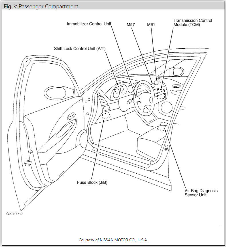

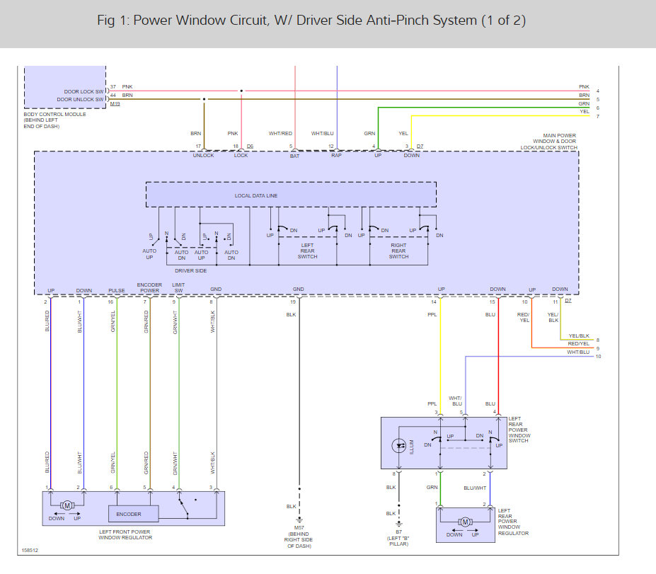

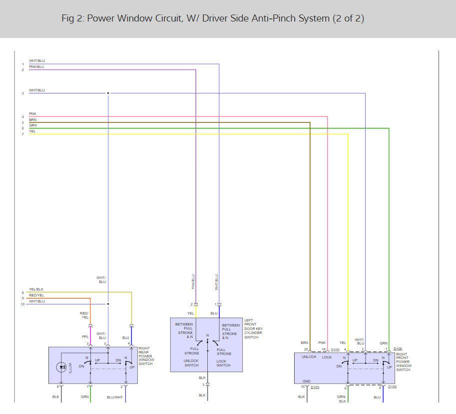

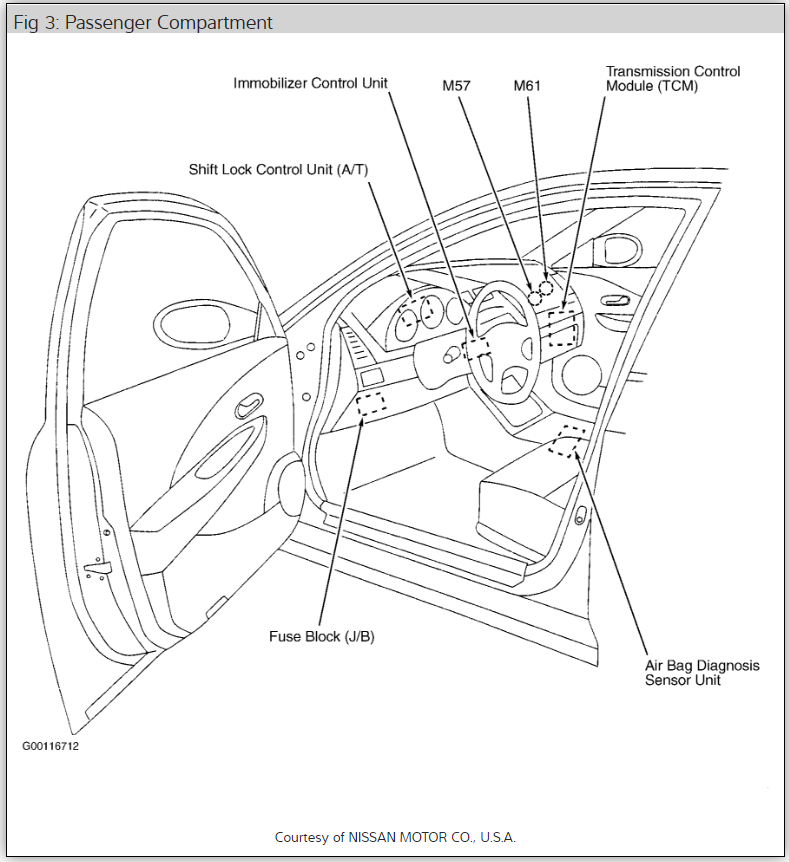

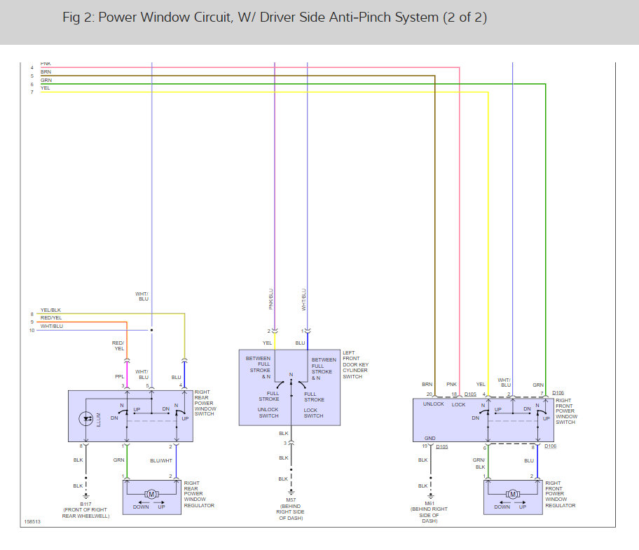

Can you check to see if there is power at fuses # 19 and 12? Here is a guide the help test for power and the window wiring dDiagrams so you can do how the system works and fuse location below:
Check out the diagrams (below). Please let us know what you find.
