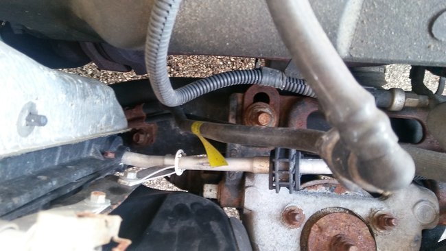

When I bought car the steeering and suspension felt like new. I noticed the stabilizer bar moved excessively after looking for a squeek(it was the hood stops,lol) Anyways, I noticed the S. bar was easily moveable by hand from left to right until the bar hit metal set screw stops. The inside of the bushings were wore pretty bad so i replaced them, It was my first time and replacing S. bar bushings and I was in a hurry so I sadly just installed to where it was upon removal without checking its orientation.
After driving the car for about 3 weeks, I noticed the left tires toe out was excessive on left wheel making it stick out like a sore thumb, the right wheel was also toed out , but not quite as much as the left. Then I noticed the rear wheel were following the same direction as the front.
The steering wasnt as tight as before the bushings were replaced. I was worried because i looked at the wheel geomatry when i bought the car and nothing caught my eye at that time.
I know that tie rods usually cause toe in or out problems but I wanted to give it a good look. The (camber/mounting bolts for tje upper control arm were set roughly in the middle of the guide holes on the drivers side. However, the passenger side upper control arm bolts were set all the all the way at the end of the mounting guide holes(not sure of the correct name for them) closer inward on tje frame towards the engine. This didn't seem right to me, they shouldnt be that far off from a previous alignment unless something is out of bent out of whack....right? Or are these common alignment adjustments?
The lower control arm bolts bolts that go through the the inner sleeve on the bushings were both offset towards the pass. side so much that they collapsed the rubber inside the bushings about a 1/4" or so, but without seperation frm outer or inner sleeves. The bushings connected to the aluminum rack and pinion cross member looked good to me. Do I need to replace the bushings mounted tp the frame or are they ok?
My end links are not even close to being in line with each other and far off from being inline with each other, is tjat acceptable?
Both lower and upper ball joints on both sides look to be in great shape boots and all tje only thing im not sure of is that they are mis matched with OEM w/no zerks and w/aftermarket with zerks. Will the mismatched ball joints affect anything negatively? Front blue coded springs look newer on both sides. The shock absorbers on botj side are in decent condition and rebound with one bounce.
Oh yea botj front and rear passenger side tires are wore about 30-40% more than the driver side and the outer edge of all four wheels are worn a little more than the in edges all 4 wheels have a slight cupping wear pattern also but not bad in my opinion.
The car does bump steer over bumps slightly on big bumps but only at 40+mph other than that it handles bumps smooth as butter.
At highway speeds drive fine but if I go 75+mph i get a intermittent front end rattle depending on smoothness of highway .
The driver side abs wheel sensor connector fell out of clip wire pins and all. Since then the steering wheel responsiveness feels laggy when turning especially turning left at low speed. Car has variable ps assist and i read a abs speed sensor can wreak havoc on steering if its malfunctioning or not working.
Ok my main concern is with reguarding all of this info does it sound like my frame is bent or is it such a nightmare for alignment shops they wont touch it.....or is it simply a matter of adjustments after my front lower control arm bushings to frame replaced. I forgot to check rear but i figured it just followed the front and ill replace bushings arms accordingly.
Thank you to anyone brave enough to tackle dive into this one. I can send pics if needed in the am. 2carspros experts and admins. rule all!!!

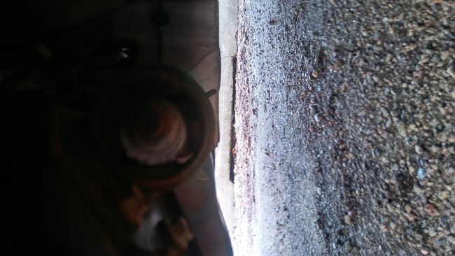

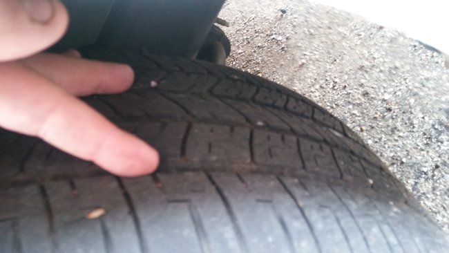

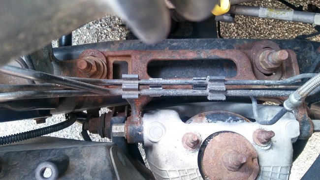

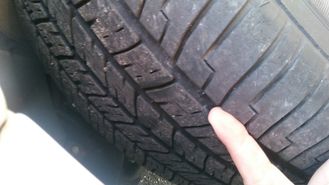

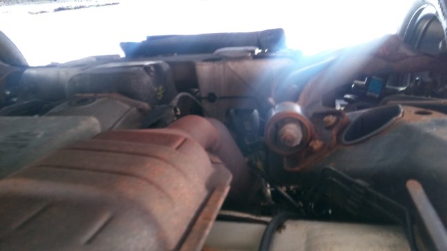

My car has goodyear eagle m+s tire with traction and temp rated at A and the speed rating of 98w. I will send before and after pics once its aligned so you can decypher the readings. I have some pics of front alignment adjustments and tire wear if you can tell anything from just that.
1. Front. Dr. Side tire
2. Front pass. Side tire
3. Dr. Side lower c arm
4. pass. Side lower c arm
5. Dr. Side lower c arm bushing( both pass. And dr. sideshave the mounting bolt offset from middle and shifted towards pass. side. Pic isnt great. Anyways do these need replacing?
Both pass. side tires have same wear, and the dr. side both have same wear. This doesnt make sense to me unless the po rotated them that way for to fix the cars pull. But the car pulls a tiny bit to the right that is a** backwards.

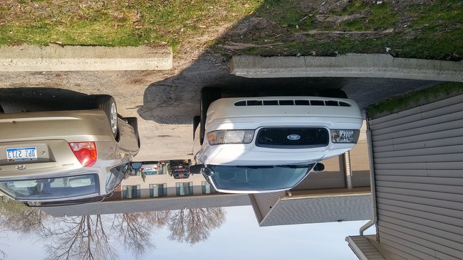

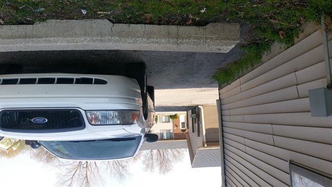

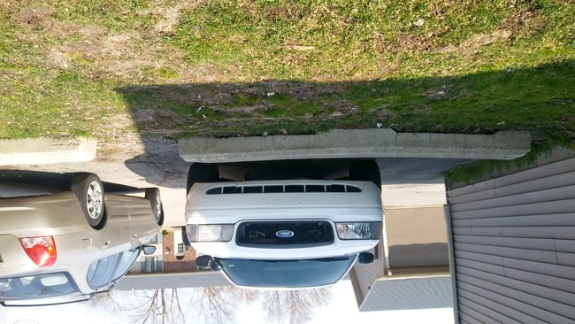

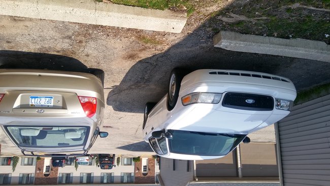

I forgot these pics. I know its not sitting even or if the different is visible to you via camera orientation so it might not help. It was windy as heck outside and blowing dirt in my eyes so I didnt get the best pics. Dont know why they are upside down.

Photos 3 and 4 should be the upper control arms. The slotted areas under the nuts are the inter-related caster and camber adjustments. This type of adjustment was common on older Fords and Chryslers. It's not abnormal to find one of these adjustments all the way to the end of its travel, but if you find both of them on one side adjusted as far as they can go, and you need more adjustment, that's the time to suspect sagged ride height.
Direction wheels are leaning and steering is hard to tell from photos. The biggest problem has to do with the rounded body panels. Your front fenders can make a front wheel appear to be turned out to that side. We used to sight along the front and rear of the sidewall, then extend that line of sight to the rear tire, but even that can be misleading. A lot of models have front wheels that are further apart than their rear wheels. I've run into that too many times when I thought something was badly out-of-adjustment, but found everything to be fine according to the alignment computer.
