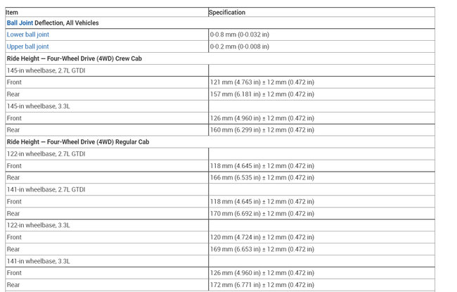

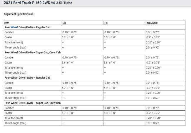

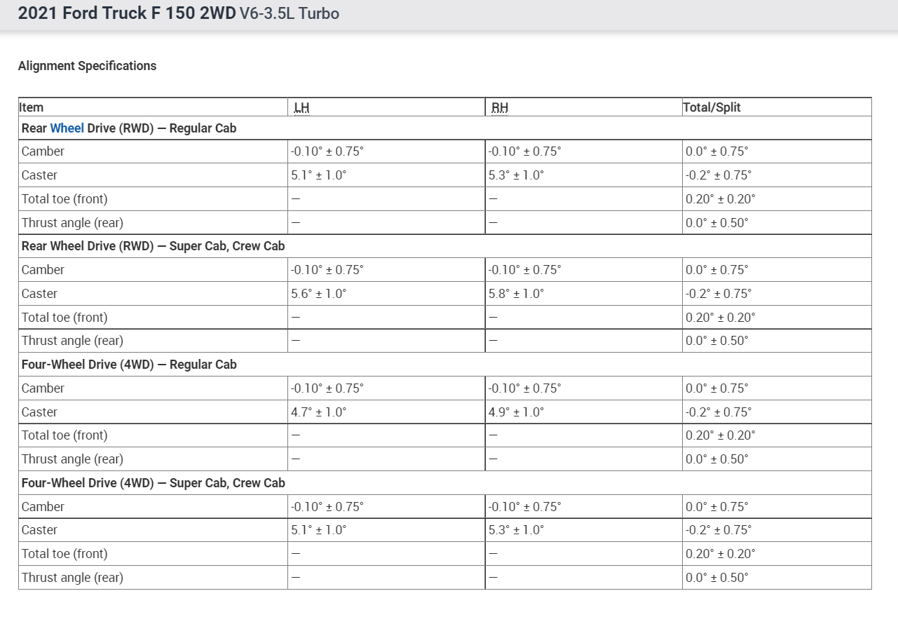

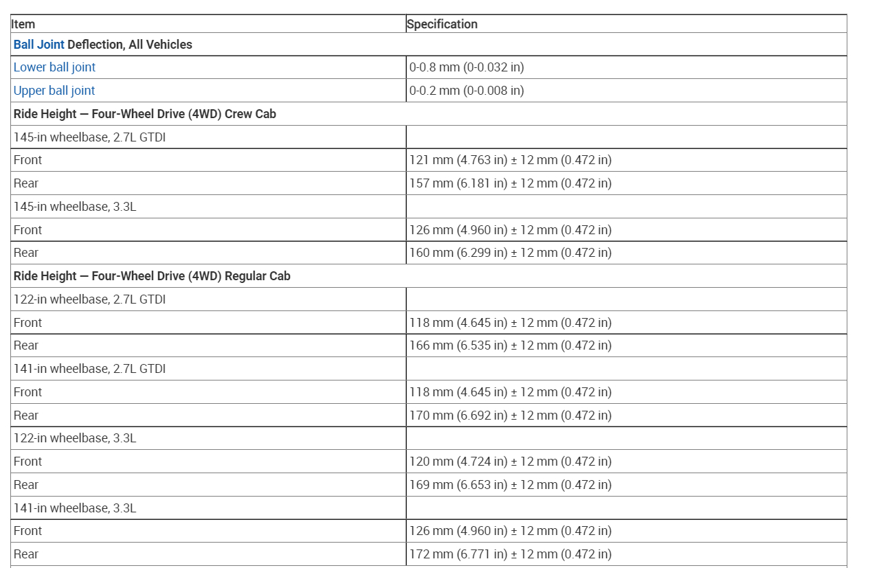

pulls left? alignment specs needed?
Aug 11, 2022 at 12:19 AM
Experienced Mechanic
55,694 POSTS
If the alignment is okay, I would rotate the tires from front to back. The closest I could find are 2021 alignment specs. Check out the diagrams (below). Please let us know if you need anything else to get the problem fixed.
