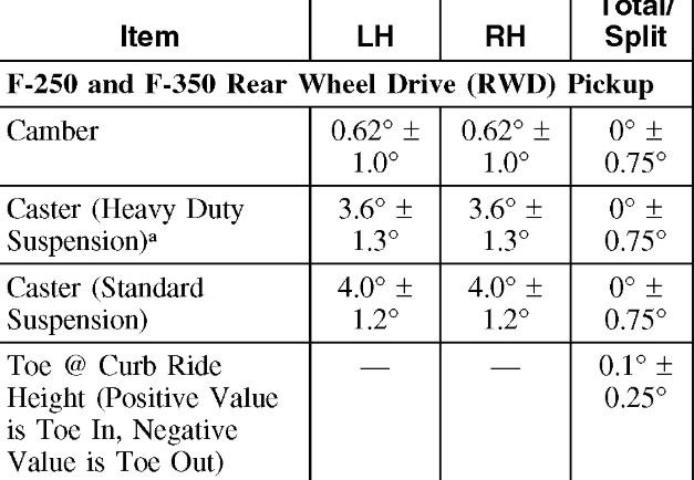

I need to know the alignment specs; camber caster and on a six inch lift.

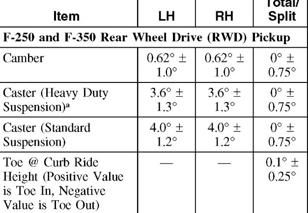

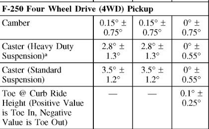

To the best of my knowledge, the lift shouldn't change anything. I attached the specs for this vehicle. Let me know if you have other questions. I also noted that you listed this as a 2wd. I'm not sure if that is correct, so I'm adding specs for both 2 and 4wd.

Fyi it’s diesel. doesn’t make a difference correct my tire size doesn’t affect it.
Apr 18, 2019 at 3:15 PM
  • 110,240 POSTS
Any time you change the vehicle's height, it will need aligned. I punched in for the 6.4L which is the diesel. As far as alignment specs, they remain the same.
Apr 19, 2019 at 11:56 AM

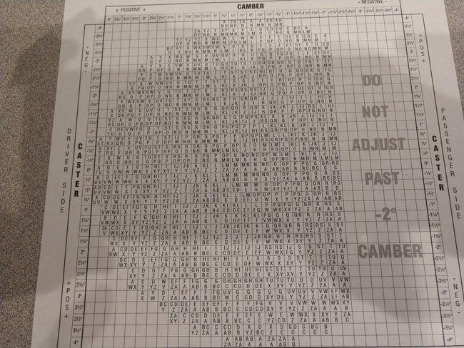

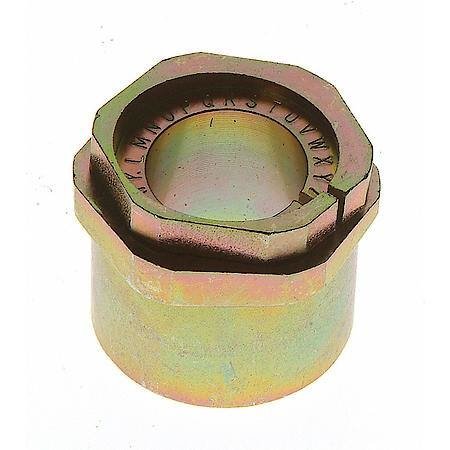

Okay, so I went off the specs you gave me and 8 haces the Moog caster camber part and I’m a little confused on dialing it in or what it should look like.
Apr 20, 2019 at 4:20 AM
VIVIANA OLAGUEZ
  • 6 POSTS
So what should my dial look like?
Apr 20, 2019 at 4:27 AM
VIVIANA OLAGUEZ
  • 6 POSTS
This my chart:
Apr 20, 2019 at 4:56 AM
  • 55,214 POSTS
Can you explain what you mean by dial?
