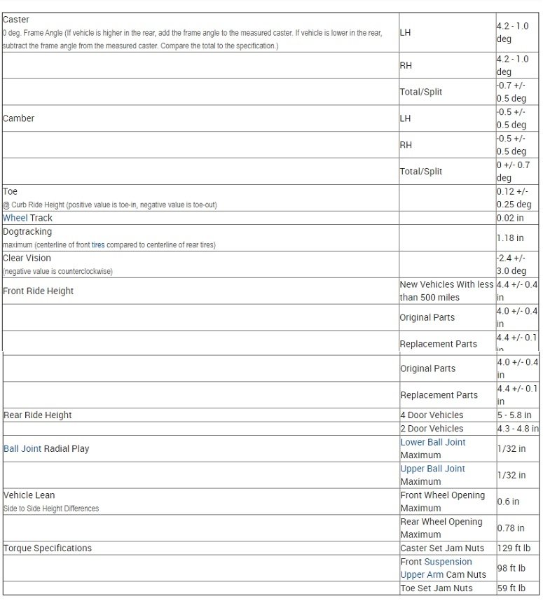

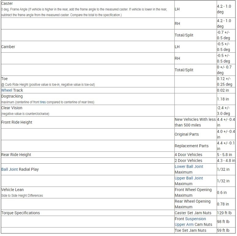

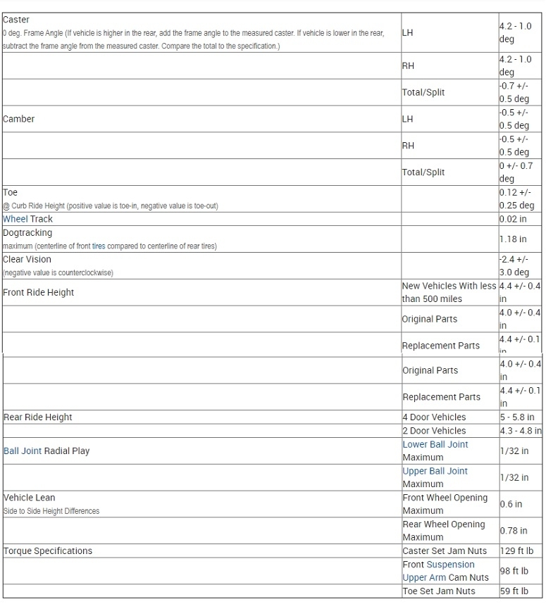

Need alignment specs.

The first set is for the 2wd. Second list is for 4wd. Check out the diagrams (below). Please let us know if you need anything else to get the problem fixed..................................................................
