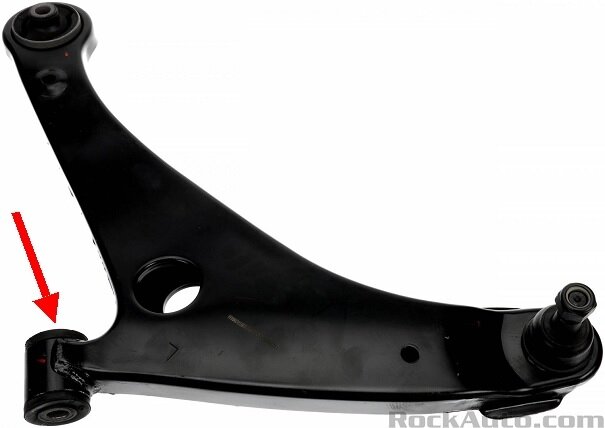

One thing to be aware of when replacing this part is when to tighten the bolt indicated by my red arrow in the photo below. This is the pivot point as the suspension travels up and down. That bolt should not be tightened while the car is jacked up and the suspension is hanging down. Doing so will hold the rubber bushing in that orientation, then, when the car is lowered onto the tires, the control arm will move up to its at-rest position, clamping that bushing in a permanent twist. That will greatly shorten the life of the rubber part. Instead, leave the bolt loose, bounce the car a few times, or drive it around the parking lot or block to settle it, then crawl underneath to tighten the bolt while the car is sitting at normal ride height. If you can't fit under there, it's okay to drive it to the alignment shop with that bolt loose, but tell the specialist about the new control arm and the need to tighten the bolt. Often, when we see a new part with this type of bushing, we will automatically loosen and retighten those bolts, even when you don't say anything. Alignments are always done on a drive-on hoist, so that keeps the cars at normal ride height while providing plenty of working room underneath.
