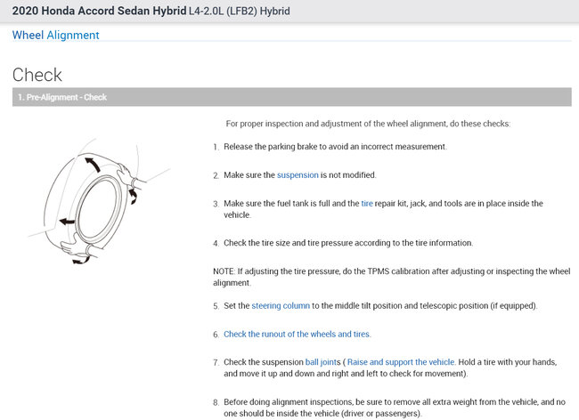

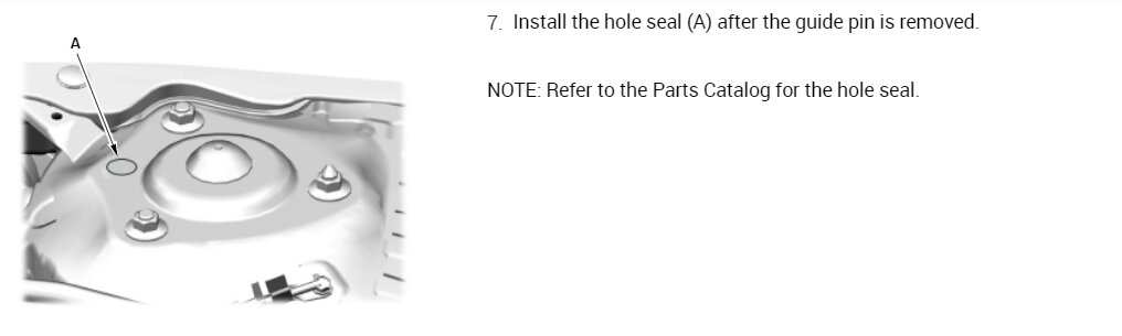

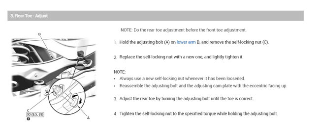

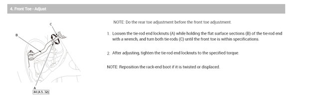

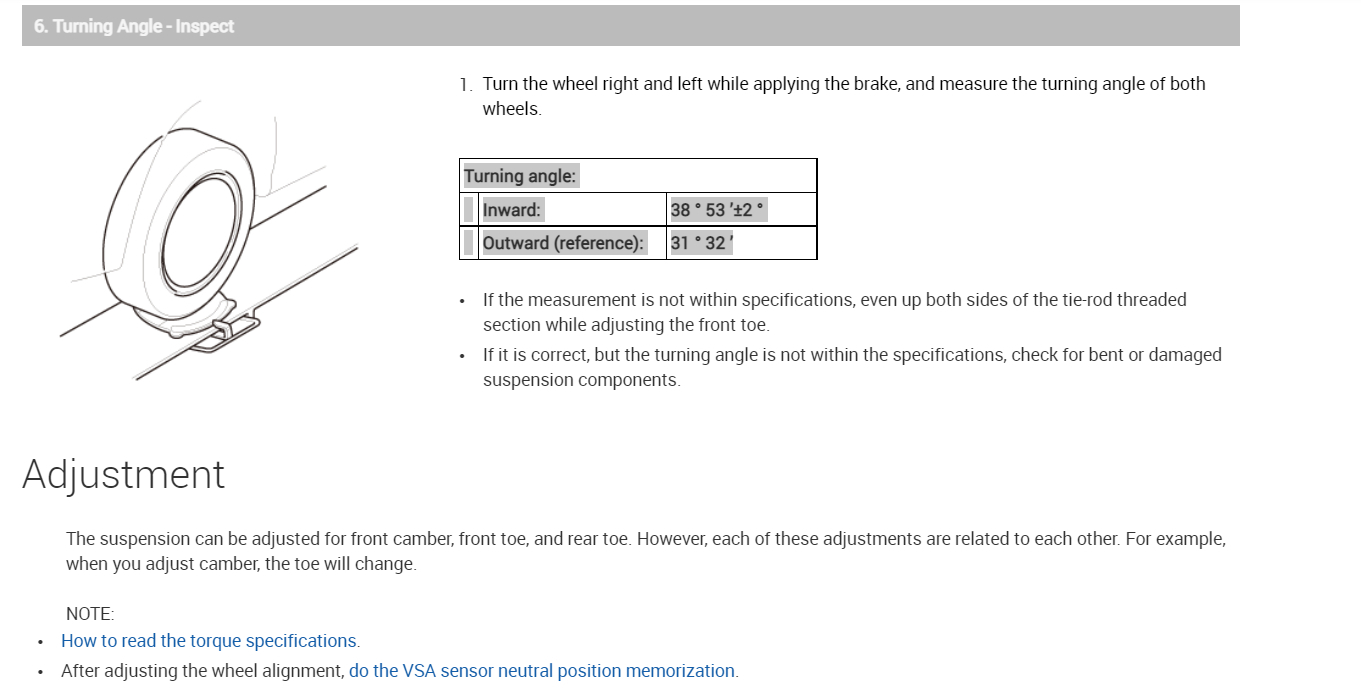

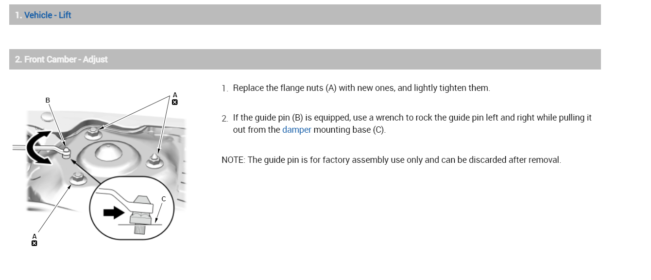

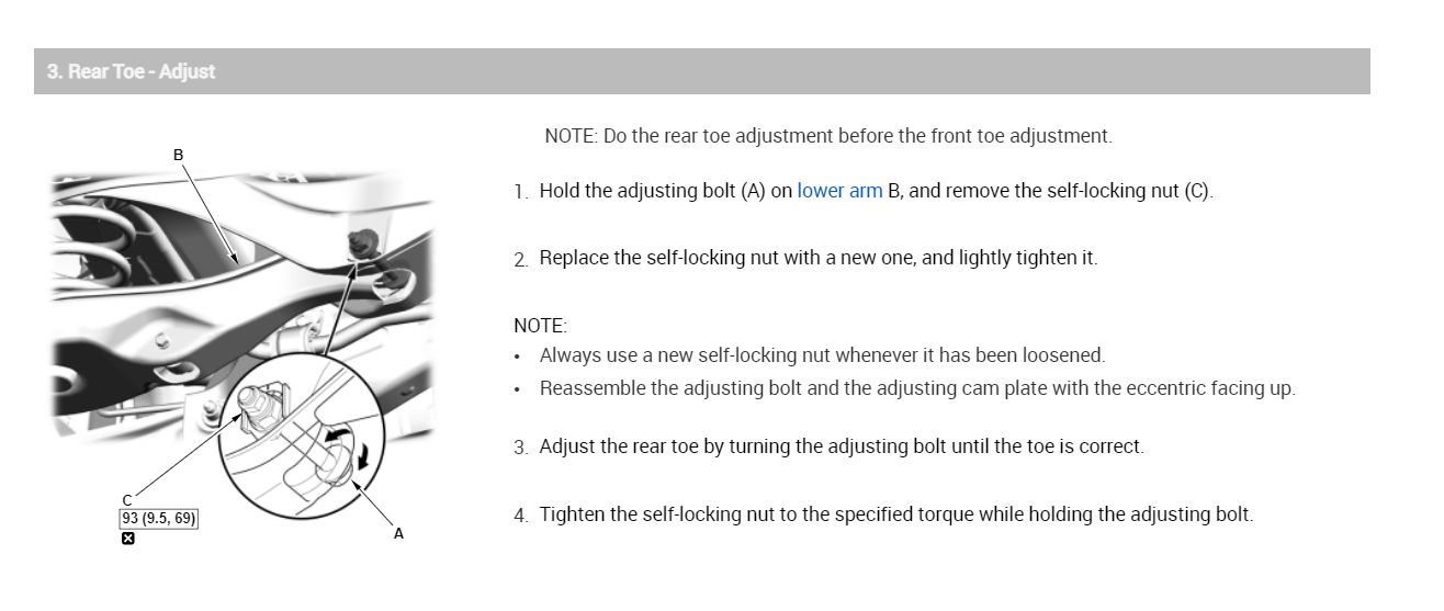

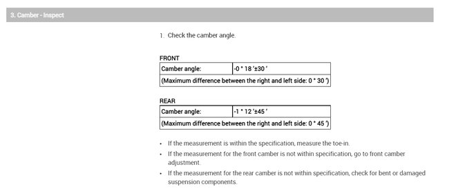

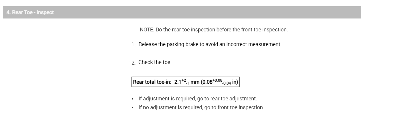

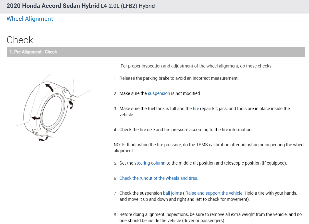

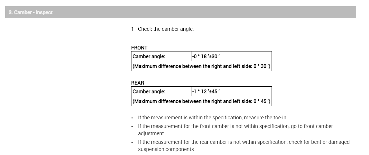

Here are the specs on wheel alignment for the front and rear. I have included the instructions for the wheel alignment as well in the diagrams below.

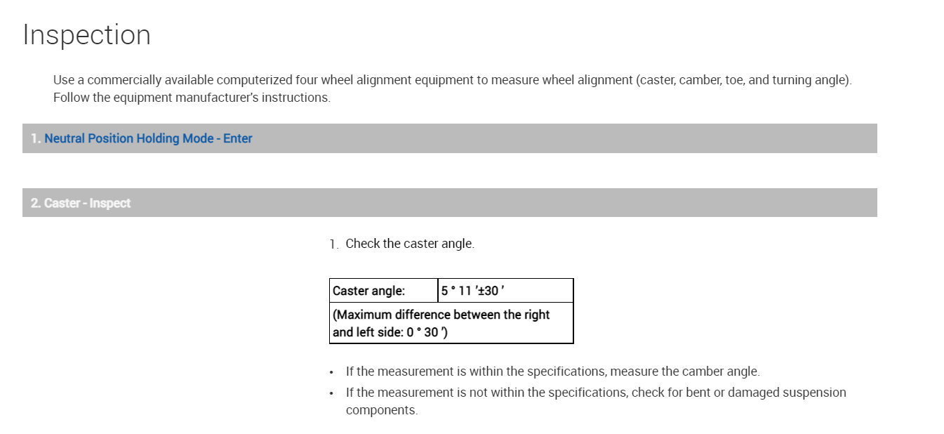

Caster angle: 5 ° 11 ’±30 ’
(Maximum difference between the right and left side: 0 ° 30 ’)
FRONT

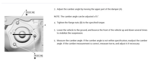

Camber angle:
-0 ° 18 ’±30 ’
REAR
Camber angle:
-1 ° 12 ’±45 ’
(Maximum difference between the right and left side: 0 ° 45 ’)
Rear total toe-in:
2.1+2-1 mm (0.08+0.08-0.04 in)

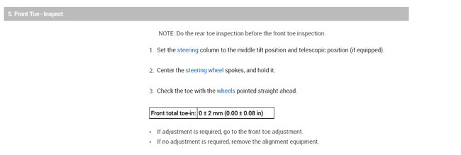

Front total toe-in:
0 ± 2 mm (0.00 ± 0.08 in)

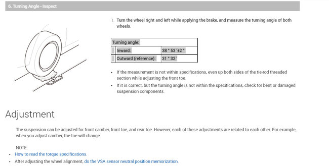

Turning angle:
Inward:
38 ° 53 ’±2 °
Outward (reference):
31 ° 32 ’
Check out the images (below). Please let us know if you need anything else to get the problem fixed.
