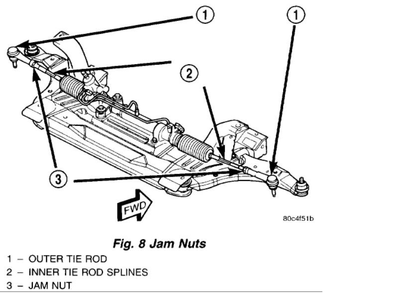

Hello, i actually hit a pothole. I have more detail under the suspension subject. But i have one a lot since the initial pothole incident in regards to changing, checking, and replacing suspension and drive train parts. Now trying to set alignment toe correctly.
Mar 11, 2018 at 8:56 PM
PATENTED_REPAIR_PRO
  • 1,853 POSTS

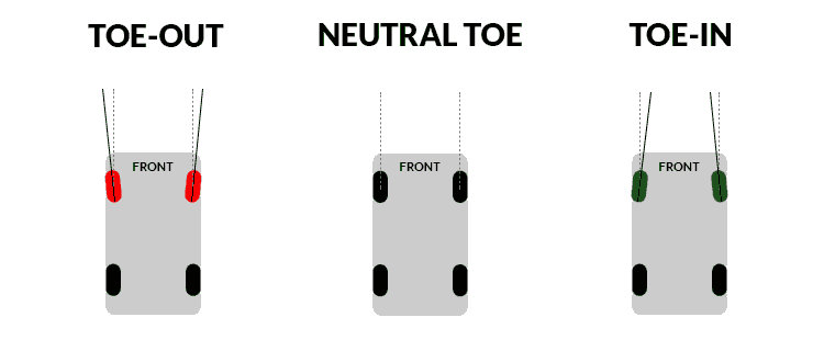

Adjust both front tires until the both point straight forward when the steering wheel is in the center. To see if the wheels are pointed straight forward, look down the edge of the tire to see if the tire is as close as possible to pointing straight forward by comparing to the rear tires which should be pointing straight forward.
As long as you get it close you should be able to drive it.
To adjust the toe on each, loosen the out tie rod jam nut and turn the inner tie rod to adjust toe. Remove the clamp from the boot so the boot does not get messed up.

There is a second way to do that also. If you have two straight edges at least four feet long and put them against the sidewall of the tire, propped up about six to eight inches off the ground on cement blocks or something similar. Now you can measure the distance between the edges both in front and back of the tire. When they measure equal, you are at zero toe. That will not center the wheel but that is not important until you get to the real alignment.

hello my tie rod end is actually on top off knuckle. So the stem from tie rod is on the bottom facing the ground. I cant place a jack on tie rod end bc it would only hit the stem! So im going through the process of trying to tighten my nut onto my new tie rod end but the stem moves with the nut. Spinning.

You should not have to worry about camber and caster in order to just get the steering wheel centered in order to get it to a shop to get aligned, just get the toe close.
