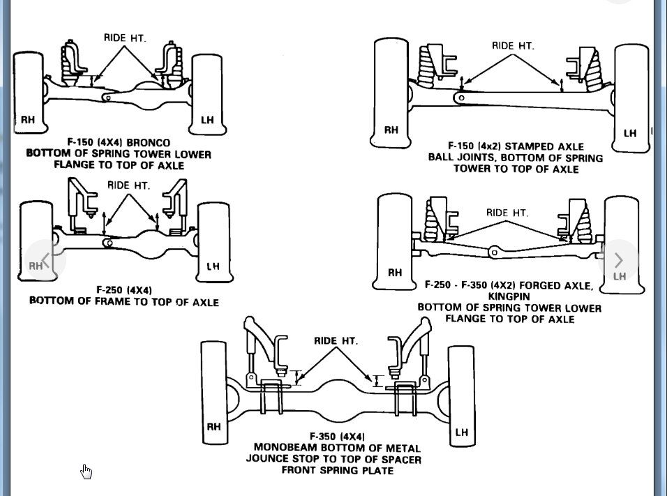

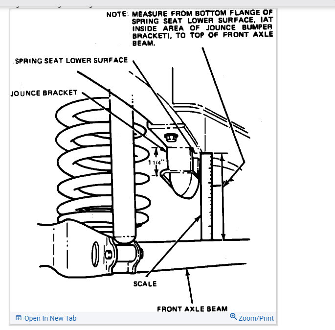

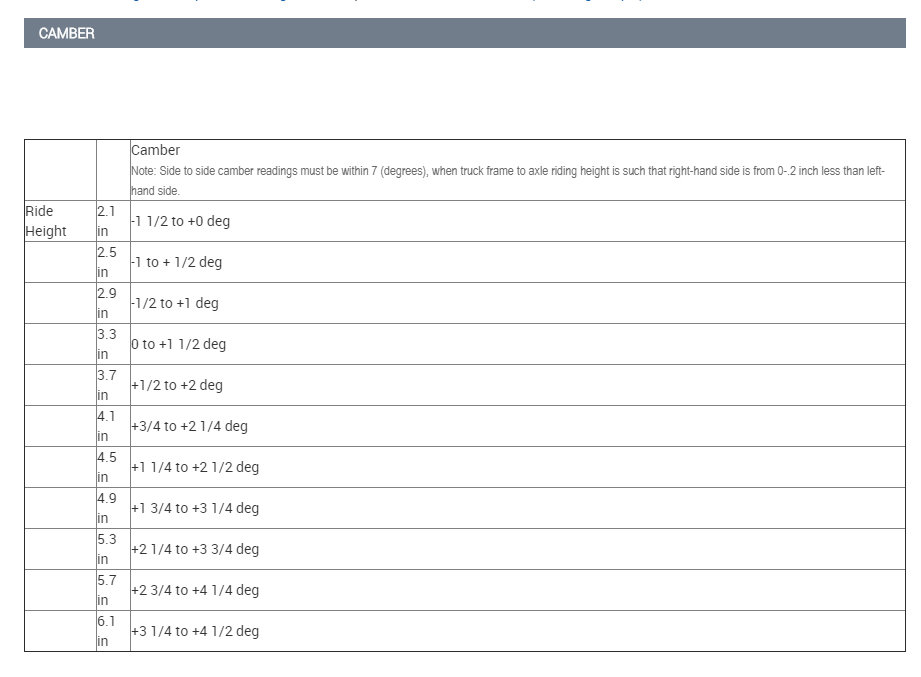

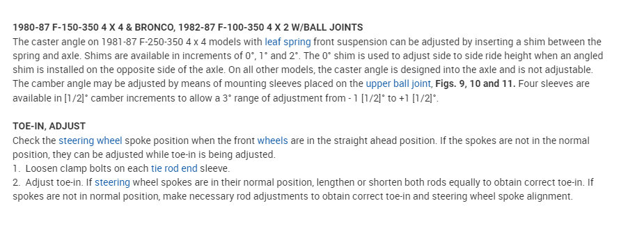

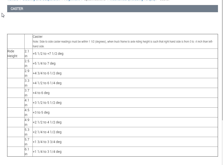

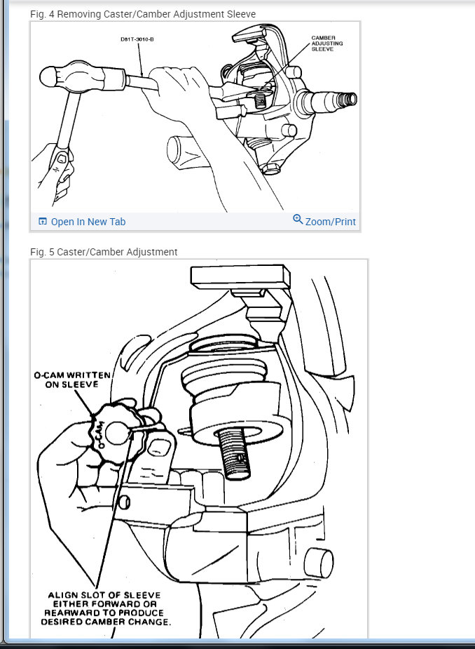

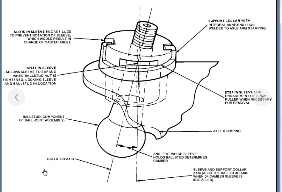

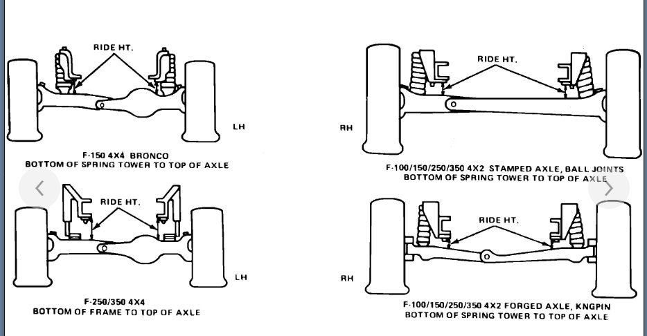

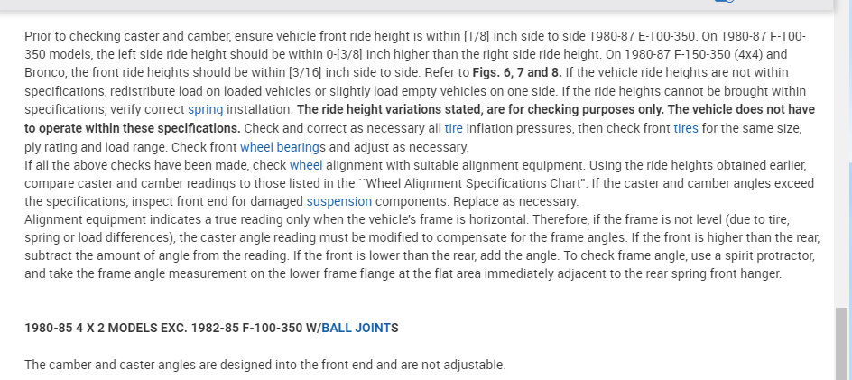

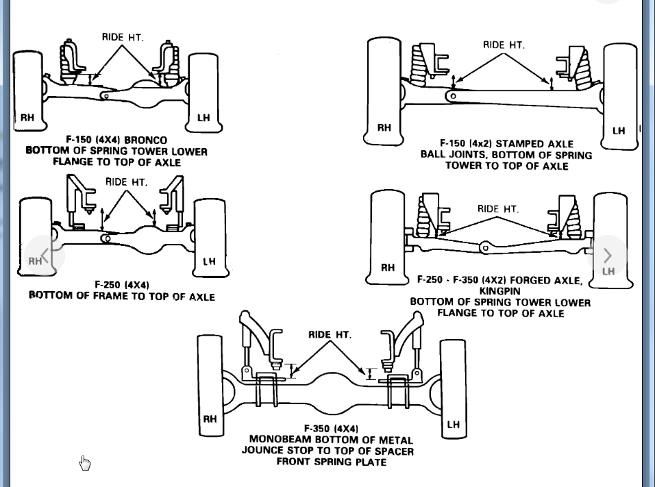

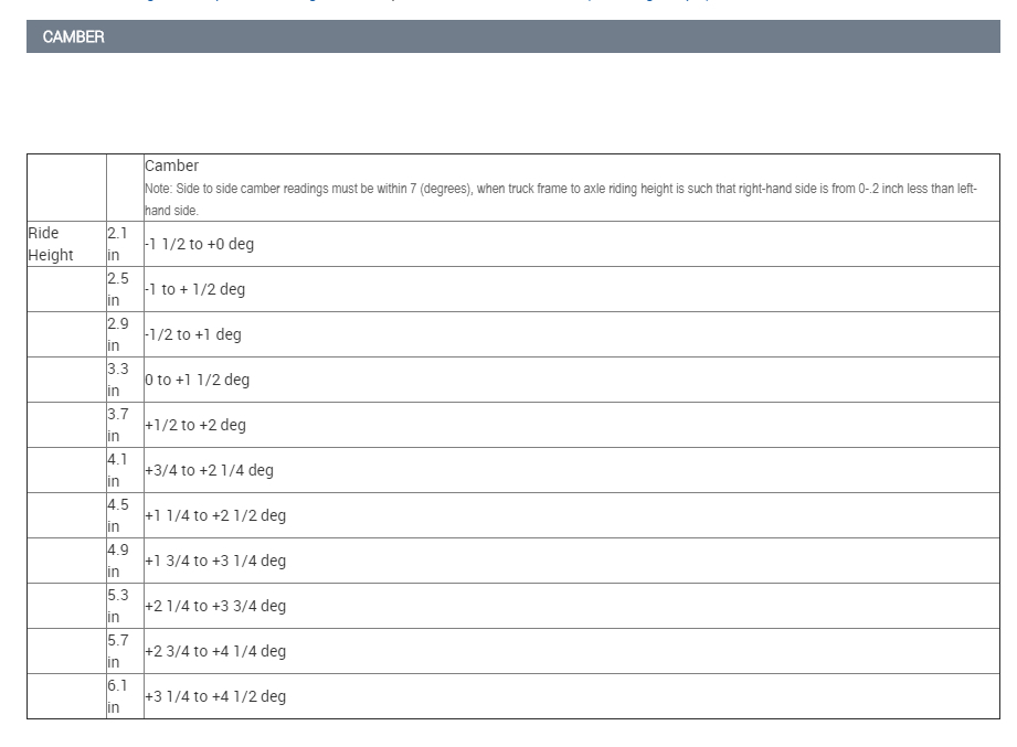

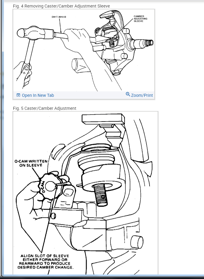

Can someone give the alignment specs for the truck listed above?
Mar 6, 2020 at 6:09 PM
  • CAR REPAIR CONTRIBUTOR
I attached the specs for camber and caster. Then the entire process. Let us know if you need more info. Thanks
Mar 6, 2020 at 6:18 PM
BRADLEY KENNEDY
Thank you!! Was exactly what I've been looking for.
