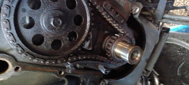

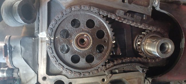

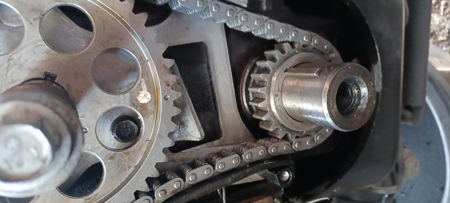

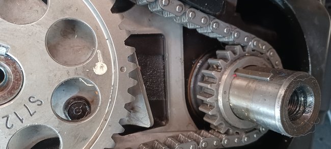

I noticed after replacing the timing chain, [marked an at TDC with dots in center] and getting the new chain and sprockets back in the exact position on the crank and cam guide keys, that the dot on the new top sprocket is a bit off to the right on new one. Looks like one tooth over. is this typical and do i need to turn the top one to align?
I didn't recall turning cam as putting new sprocket in.
Any info is appreciated.
There's the before/after on pic.

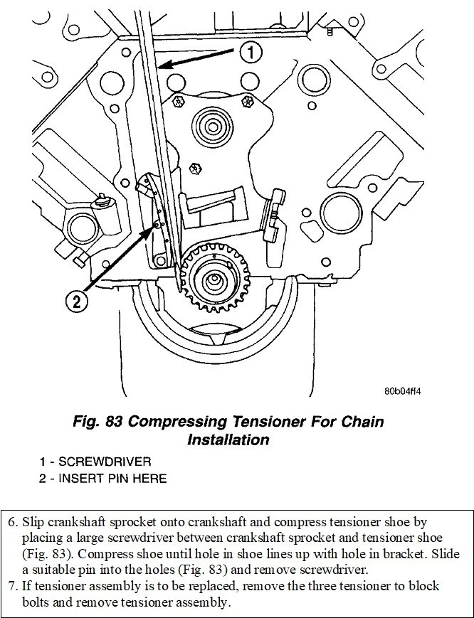

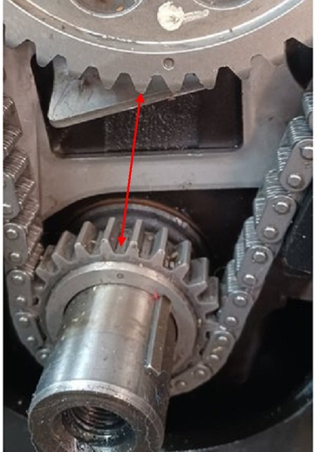

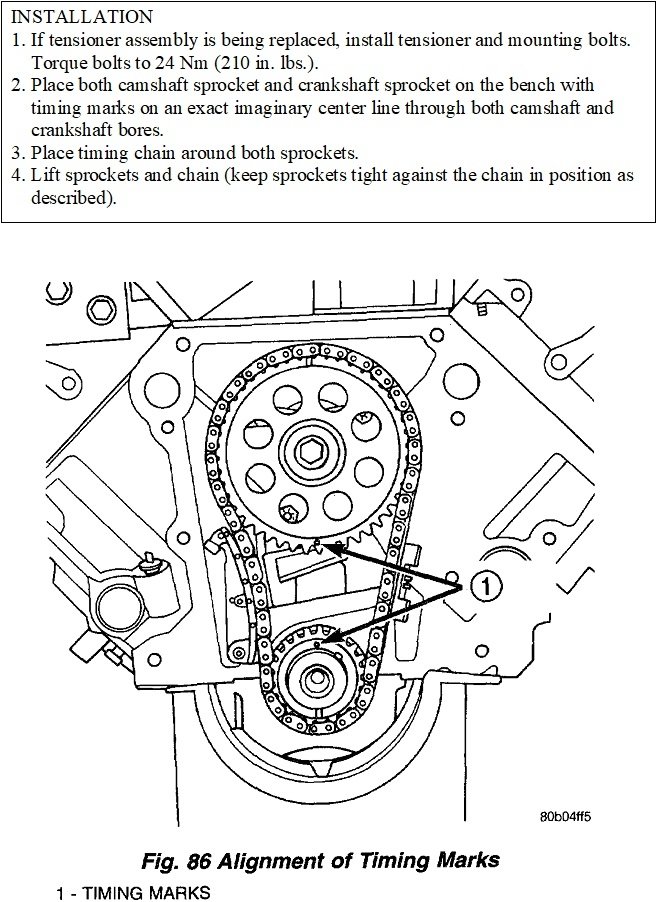

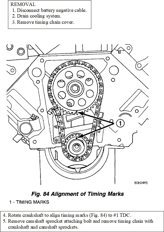

Dandy observation. This is your third photo. It's a little hard to see being at an angle, but it looks like the cam sprocket is off by one tooth. There's two things that can happen here. The first has to do with the spring-loaded tensioner. I posted the instructions, mostly to show how unclear they are. What they should have explained better was to set the chain tight on the right side, as viewed from the drawing, and with slack on the left side. Rotate the crankshaft two revolutions in the normal direction, (clockwise as viewed from in front), then check the timing marks. They should be lined up when all the slack in the chain is on the left. If that isn't done, and there's some slack on the right side, the camshaft is going to rotate counter-clockwise when the tensioner is released and takes up the slack. That will put the cam sprocket one tooth late, as it appears in your photo. This applies to all timing chains and belts that use an adjustable tensioner.
The second cause refers to your comment about not turning the camshaft. In almost all engines, when the belt or chain is removed, the pressure of the valve springs on open valves will push on the camshaft lobes and turn the camshaft, often without you noticing. When it comes to sticking the two sprockets on, both have to line up with their keys. The crankshaft didn't move, but the camshaft most likely did. Many people rotate the cam sprocket until it slides onto that shaft and keyway, then they use that orientation to install the chain. Some people do recognize the camshaft has to be rotated back a tooth. Most are confused as to why they had to do that.
You'll need to retract and pin the tensioner again, then turn the cam sprocket clockwise one tooth. That will put the camshaft in proper time, and it will put the chain's slack on the right side. Now slide the two sprockets forward just enough until you can drop the cam sprocket out of the chain, then rotate that sprocket clockwise one tooth on the chain. You'll need to rotate that sprocket back counterclockwise one tooth to slide it back onto the camshaft. The slack will allow you to do that by moving back to the left side.

Thanks. yes, i did realign the marks and got that chain back on fast with that new technique..
Balancer is at TDC mark an dots are aligned..
I torqued it to 135 ftlb..
