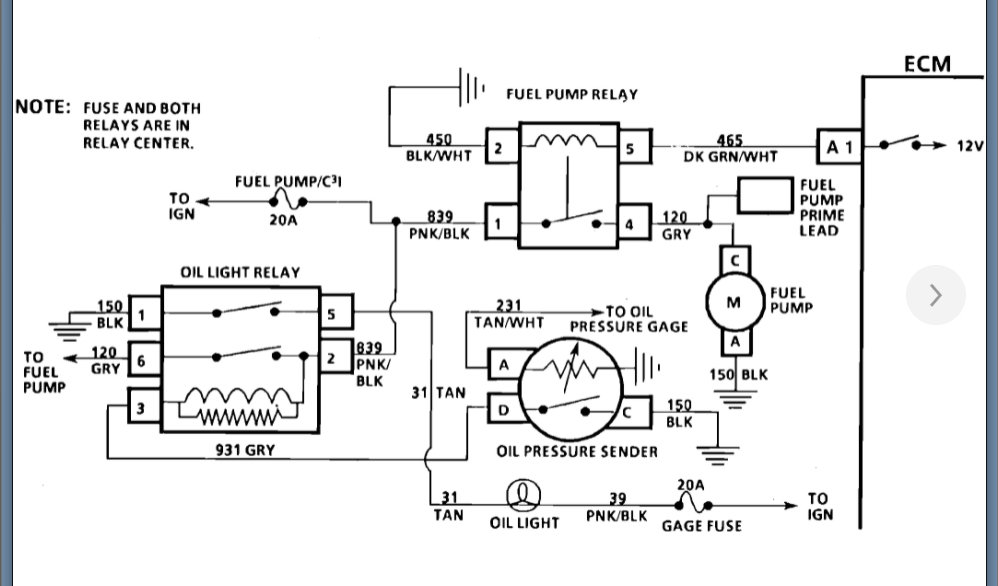

Well, I hit it with starting fluid. "again". And it fired. It didn't the first time. So, I have concluded that it is the fuel system. Could it be the fuse? Or is it the pump?
Apr 8, 2022 at 12:40 PM
So, if this is a fuel related issue then we need to jump the relay and see if the pump comes on. Also, we can go to the pump and check for power when the key is in the on position.
Here is a guide that will help with this:
If you have power but the pump is not coming on or you don't have pressure, then you need to replace the pump.
If the pump is not coming on, then we need to back track through the system to find out where we are losing the power.
I am attaching the wiring diagram below which will help with figuring this out.
Let me know what questions you have with this.
