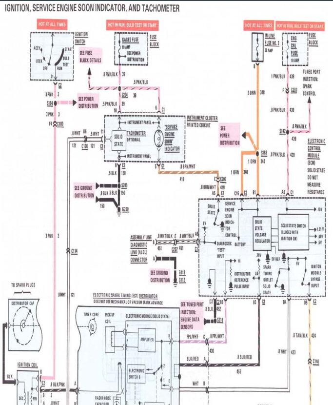

When jumpering pins one and 2 or a and B. Have check for voltage. And for a good ground, are those 2 pins? Have also disconnected the ECM And Probe pen A. To ground and check Engine light does not come on.
Sep 3, 2023 at 3:21 PM
  • 55,055 POSTS

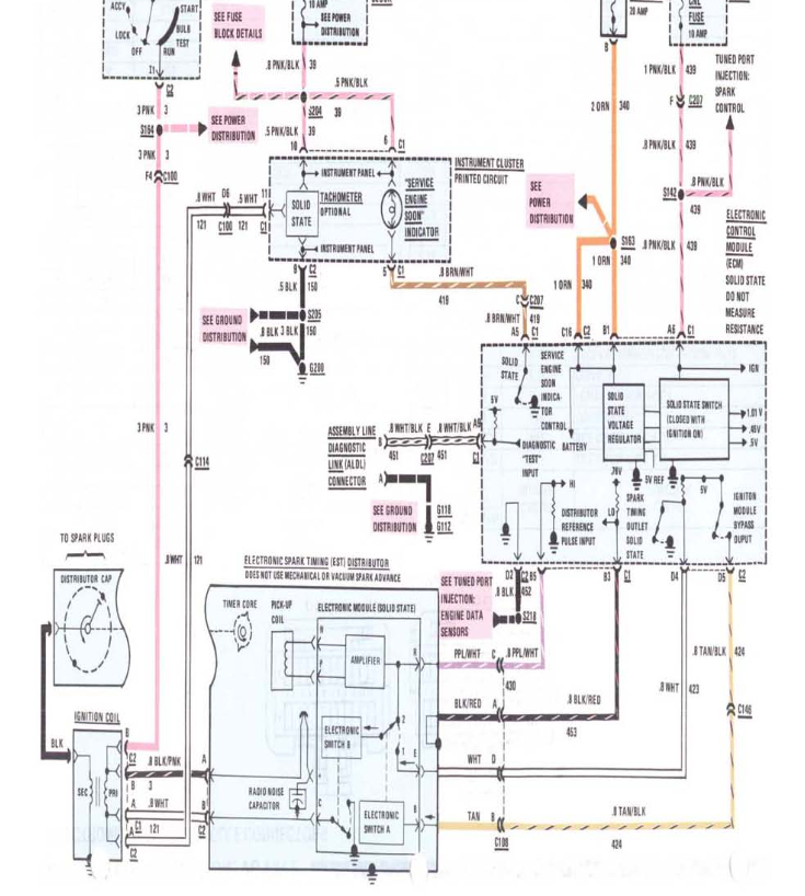

Here is a guide to help you see which terminals to jump for the codes and I have included wiring diagrams for the check engine light, can you also check the bulb to make sure it is good please?
https://www.2carpros.com/articles/buick-cadillac-chevy-gmc-oldsmobile-pontiac-gm-1983-1995-obd1-code-definitions-and-retrieval-method
With the key on you should have power to the pink/black wire at the rear of the cluster Check out the images (below). Please let us know how it goes.
