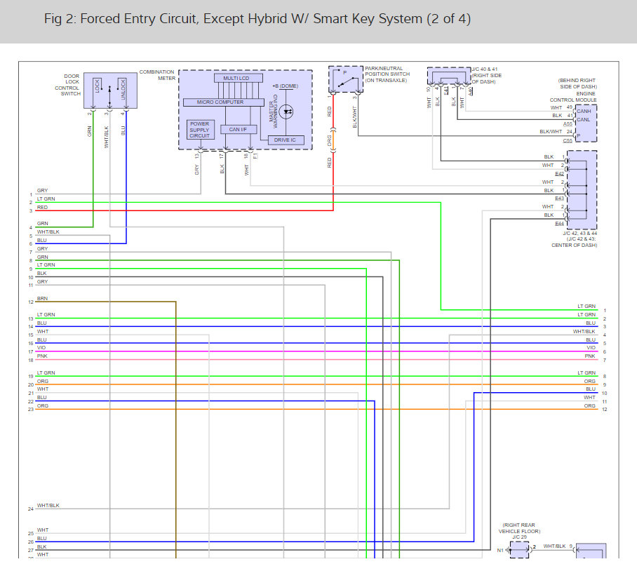

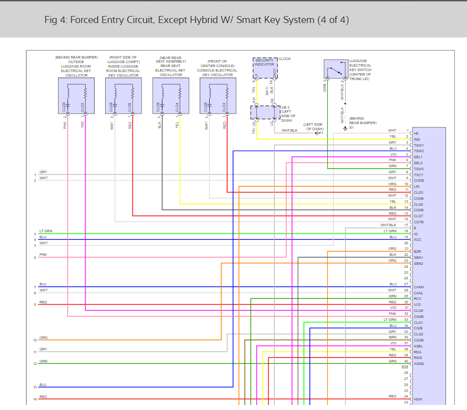

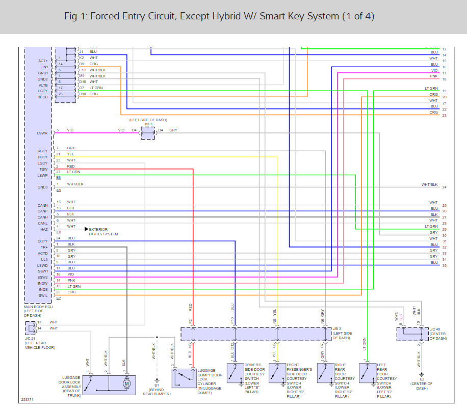

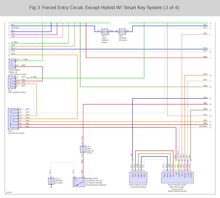

The alarm system is going off randomly with the car it seems to happen at random times, I can hear it from my apartment.
How do I disable or disconnect the alarm system so that it does not go off anymore?
Sep 5, 2018 at 4:24 AM
  • 55,433 POSTS
Try this guide
https://www.2carpros.com/articles/how-to-reset-a-security-system

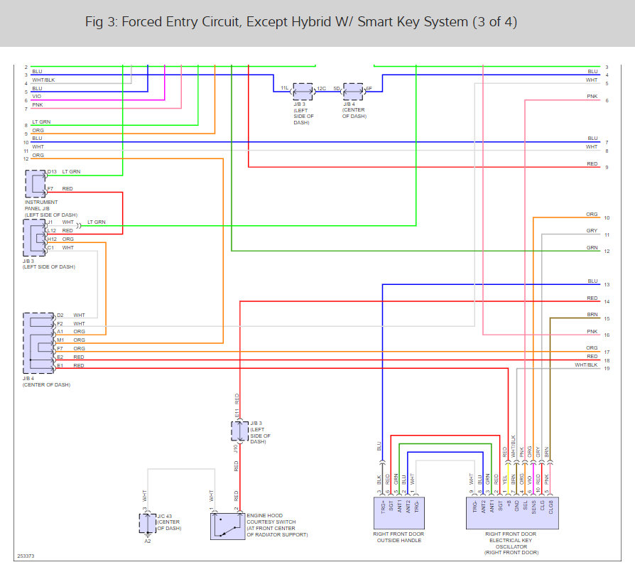

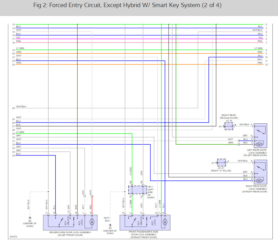

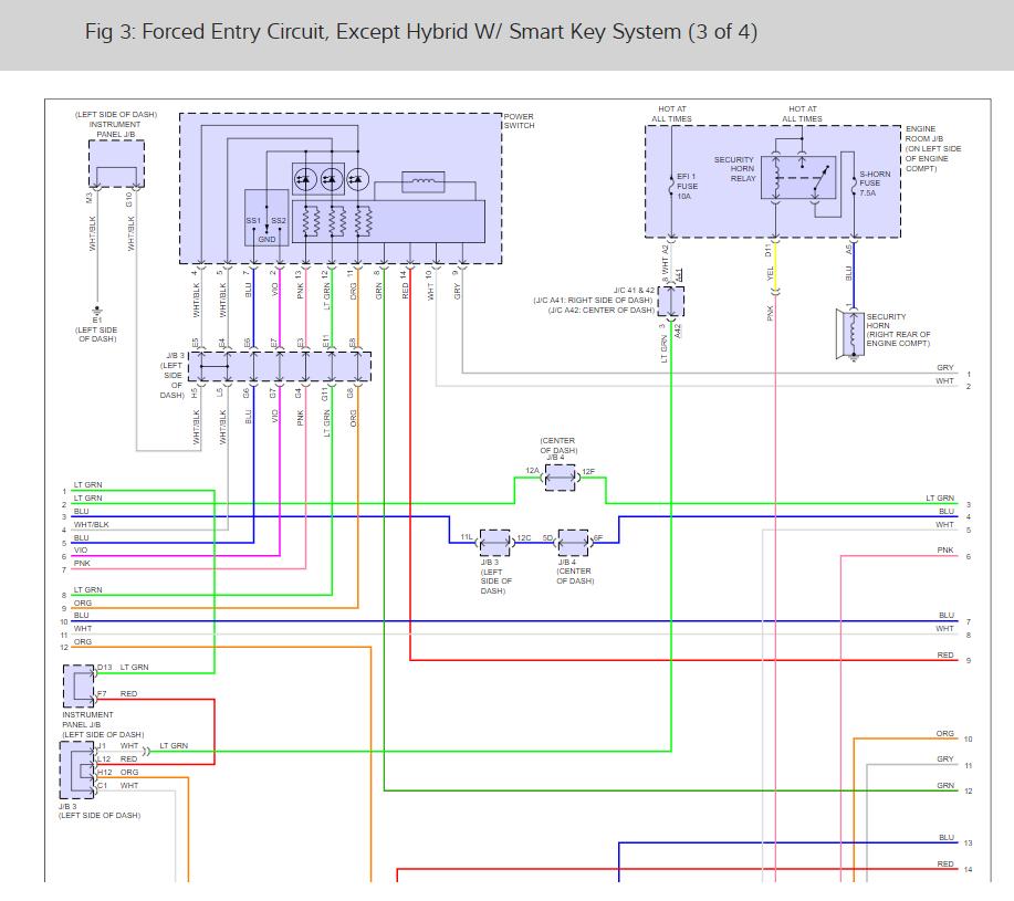

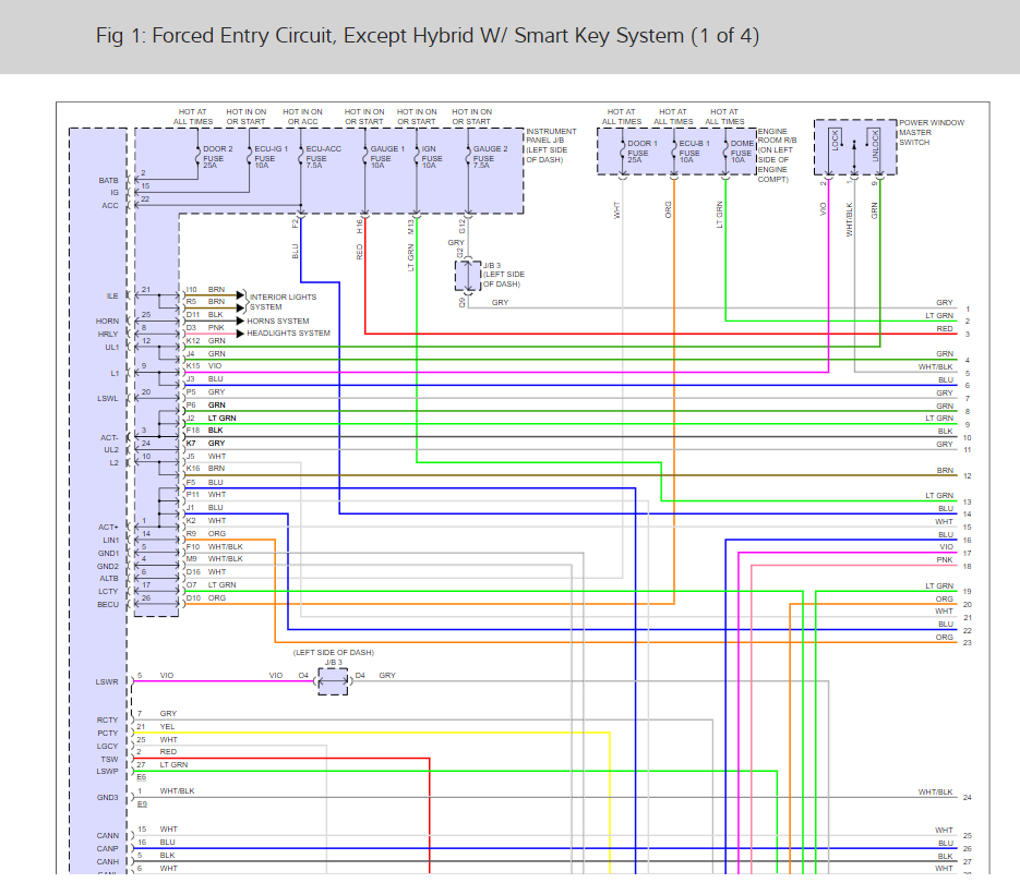

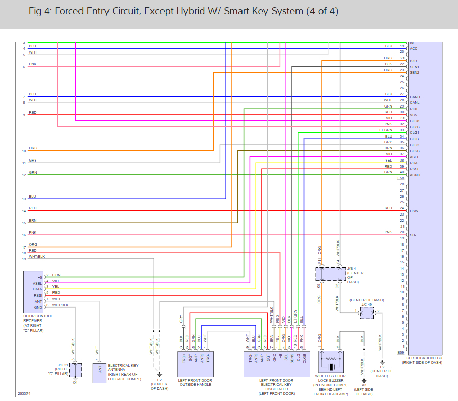

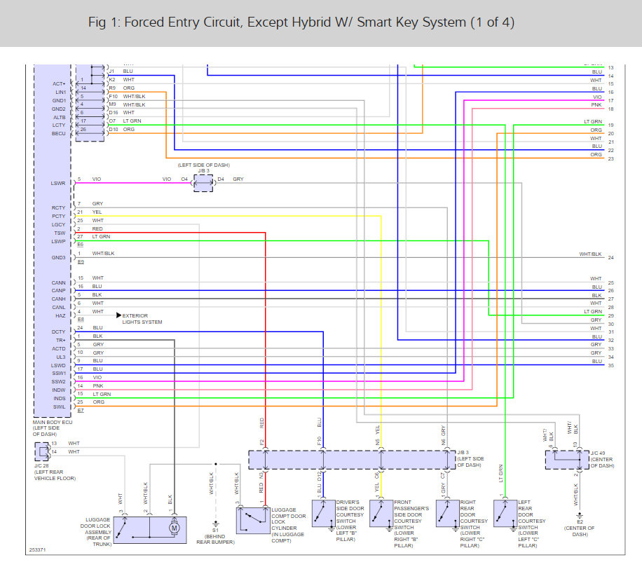

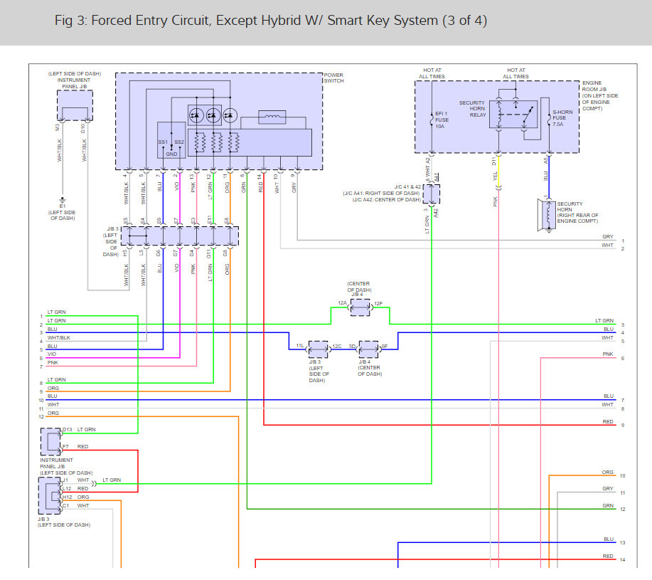

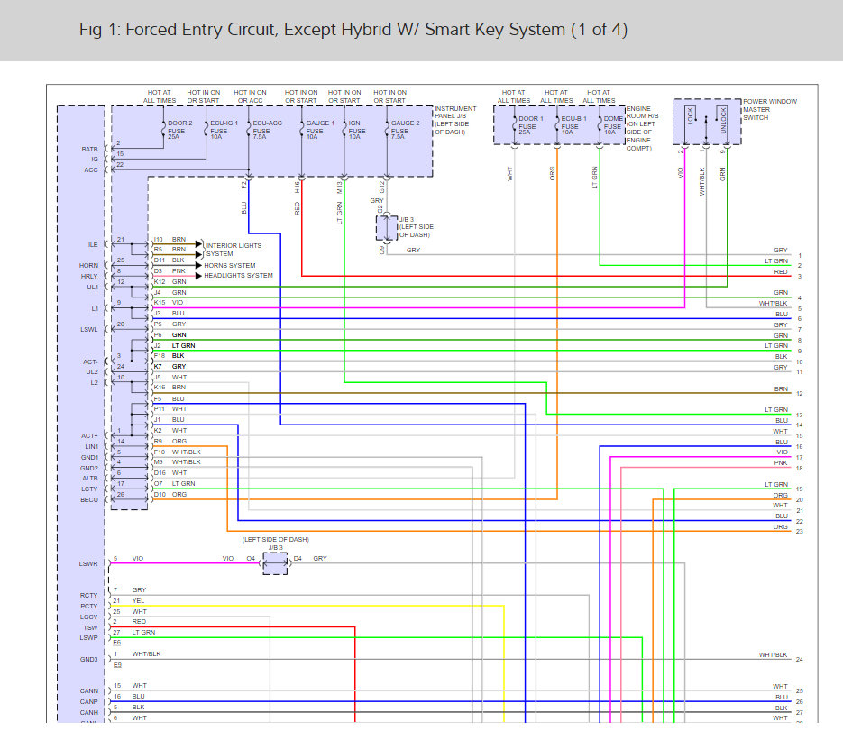

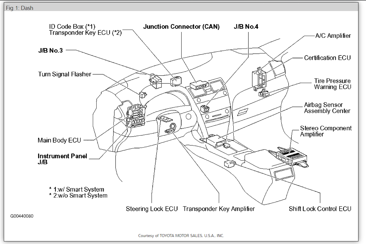

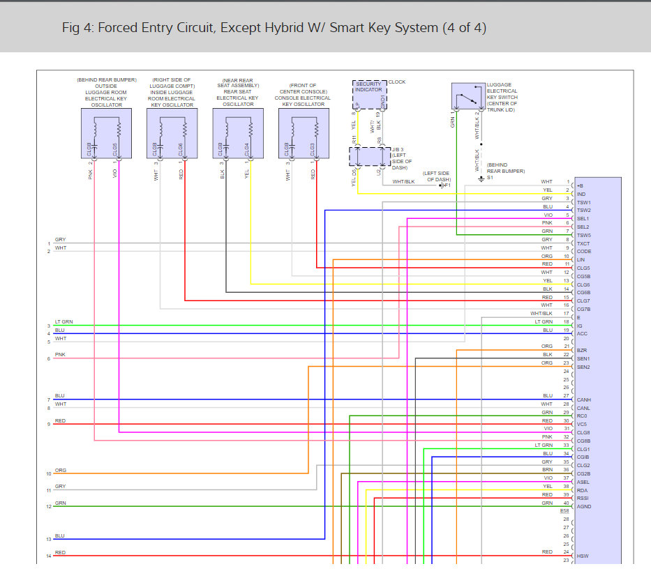

If not it sounds like the certification ECU maybe going out but lets disconnect the battery and remove the certification ECU to check for corrosion also this can sometimes fix bad connections. I have also seen where the drivers side front door latch wears and it causes the micro switch inside to not work right causing the alarm to do off. With the car locked and the alarm on try pulling on each one of the doors (shut) to see if you can get the alarm to go off this will tell you which door latch to replace. Here are the wiring diagrams for the security system so you can see how it works and the location of the certification ECU. Check out the diagrams (below). Please let us know what happens.

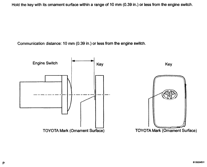

It sounds like you have a bad connection at the battery even if the security was on it would not cut power to the radio. Please confirm the battery terminal connections here is a guide.
If they check out here is what the book says to reset the alarm system.
REGISTRATION
1. DESCRIPTION OF CODE REGISTRATION
HINT
ID codes are the same as recognition codes for the wireless transmitter and the engine
immobilizer function. Registering an ID code enables the smart access system with pushbutton
start, the wireless door lock control function ant) the engine immobilizer function
to be operated.
Code registration is needed when the certification ECU, ID code box, steering lock ECU
or key is replaced with a new one.
PROCEDURES
The vehicle with the smart access system with push-button start system does not have a key slot. Therefore, hold the key close to the engine switch to register the key, as shown in the illustration below.
Fig. 3: Identifying Engine Switch Register Key
