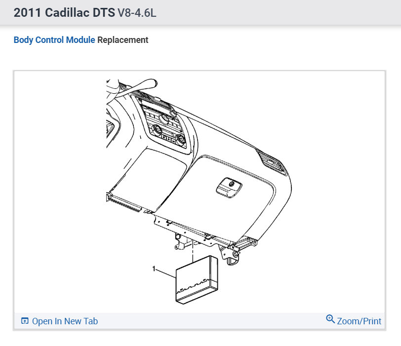

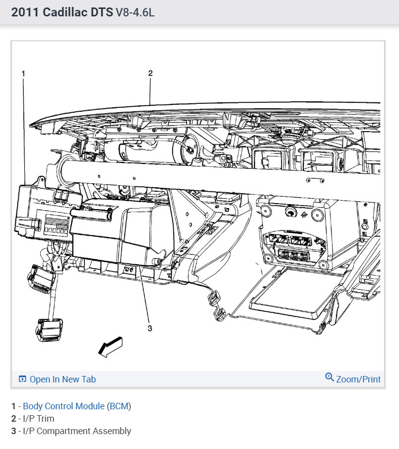

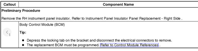

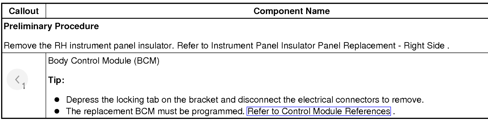

This is common when the BCM of the car goes out. To be sure we can do a CAN scan to confirm the issue. here is a video to help us with the BCM replacement instructions in the diagrams below in case it does need to be replaced:
https://youtu.be/InIlnsjOVFA

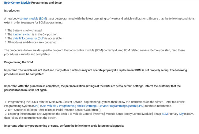

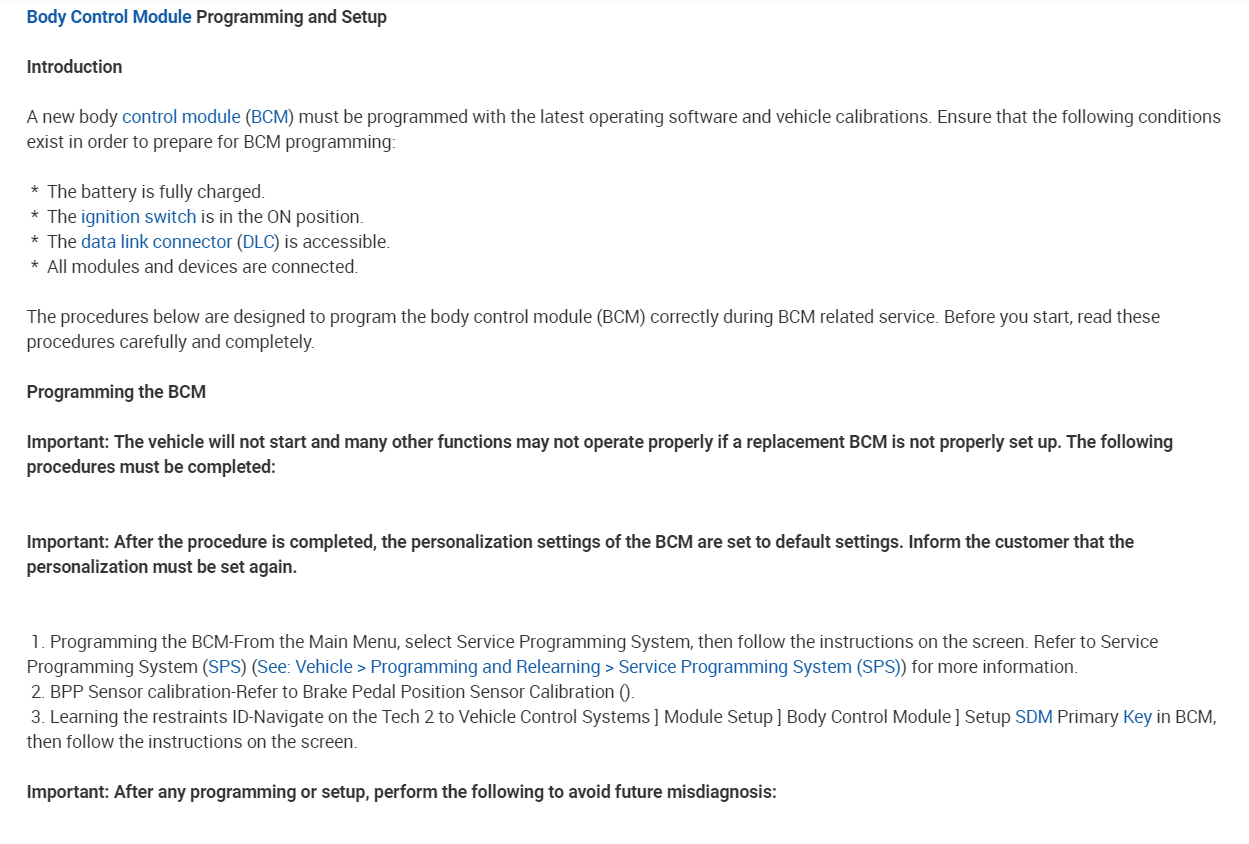

Body Control Module Programming and Setup
Introduction
A new body control module (BCM) must be programmed with the latest operating software and vehicle calibrations. Ensure that the following conditions exist in order to prepare for BCM programming:
* The battery is fully charged.
* The ignition switch is in the ON position.
* The data link connector (DLC) is accessible.
* All modules and devices are connected.
The procedures below are designed to program the body control module (BCM) correctly during BCM related service. Before you start, read these procedures carefully and completely.
Programming the BCM
Important: The vehicle will not start and many other functions may not operate properly if a replacement BCM is not properly set up. The following procedures must be completed:
Important: After the procedure is completed, the personalization settings of the BCM are set to default settings. Inform the customer that the personalization must be set again.

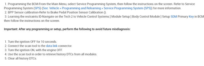

1. Programming the BCM-From the Main Menu, select Service Programming System, then follow the instructions on the screen. Refer to Service Programming System (SPS) (See: Vehicle > Programming and Relearning > Service Programming System (SPS)) for more information.
2. BPP Sensor calibration-Refer to Brake Pedal Position Sensor Calibration ().
3. Learning the restraints ID-Navigate on the Tech 2 to Vehicle Control Systems ] Module Setup ] Body Control Module ] Setup SDM Primary Key in BCM, then follow the instructions on the screen.
Important: After any programming or setup, perform the following to avoid future misdiagnosis:
1. Turn the ignition OFF for 10 seconds.
2. Connect the scan tool to the data link connector.
3. Turn the ignition ON, with the engine OFF.
4. Use the scan tool in order to retrieve history DTCs from all modules.
5. Clear all history DTCs.

Tell Ken it is not the dash lights that are staying on it is the "back lighting" in the knobs, steering wheel and clock as well as the push buttons on dash, and your instruction page is obscured by the sponsored ads and is not completely readable.
