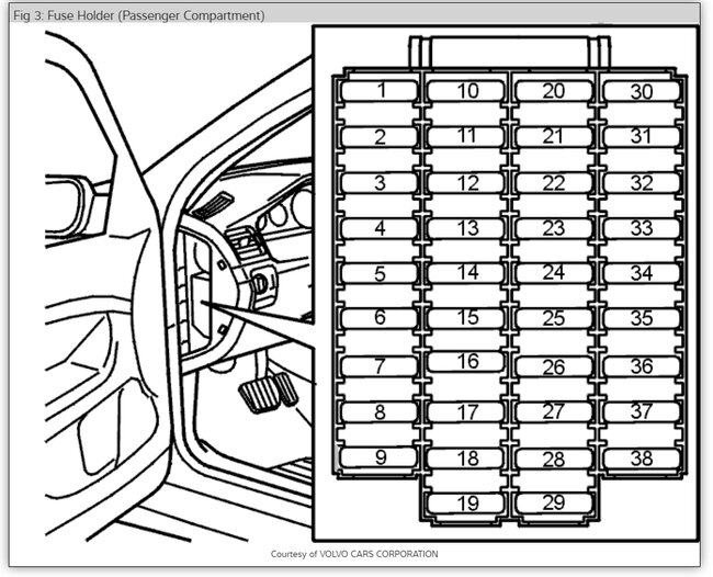

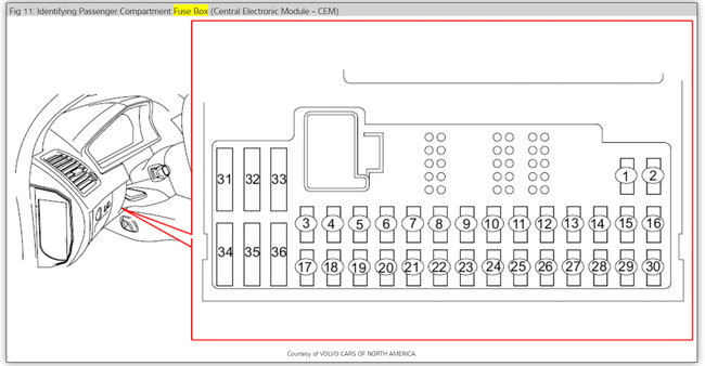

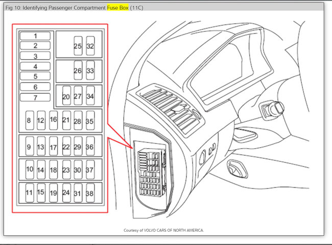

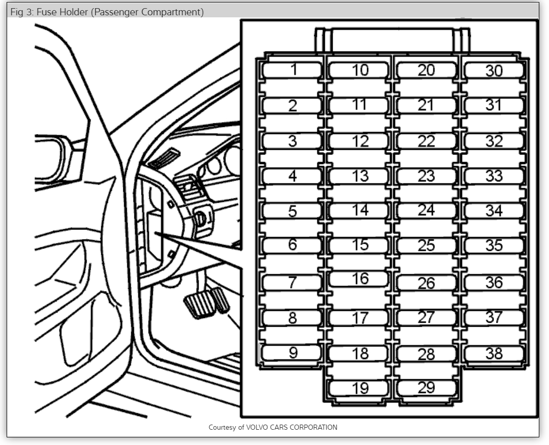

the vehicle is running well just the alarm siren work arm and sound when pushing the panic button, a message appears at the messages window saying the alarm system requires service. I can make sure where the fuse alarm is as I checked the side panel inside the vehicle, but I have just 13 fuses there some fuse diagrams show fuse # 28 also under the dashboard I disconnect the fuse counting from the left in that raw I need please some help and get the right fuses diagram for my vehicle listed above is a T6 2.9 turbo six cylinders.

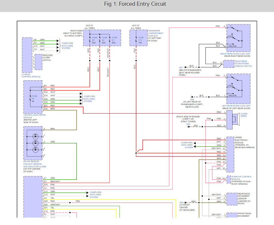

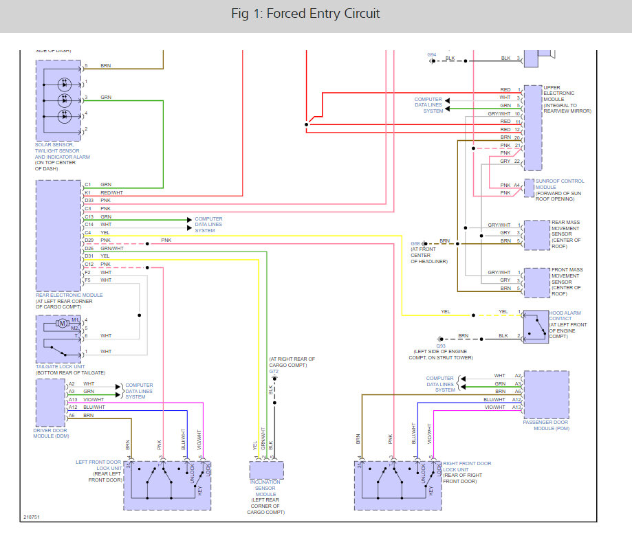

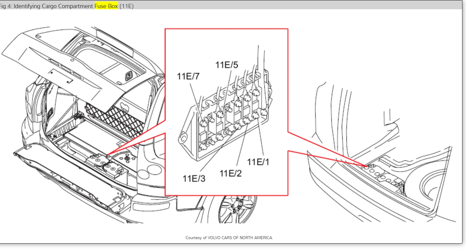

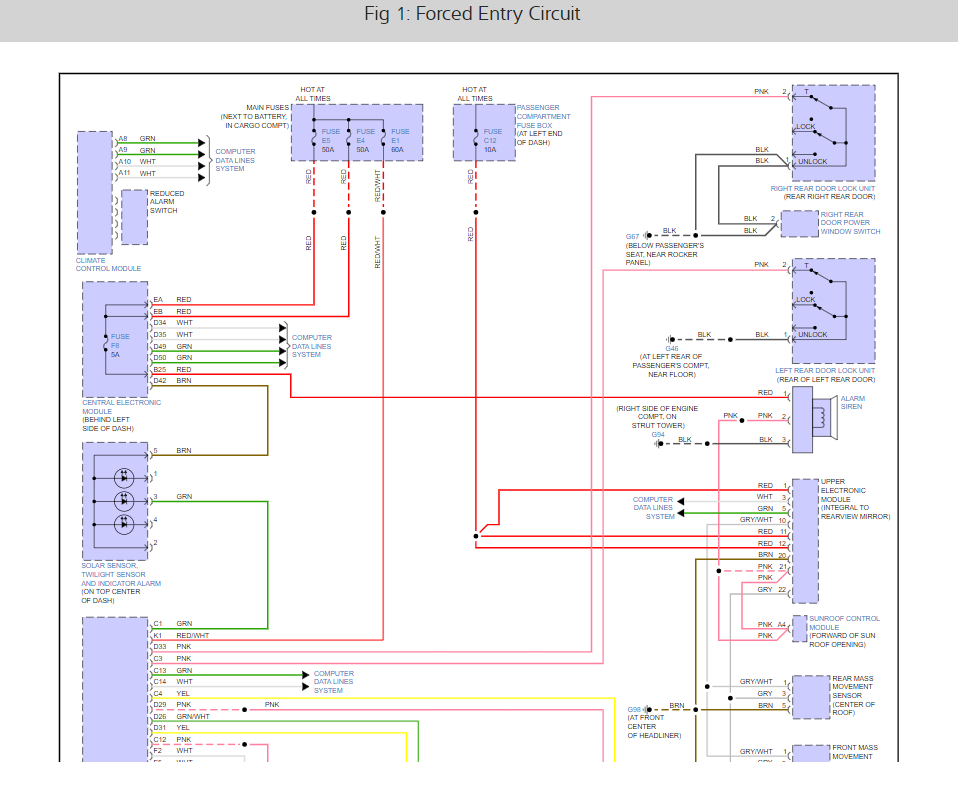

There are 5 fuses that run the system which are featured in the alarm system wiring diagrams below. here is a guide to help see how the system works and a guide to help you test the fuses:
Check out the images (below). Please let us know if you need anything else to get the problem fixed.
