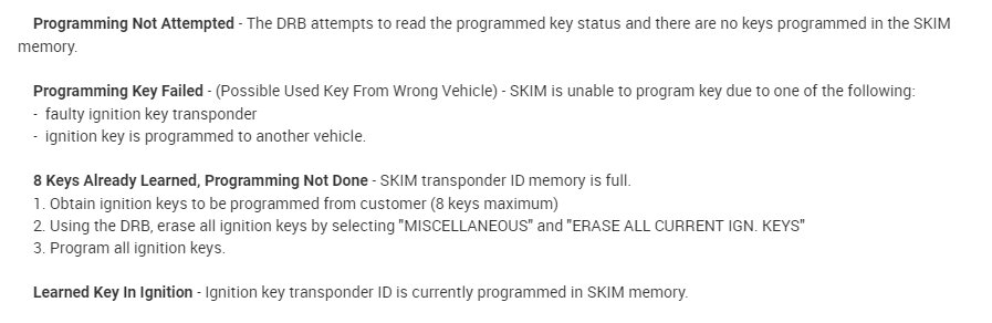

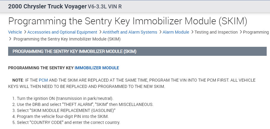

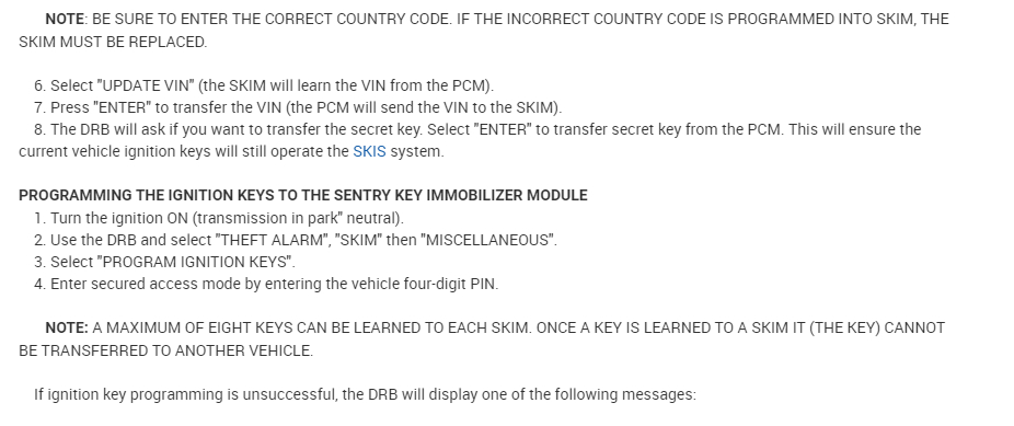

If you have a spare key, see if that makes a difference. If there is no change, I have a feeling the immobilizer module will need to be reprogrammed.
I attached the directions below for reprogramming. It does require a factory scan tool or one that can communicate with the modules.
Take a look through the directions and let me know if you have questions.

"Enter secured access mode by entering vehicle four digit pin" where can I get this pin because I have tried it before but the scan tool was unable to display the pin?
Nov 27, 2022 at 2:20 PM
  • 110,244 POSTS
That will need to come from a dealership. To get it, you will need proof of ownership.
The four-digit skim code is required when you get into the secured access mode. That isn't something I can get.

What if I rewrite the VIN on the immobilizer or PCM, can't it reset it?
Dec 2, 2022 at 5:14 AM
  • 110,244 POSTS
The VIN must match. If there is a variation in the VIN number between the modules, it will cause this. So, yes that may take care of the problem.
