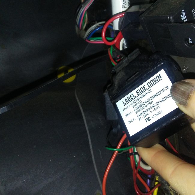

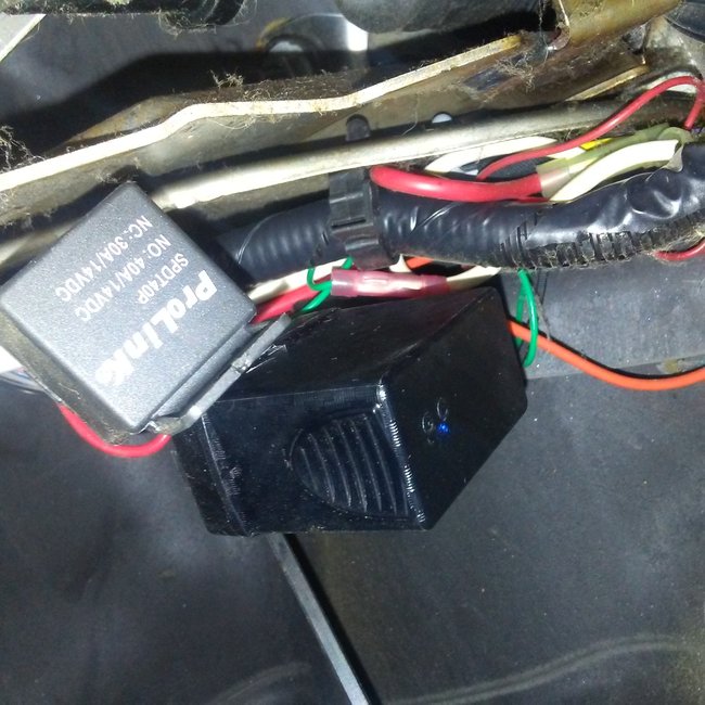

my battery kept dying so a friend (so called) said he would disconnect the DRL's (daytime running lights) went under dash under steering wheel not sure what he did or why, but now alarm and fob do not communicate. new battery and just got ignition switch replaced due to recall. what could he have done under there? also, there is a black box with small flashing blue and green light what is that to?

I cannot think of anything that has a blue/green light on it, unless it is some type of alarm bypass or after market add on like remote start or ?.
Do you think you could get a picture of it and your key fob and maybe it would give a better idea of what it is. You just click the add image button and upload it.

I looked up the funky box. Do you own this car or are you paying it off to a dealer? I ask because the box is a GPS vehicle tracking unit.
https://www.positionlogic.com/gps-tracking-device-library/xt-2000-g/
From the sketchy info they have on the site it looks like it can control door locks and other vehicle functions as well. As suck it may be connected and causing the locks to be unresponsive.
If you own the vehicle and have a clear title I would take it to a shop and have that unit removed.
If you still owe money to a dealer on it, take it to them and have them remove it or check the wiring to fix the locks.

I own it wow that's interesting so why won't fob work to alarm is it cause of that box will it work if I get it disconnected and is it hard to do. Thanks for helping me

It could be because that box is connected up and has failed or shorted something out, Or when the DRLs were "disconnected" it wasn't only the DRL wire. Perhaps ask which parts were touched. That might get more results. It could be simply that a wire that works the door locks came loose, that "add on box" could be the problem.
