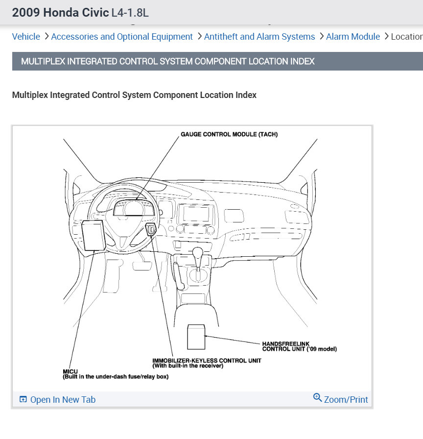

Alarm won't shut off and I do not have the fob key is lost. Drivers door lock is stuck and I can't disable it that way. Battery is now dead. Can the alarm system drain the battery? I can't find the alarm fuse in any fuse box to remove it. Is it labeled different and will that work? Been told there's a reset button/toggle switch located under the dash or hood by the windshield that i can use to reset the alarm but I can't find it or any pictures of what it looks like. Any suggestions? I can't afford the dealership.

You cannot remove the security or pull the fuse to make it not work we need to reset the system. If the system cannot be reset these cars have a problem with the drivers multiplex module going out causing the issue. Lets do a hard reboot of the system to see if the set will fix it. Here is a guide with the MICU location as well. Check the connector for corrosion.
https://www.2carpros.com/articles/how-to-reset-a-security-system

Update: I have tried everything on the list that I can except replacing the MICU. Also, I'm unable to locate the reset button on the left side near the kick plate.Is it possible to just replace and program the key (myself) that has the remote (not the door lock)? I only have the spare key that doesn't have the remote. It seems reasonable since most solutions require the remote key.Look forward to hearing from you.

The key sounds like it needs to be programmed which Honda will need to do it should cost about $130.00 let me know. Also we can do a CAN scan to see if any of the modules are having an issue.
https://youtu.be/InIlnsjOVFA
Please run down this guide and report back. You can get a CAN scanner for about $50.00 on Amazon.

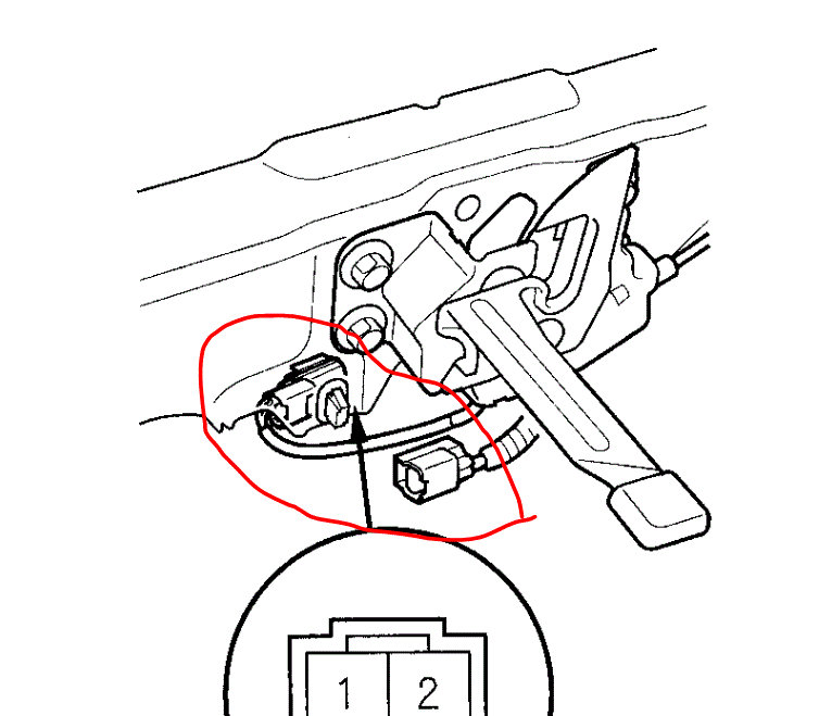

Fitted new battery, when connect negative lead alarm goes off and wont reset. Can open doors etc. with remote and start car but alarm wont stop!

Since you were under the hood working on it, make sure you didn't by accident disconnect the hood latch switch or knock it loose. I attached a pic below of it to help you locate it.
Let me know if this helps.

Thanks for help, have now got it sorted. Lithium battery on siren flat.
