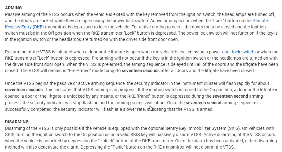

Every time I lock the door and then unlock the door, the alarm goes off
197,000 MILES • 3.7L • 6 CYL • 2WD • AUTOMATIC
RYAN MC5

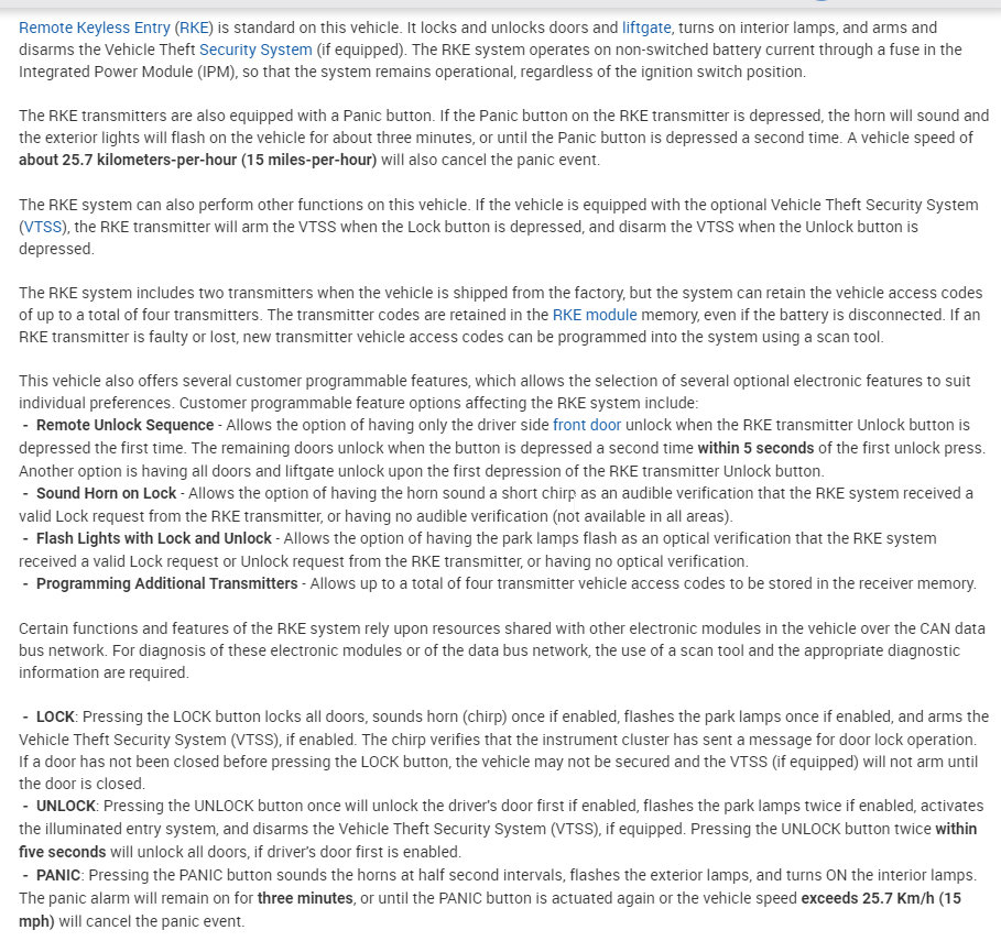

I don’t have my key fob for my vehicle. I do have the service key. How can I stop that from happening? It gets embarrassing at stores, every time I lock the door the alarm goes off.
Nov 22, 2019 at 3:22 AM
Unfortunately you need to disarm the passive entry system and the only way to do that is with the key fob. I attached the info on this system. I would suggest just getting a fob and programming it so you can disarm the system.
