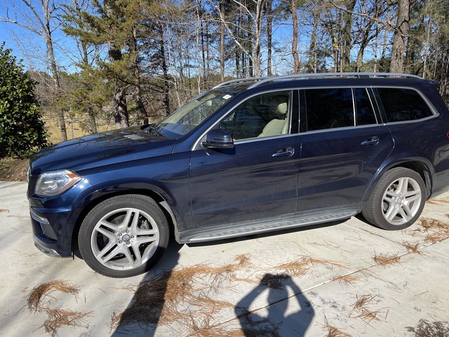

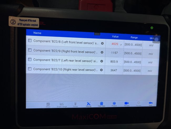

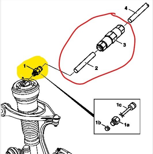

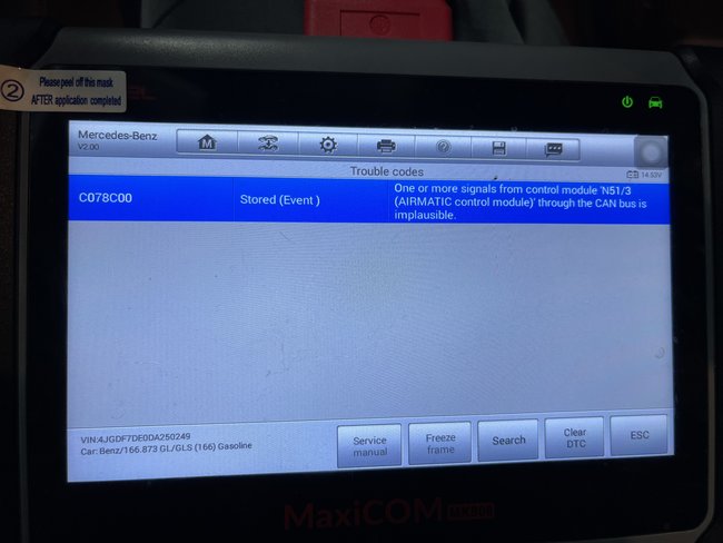

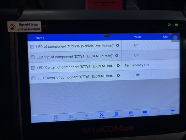

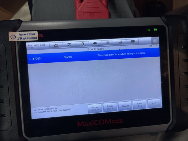

Left front sinking, can't be driven. But i also feel that most of the sides are lower than they should but left front is very low. I think the compressor ran and ran but couldn't get that side up, so it stopped. But i don't hear it at all. Am trying to find out whether it's the compressor or the left strut having a leak. Here are some data from the dampening system. I know the compressor location. Not sure if it can lock temporarily due to the front left sinking. I have had BMEs, Merecedes Benz, and Lexus that even of one side is down once you start it compressor kicks on and try at least and in many cases, they go up until you leave it for few days. Any help is appreciated.

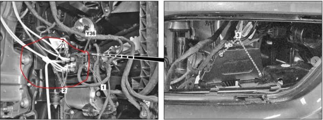

I would say the leak is in that corner and not the compressor as the other corners is staying up and they all use the same compressor. Most likely the issue is either a solenoid stuck or failed or an air leak. A stuck solenoid would act the same way as the air would be blocked and the computer would not see the height sensor going to the correct height and would keep running trying to move it. I would go check the control solenoid outputs first. Pop that line off that goes to that corner and see if air releases or not, you could use an air line and nozzle to put air into the system and see if it inflates or leaks. If it inflates the solenoid, is the issue. I believe you can have them rebuilt but with the current parts issues that could take a while. You might be able to make a line that at least lets you use a tire chuck to add air so you can drive it at least.

If the solenoid is stuck it could be that the pressure switch is shutting off the compressor. I would start with checking for leaks and work back from there, that way you don't replace the valves or compressor and then find that you need to replace the air springs as well.

I raised it up, checked on the sunk side and the strut is new, line has no issues. Checked the compressor, disconnected both harnesses, no corrosions, put them back, wiggled them. Checked the relay again and swapped it with another, checked the 40amp fuse next to it which has ground for some reason instead of power, not sure if that is how it's supposed to be. Removed it and reinstalled it. Removed the airline from the top of the air strut as the beep is coming from it, noticed also that the boot on the strut is stuck all the way up, pushed it down. Turned the car on and as you can see there is air coming out of the hole in increments. Not sure if this is normal but then i started to hear the compressor. Turned it off, put the air line back and started the car and she rose all good. Who the heck knows what is the issue?
