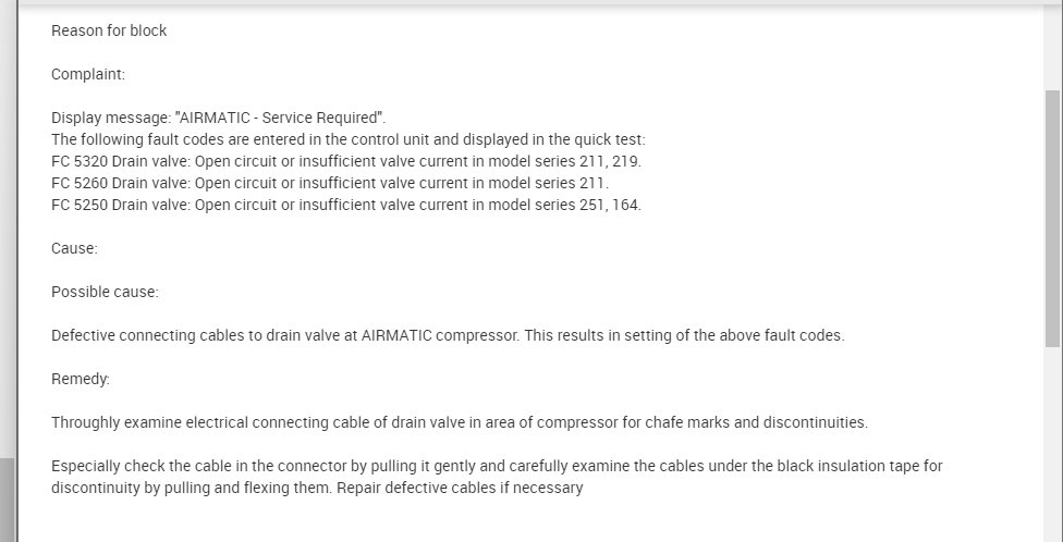

I got a scanner that can read everything with the car. It pulled 5503 and 5508. Leak detected and reservoir taking too long to fill. Thought I would add this.

There are a couple of possible issues. One you have a valve block that distributes the air to the corners that are needed so if the vehicle is not reaching the proper ride height, then that is one of two main reasons. First it is either a mechanical problem that it cannot reach the height.
This would be a pump not being able to supply the pressure or a leak that is preventing the height from being reached.
Otherwise, we have an electrical issue that is making the module think it is not getting to the proper height.
So, it sounds like you have an actual issue getting to the proper ride height and with the codes that you have, the leak is in the pump and reservoir side of the system.
Once the system is filled the lines are sealed off and if they are holding their height then you have no leak in that side.
Basically, it looks like the pump is not able to fill the system to the needed amount or there is a leak between the pump and reservoir that is causing the pump to not fill the system properly.
This would explain the different noise the pump is making. What I would do is replace the pump and valve block and retest this.

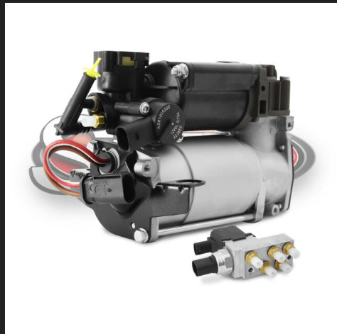

I replaced the compressor. I raised the car manually a couple times and it worked just like it should have no issues. I took the car for a very short trip then I went for a longer one. I went on the highway under heavy acceleration and drove at 45 to 65 MPH. So, the car can adjust in the fly. There are no codes pending or current. After looking at the old compressor it appears it is starting to fail and there is a small leak in the relief valve, air hose that goes into the compressor. It appears to be fixedish. I snapped two out of three bracket bolts. Have to buy a new mounting kit. Thank God for extra strong industrial zip ties.

Haha. Yes. Thank God for zip ties.
Sorry for the delay. Clearly you did not need me as your thought pattern was exactly correct.
Here is what I suspect happened. If you have a small leak, that causes these pumps to run more than needed and it actually burns them up.
So, it is critical to fix any leaks, or the new pump will eventually fail as well.
However, if you found a small leak and fixed it, replaced the pump and now the system is operating and there are no leaks then I suspect you are just fine.

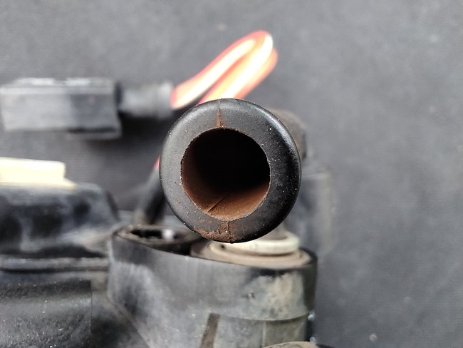

I've always figured things out when I talk it out or bounce it off someone. I'm going to take apart the old compressor. I just remembered I drove for 3 months in winter with a broken intake hose after filter. I have a feeling dirt got sucked up and wore down internals causing it to leak and not produce enough bars. I live in NJ, there is always a ton of salt on the roads.

Well, I am glad you are coming to us to bounce things off.
That makes perfect sense. Let us know what you find and post pictures if you find something interesting.

Definitely sucked up water and debris. The piston and seals are probably torn and pitted.
