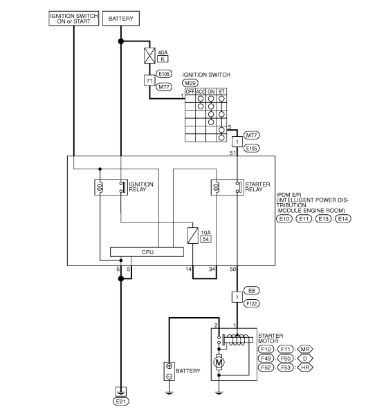

First check that there is constant battery voltage to the main supply wire at the starter.
If in order next check that you have 12V supplied to the small connector at the solenoid when you try and crank the engine. for that you can use a voltmeter or a test light.
How to use either:
and
If 12V is present, then this could point to a possible bad starter motor.
If no 12V is present when trying to crank the engine next check that fuse F54(10A) in the IPDM is still intact, see image 1 below.
The IPDM is the engine fuse block.
Next I would suggest to then remove the starter motor and bench test it

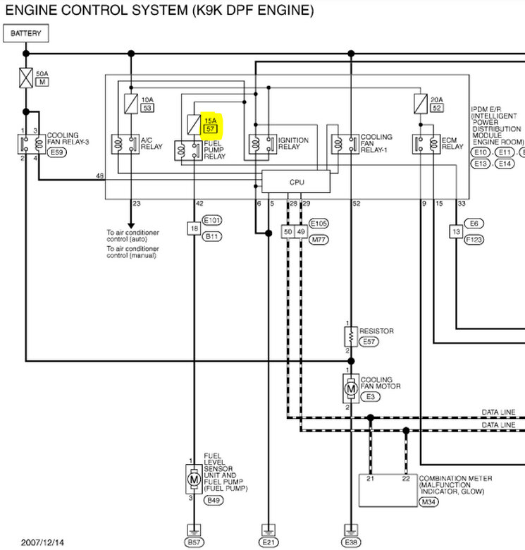

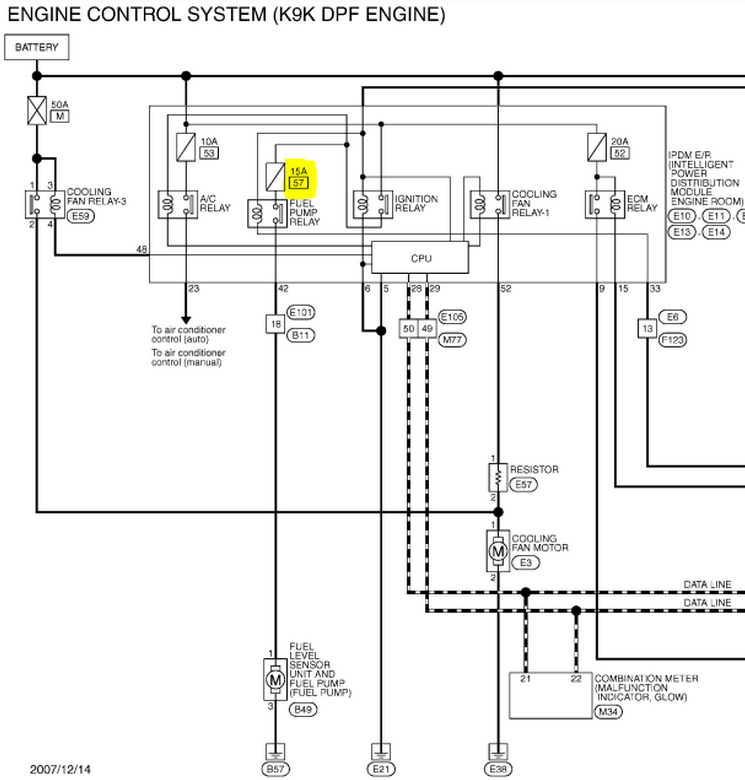

No fuel supply.
First check that the in-tank fuel pump energizes when the ignition is cycled on/off.
The pump has to energize for 2-3 seconds to prime the fuel system
If the pump cannot be heard energizing next check that fuse F57(15A) in IPDM is still intact. See image 2 below.
If fuse is in order next check that we have 12V supply at the pump connector using either a voltmeter or test light. This would be at pin 1, black/yellow wire. Also check that pin 3, black wire, has a good ground.

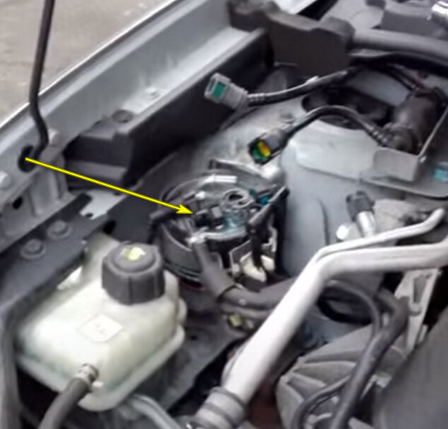

If 12V is given at the pump, the pump is working as it should then next check that the fuel filter is not blocked.
This can be found on the driver's side in the engine compartment.
See image 3.
