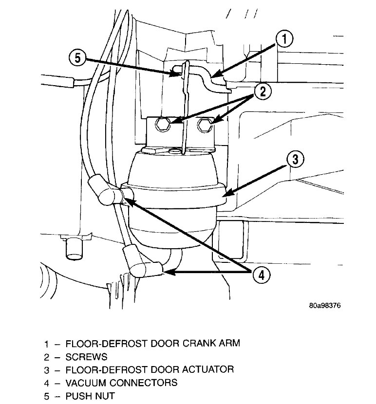

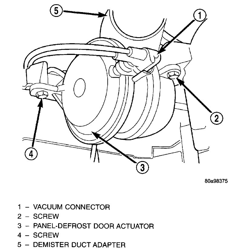

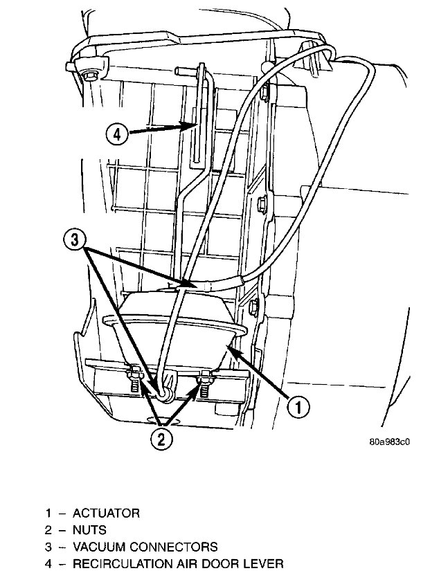

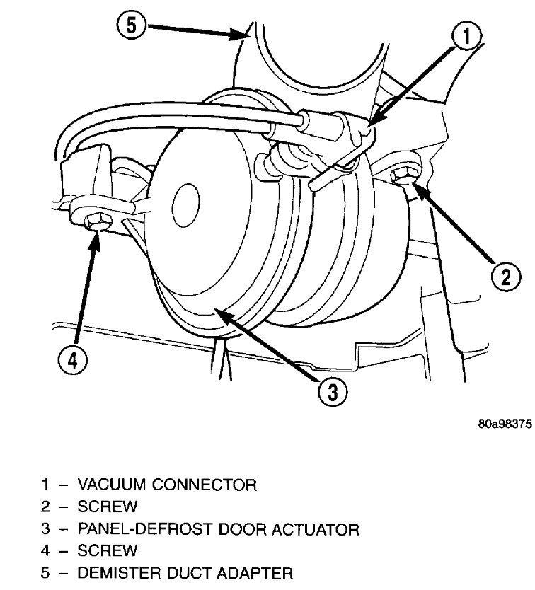

when heater or a/c is on air comes from defrost and floor but not out of dash.
Jun 11, 2024 at 3:14 AM
  • 55,447 POSTS
Yep, this happens when the small vacuum line going into the firewall from under the hood is broken or disconnected from the engine, I would raise the hood to inspect this small plastic hose. please go over this guide to see what I am talking about:
https://www.2carpros.com/articles/air-vents-stay-in-the-defrost-position
Check out the images (below). Please upload pictures or videos in your response to any problems so we can see what to help you with. Here are the vacuum lines under the dash which can sometimes be broken as well.

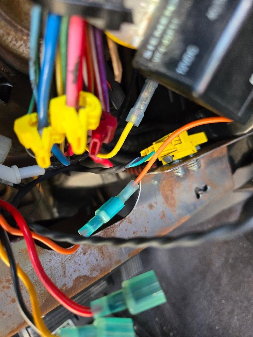

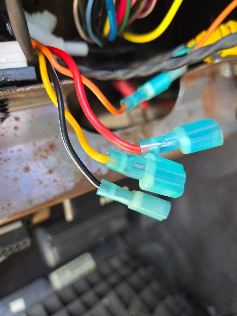

hi Ken,
I have another problem. i disconnected these wires without marking them and know i don't know where they connect. it's a red, yellow and a black wire that go to the three inline connectors shown (pictures). can you help please?
Jun 17, 2024 at 6:39 AM
  • 55,447 POSTS
Sure, I can help but we only handle one problem per thread, please post your new question here, you must be logged in.
