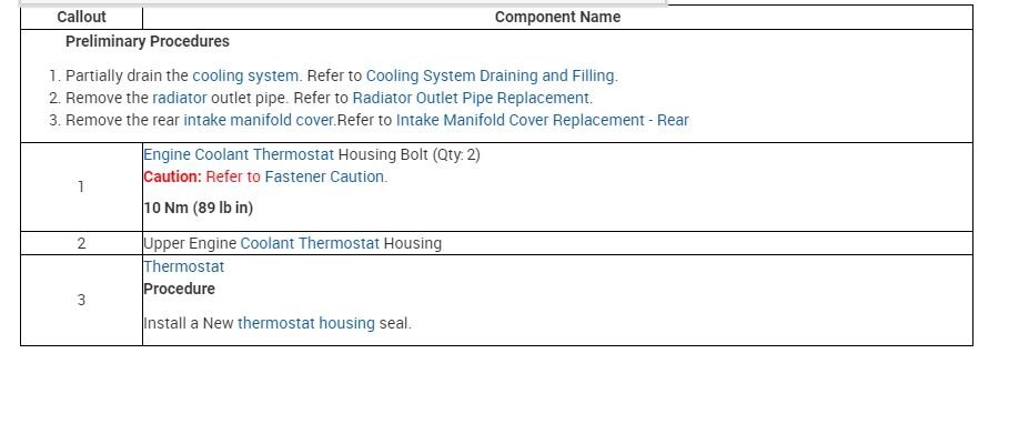

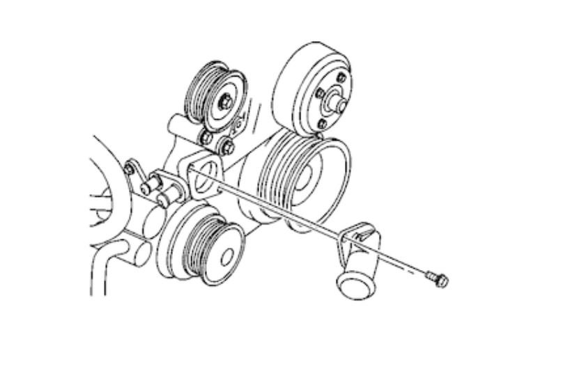

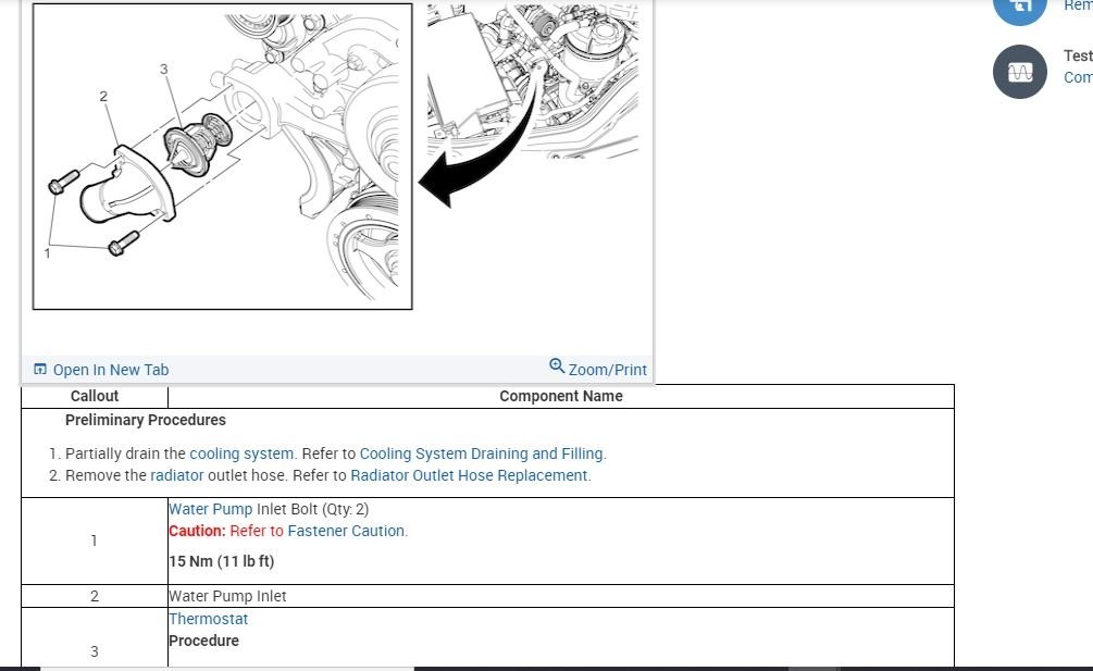

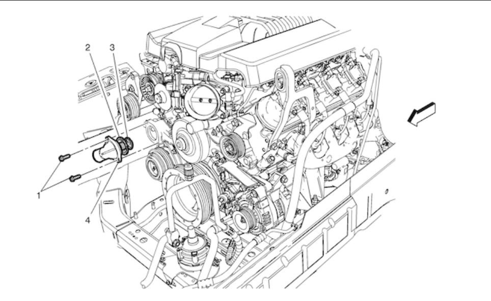

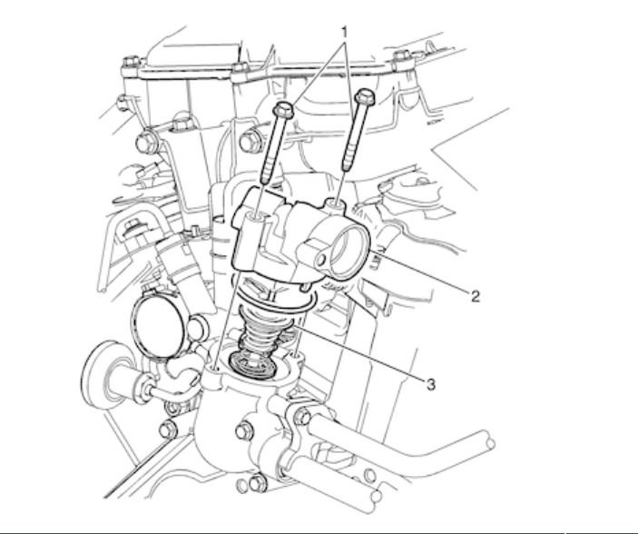

Good morning,
This sounds like the thermostat is stuck open not allowing the engine to heat up quickly to produce heat.
I would start there. There are 3 different locations that vary depending on the V6 you have.
I have attached all the possible locations.
