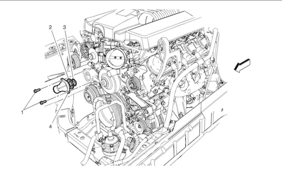

Air blows fine in the car, but when it's cold out it will take long to heat up and when it's hot out it will not cool down. no check engine lights or anything come up . was to get it checked at the dealer but want to avoid a large diagnostic bill on top of getting repairs.
Jan 20, 2020 at 8:04 AM
Good morning,

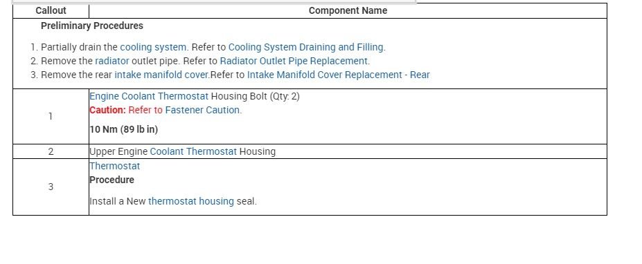

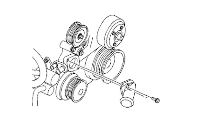

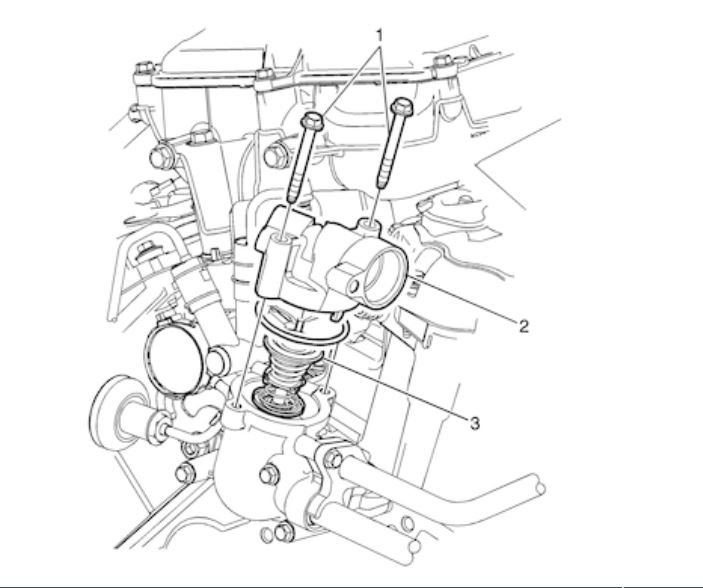

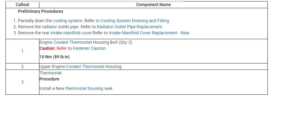

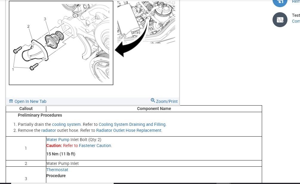

This sounds like the thermostat is stuck open not allowing the engine to heat up quickly to produce heat.
I would start there. There are 3 different locations that vary depending on the V6 you have.
I have attached all the possible locations.
