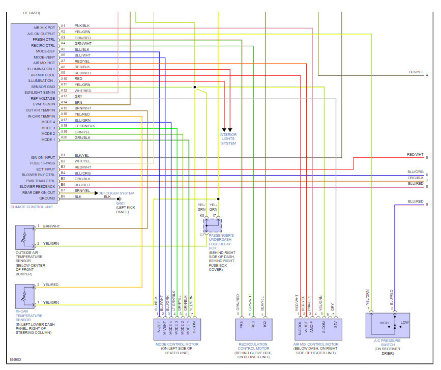

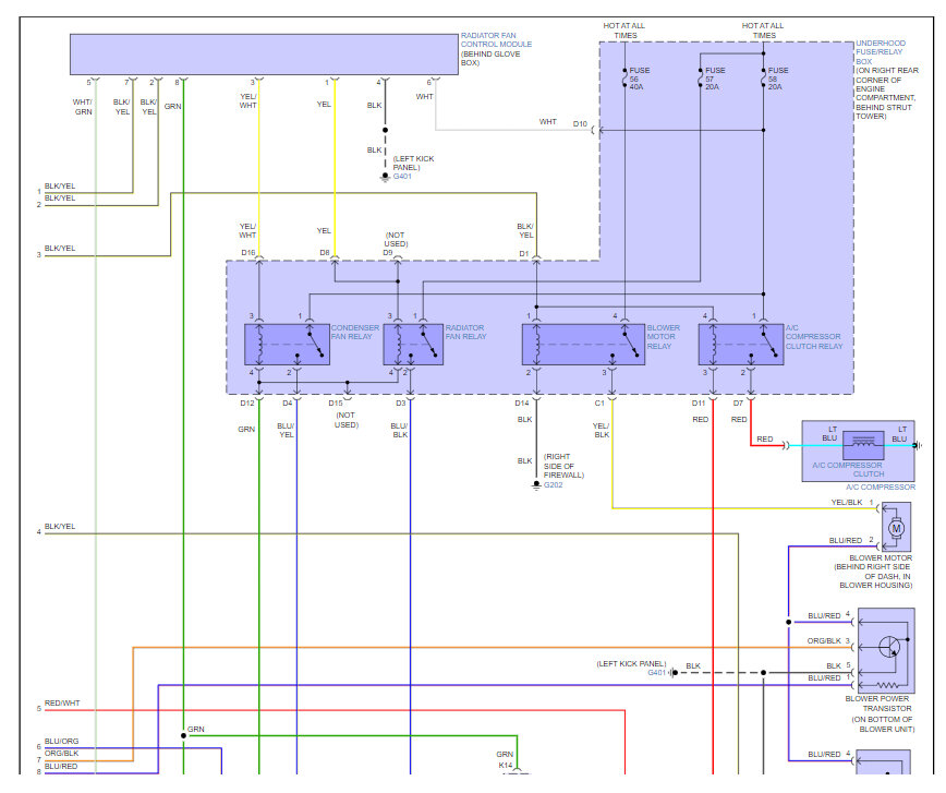

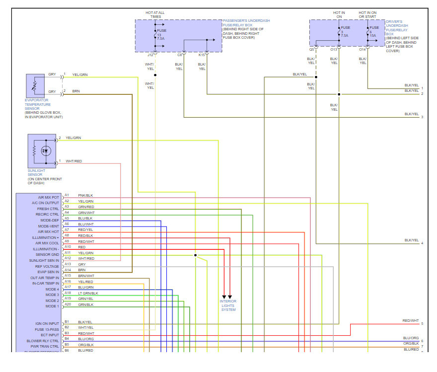

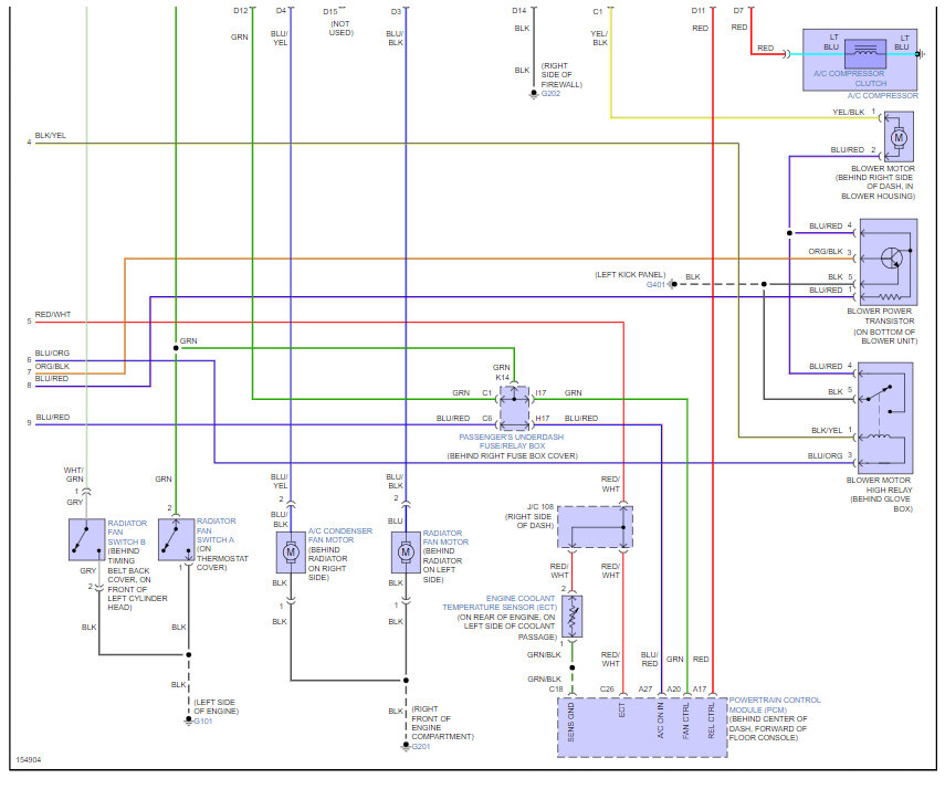

Compressor resistance is 5.1 ohms and engages when direct power is applied. Radiator and condenser fans are working. Assistance with a wiring diagram is much appreciated. Respects!

Sure, here are the A/C system wiring diagrams as requested. Here is a guide to help you with the testing as well:
This guide to help as well:
