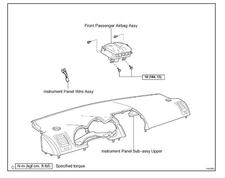

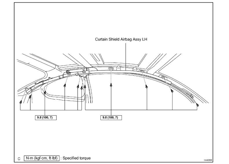

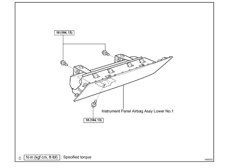

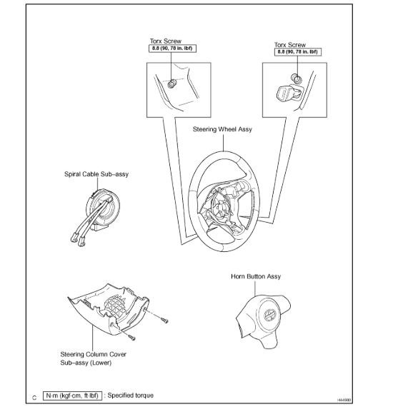

Does the vehicle listed above have airbags in the seats?
May 27, 2020 at 5:31 AM
Good morning,
No, there is not an airbag in the seat.
You have an airbag in the steering wheel.
You have an airbag in the post trim for the windshield.
That is it. What is the issue?
