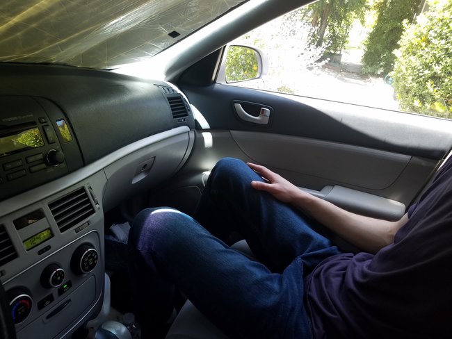

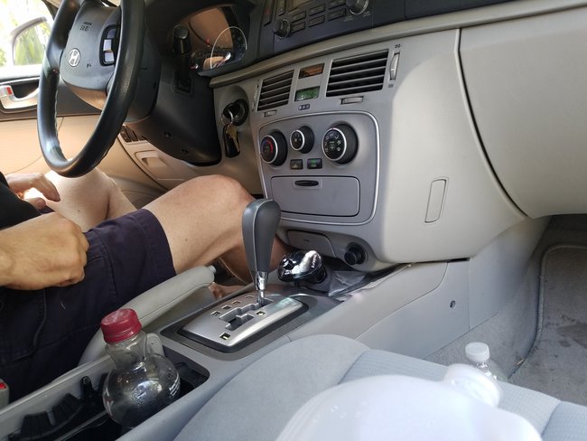

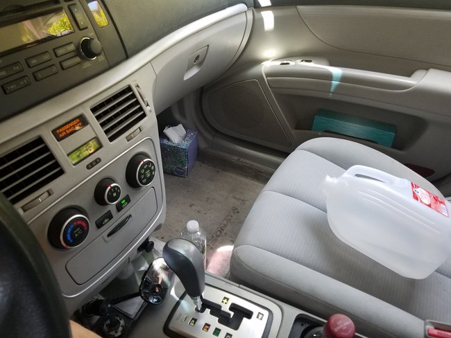

To confirm what I said previously, the passenger airbag light seems to be working fine. When I put light items on the seat, the light stays on, but when an adult sits on the seat it immediately turns off. Doesn't that go counter to an OC passenger sensor mat defect? What do you think?
Should I reset the codes and see what happens next? Could that be my next best solution?

When you put items on the passenger seat, the low weight can be interpreted as a child and make the passenger airbag to turn off. A light should illuminate to warn you the passenger airbag has been deactivated.
When a full size adult sits on the same seat the warning message will turn off and have the passenger airbag active and ready to deploy in an event of an accident. Can you post a couple of pictures of the lights coming on when you put light items and when an adult sits on the seat?
As for finding a trusted Hyundai dealership I cannot make any recommendations. If you do have an open recall I would recommend you take it in for the proper repairs. Also another issue you have is the connector not snapping in correctly. The connectors need to lock. If it does not then you need to inspect the connector for bent pins. Can you take a picture of that connectors pins and post them on here?

ARA GERARD CHILINGERIAN
Here are the pictures that you asked for.
May 30, 2019 at 5:56 AM
JIS001
  • 3,412 POSTS
That looks normal and is doing what it is suppose to be doing for now. You should still take it in for the recall if it is still open.
