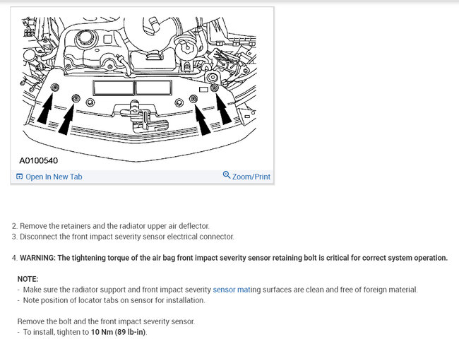

I'm trying to find where my airbag sensors are located in my car. I'm unable to find anything In regards to a location in the front end the would be.
Oct 13, 2023 at 5:18 AM
  • 55,447 POSTS

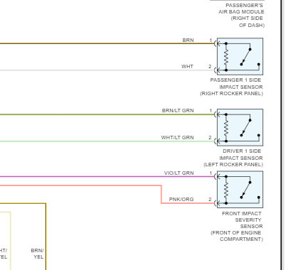

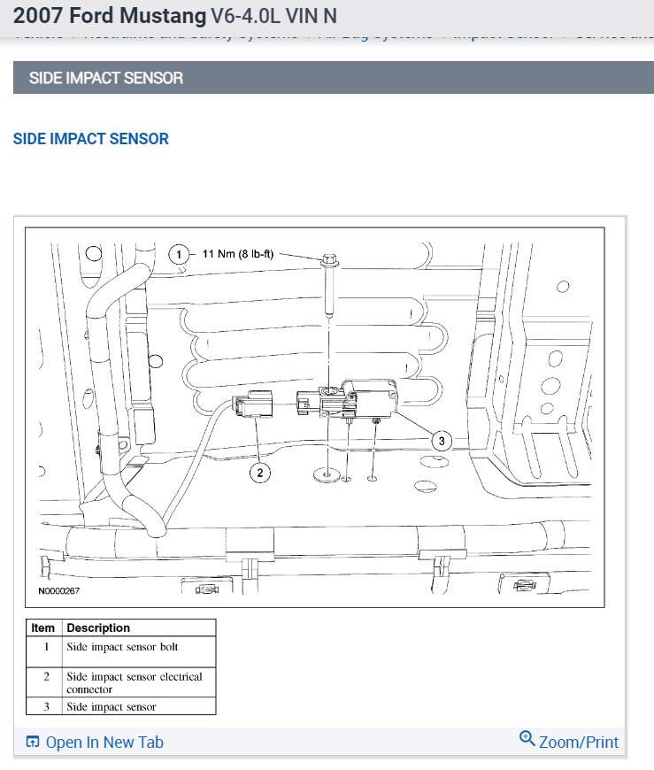

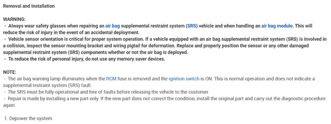

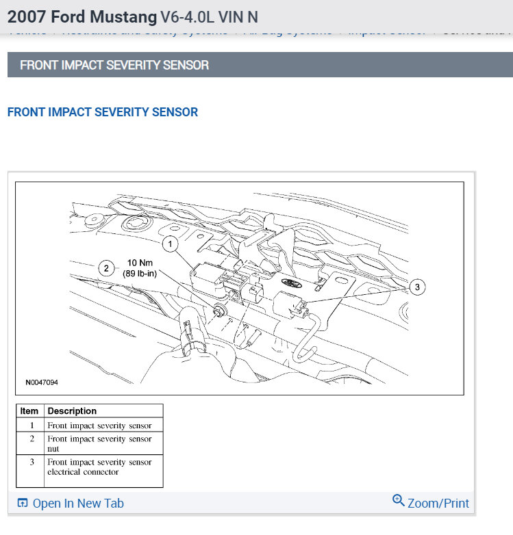

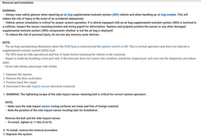

Yes, there are three airbag impact sensors that run the system, one is in the front of the car while the other two on the either side of the car near the drivers and passenger doors. I have included the location and how to change them out. Check out the images (below). Please let us know if you need anything else to get the problem fixed.
