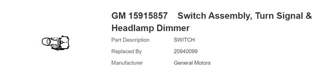

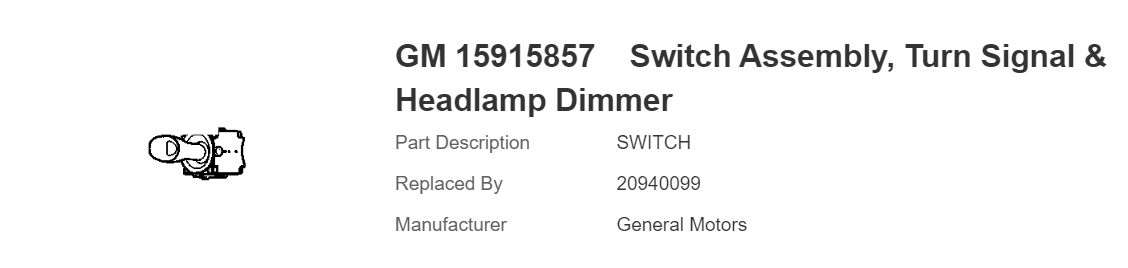

The clock spring could be causing the airbag light to be on. However, I believe they are two different components.
Take a look at the pic below. The OEM part number is 15915857. See pic below.

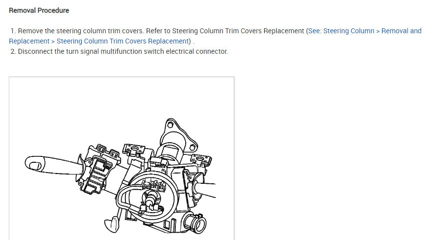

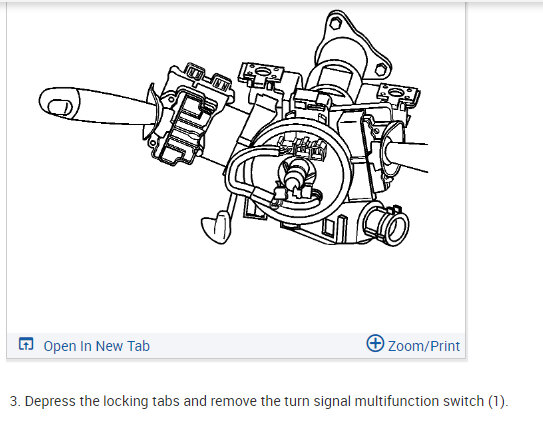

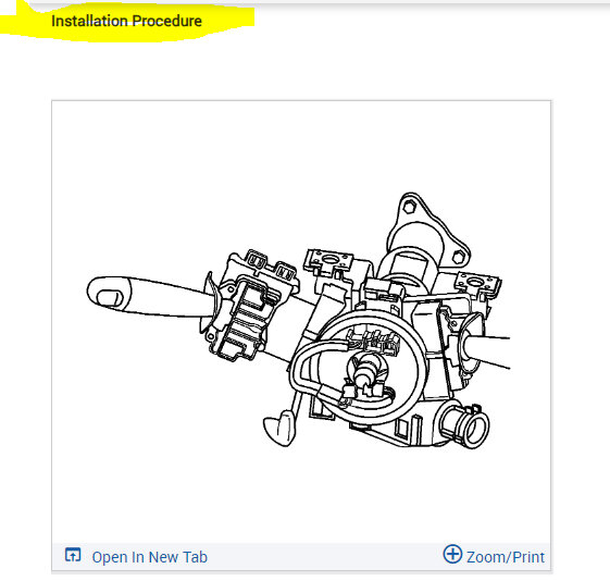

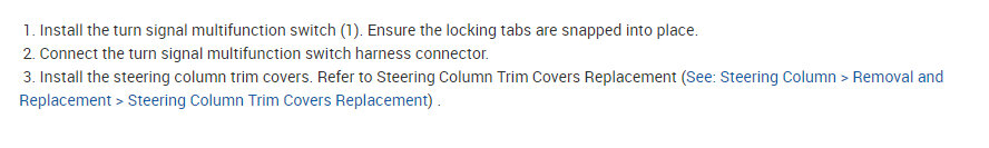

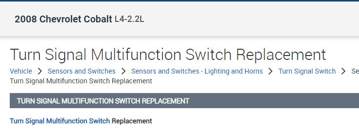

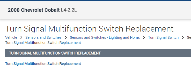

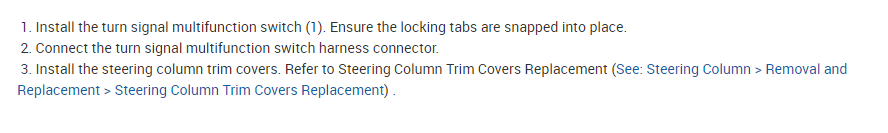

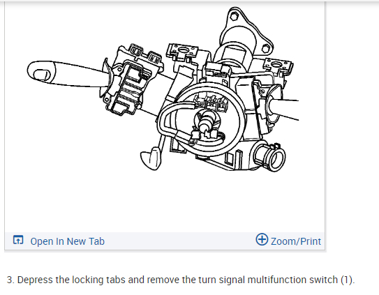

Can you send me the steps of taking out the old turn signal switch?
Aug 14, 2024 at 8:08 PM
  • 110,241 POSTS
No problem. I attached them below. Let me know if they help.
