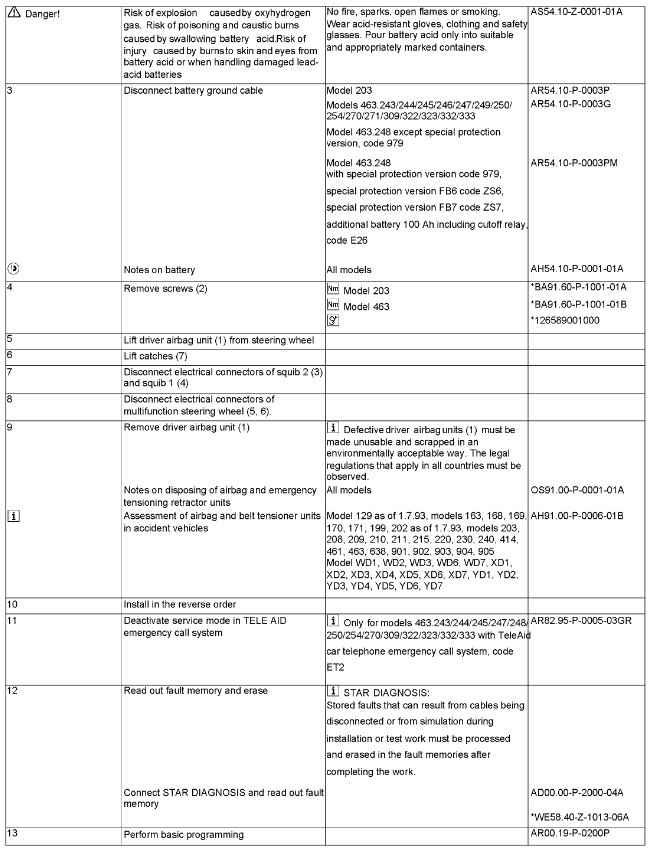

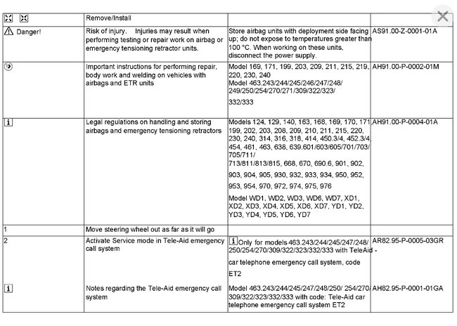

Yes, those screws will need to be turned to the left to loosen, just like normal screws. Keep in mind that since the screws are going towards you the left turn might feel awkward, as if you are facing the steering wheel, it might appear that you are turning to the right.
I have attached the replacement procedure below for your reference.
