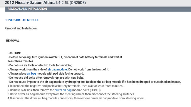

What size torx is used to remove the bolts on the steering wheel airbag?
148,000 MILES • 3.2L • 6 CYL • 2WD • AUTOMATIC
DWARREN
I have a set of star tools with a hole in the middle, but the holes are too small. It seems like it may be a T27 but the hole needs to be larger.
Sep 18, 2022 at 9:28 AM
  • 55,732 POSTS

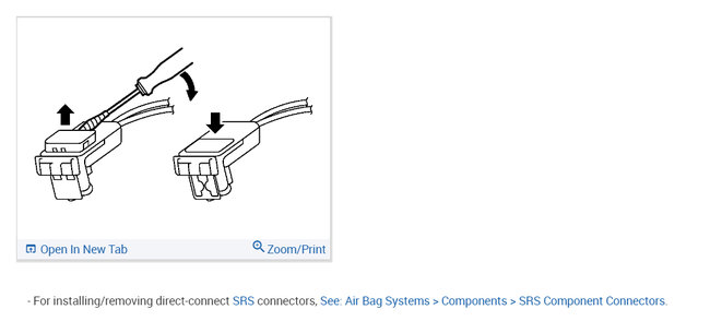

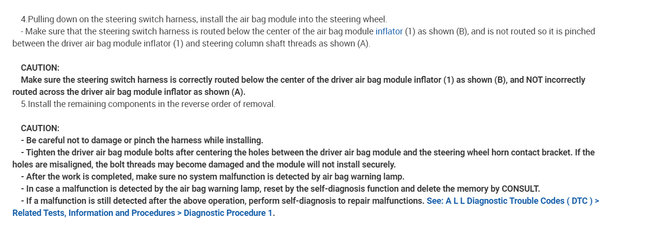

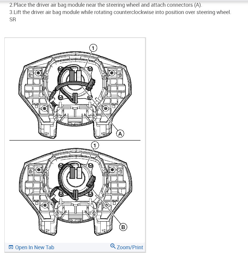

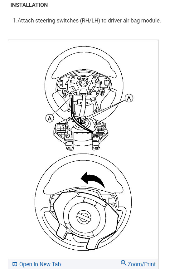

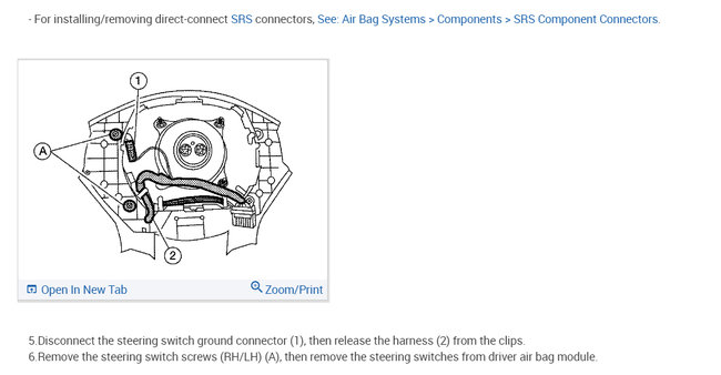

You will need the long reach torx bits check them out in the link below for $13.00 from Amazon. Also, I have included how to remove the driver side airbag in the images below. Make sure you disconnect the battery first.
https://amzn.to/3ShBSHO
Check out the images (below). Please let us know if you need anything else to get the problem fixed.
