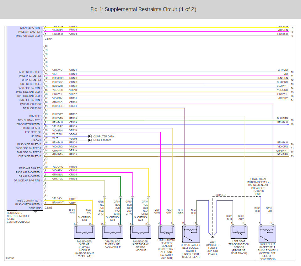

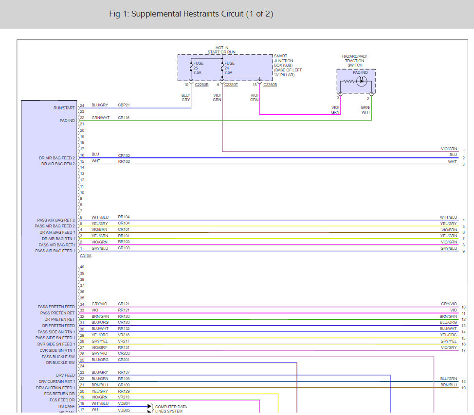

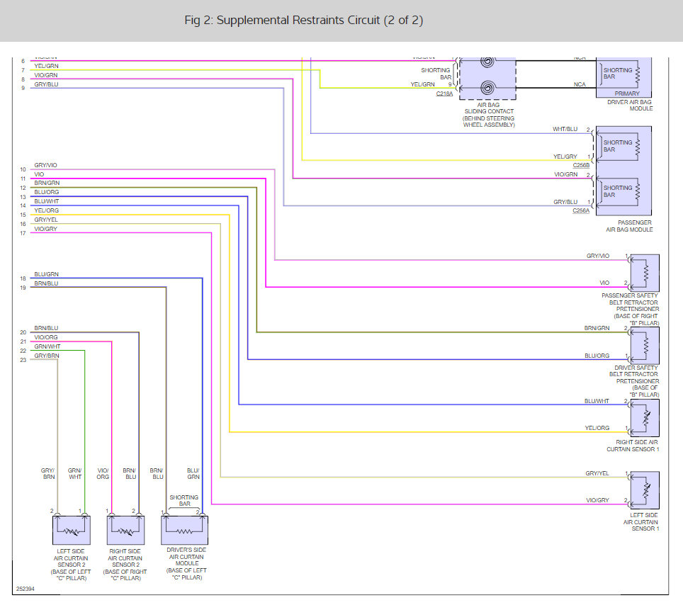

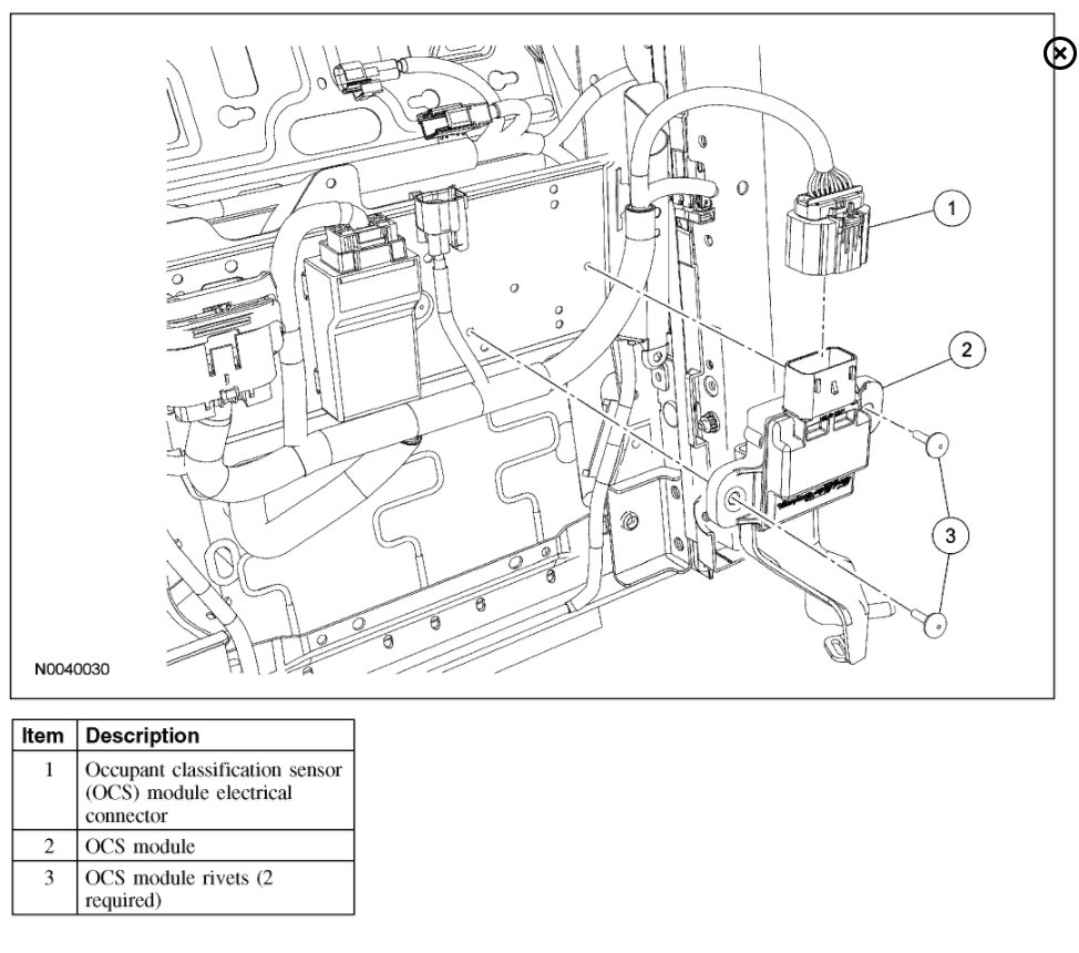

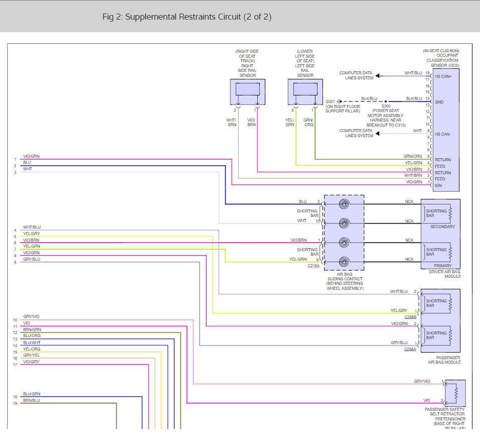

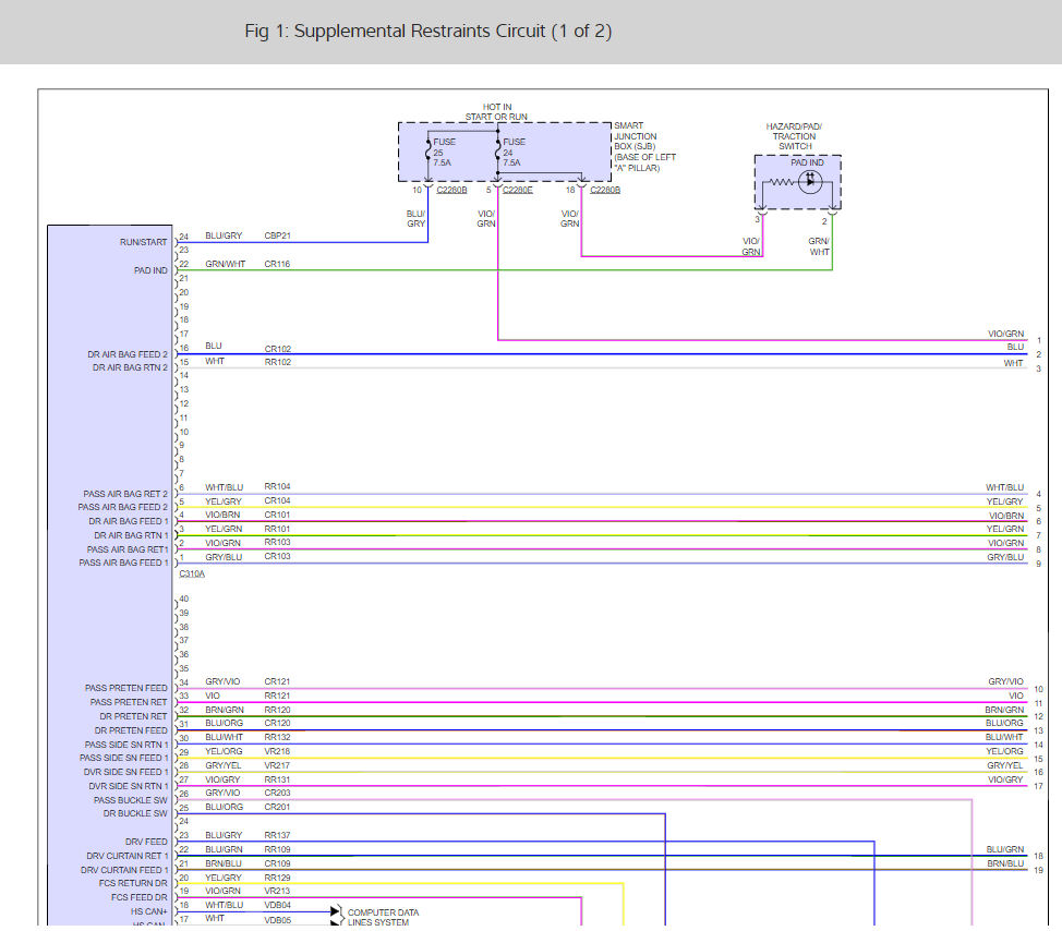

Testing the sensor is difficult because of the resistance to weight ratio. Here is the wiring diagrams and the location of the occupant control module (below) as well. You might be better off getting a used seat check to see which one is cheaper.
The wiring diagrams give you an idea of how the system is put together.
