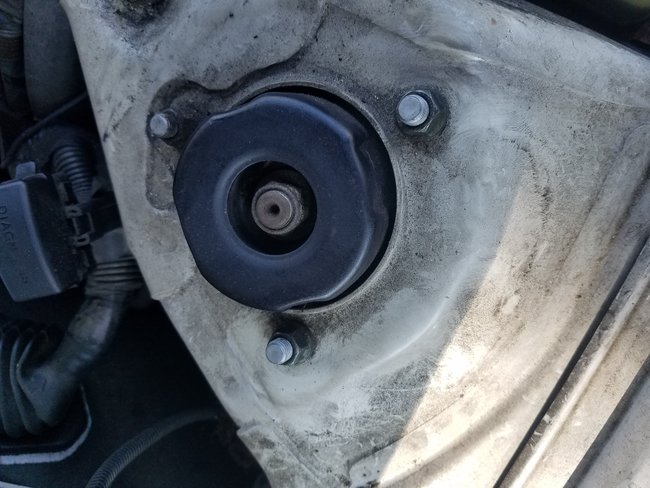

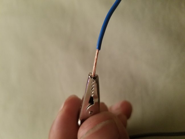

Update. I have successfully cleared the AIRBAG code! I did what you told me and it helped a lot. It took at least many tries to get the speed down which was a quick alternating between the terminals. Many said 0.2 seconds but I didn't think too much about it and just went quickly.
Here is my summary of what I did. I use the ground wire that was thin twisted copper that my father let me borrowed and used the alligator clips to clamp at the end of each wire and placed it in the DLC 1. I then used my ground near the DLC 1 that had three bolts around it and clean it off two bolts but only used one. Now the alternating between grounding the Tc and AB it was done through trial and error. I tried using the ground wire (thin twisted copper) itself, quickly clamping the ground with the alligator clips, different locations of ground, different speeds of alternating with the ground. None have worked, until I relaxed a bit and tried to do it as simple as possible. Which was touching the ground with the alligator clips without clamping since I figured it was mess up my quick timing. Then my father saw the code flash quickly. Once I took off the alligator clip from the ground, which was the Tc, the error code cleared up. I turned on my car twice to see if it stayed on but it didn't.
Thank you so much for your help and I gave my summary if anybody who had the same problem as me so they have an idea what they can do to clear the AIRBAG code. I will add photos in a bit so they have a clear visual what they need and will do.

Also before I post the pictures. KHLOW2008, I see you posted pictures of the 1992 Toyota Camry LE of Fig.13 and Fig.15 of the AIRBAG procedure to clear the code. I would like to know where can I get the actual book to have as a reference for future issues. Is there website you downloaded the book and what is the book called?

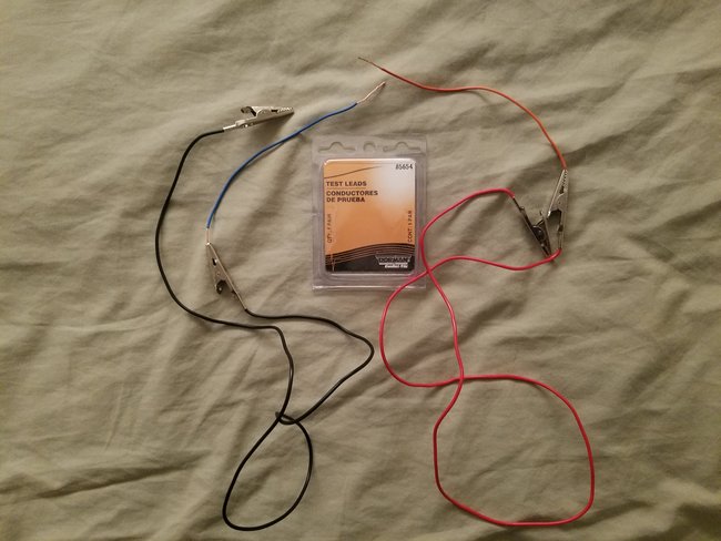

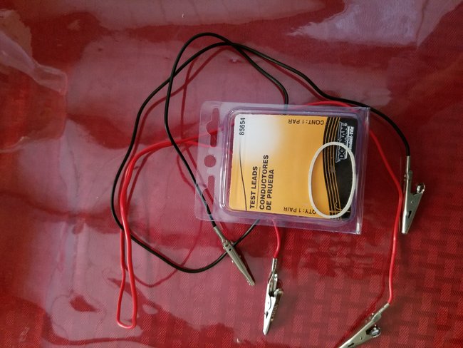

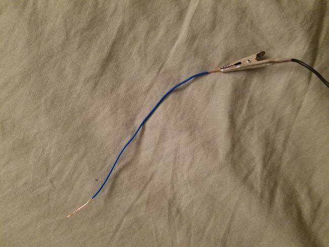

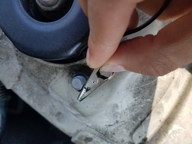

As for the photos here they are.
The first three photos is my set up. I got a pair of test leads from AutoZone and the ground wire, which is the thin twisted copper, clamp on one end of the ground wire in the nose of the alligator clips
Now the fourth picture is the screws I used for my ground near the DLC 1 box. You'll notice the bottom two are clean which is important to do so to have better ground current. But I only used one to keep it simple. In this case I used the bottom left.
Finally the last picture is how I managed to clear the airbag code after a few trial and error methods. You simply just touch the screw with the alligator clip. I recommend to have a faster timing alternation is to prepare closely to the screw with your alligator clips NOT TOUCHING IT but being near it. This way after the six seconds mark, you have a faster timing alternation between the terminals to the ground since you'll use both of them to clear the code.
I hope this helps for anybody who has the same issue and I apologize for the quality of the pictures.

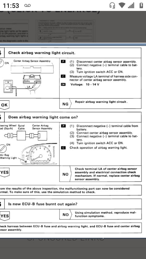

okay . That is great. What this step is asking you to do is disconnect the battery. Connect the sensor back to the connector. Reconnect the battery and then turn the key on. Does the light come on? It may not stay on but when you turn the ignition on, the airbag light should do its self check where the light turns on and then off. If it stays on that is fine, it just means you have a code.
Sounds like your light does come on when it is connected. If it does then it is asking you to go to the next step and check the fuse and circuit as you may have a wiring issue.
Keep in mind it is important to follow the practice of taking the battery negative terminal off when connecting and disconnecting these connectors. If you don't and you get a quick short or spark the air bag can go off and that will injure you.
Just let me know if this is what is happening when you do this test and we can go from there. Thanks

Yeah, I've always disconnected the battery when plugging or unplugging these type connections.
So how do I proceed? I got voltage, airbag warning light stays lit still, ECU fuse is good, still get code 22.
So do I need to jump to the step where I disconnect the steering wheel airbag spuib connection, right?
Jan 13, 2021 at 1:31 AM (Merged)
Yes. Take a look at the attachment. I show you are here where it is saying you need to clear the code, wait the proper amount of time and then check it again. If it comes back you need to replace the assembly.
