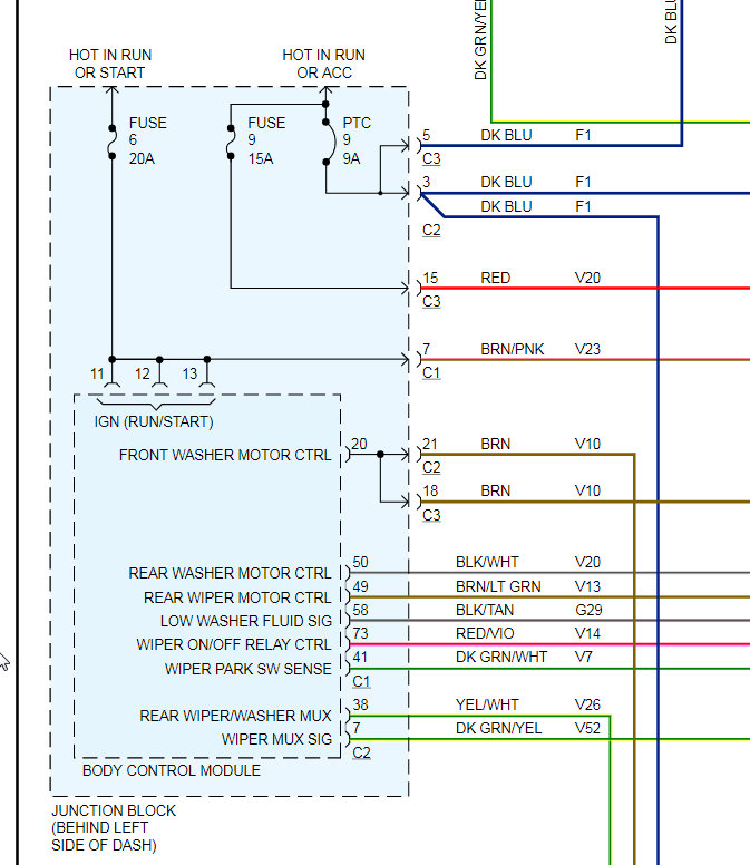

I did find another possible cause which is on the van it seems rear wiper and airbag circuits partially share the same fuse under the hood.

I assume you are talking about fuse 6? If this what you are seeing and the airbag light is on then this would not be an issue. This fuse only feeds the actual indicator lamp for the airbag. You can see the fuse also feeds the rear wiper motor but since the light is on, the fuse is okay.

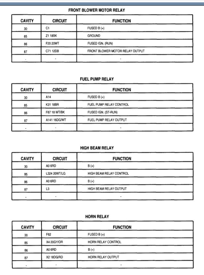

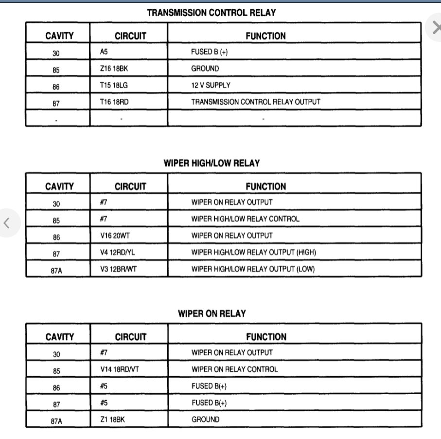

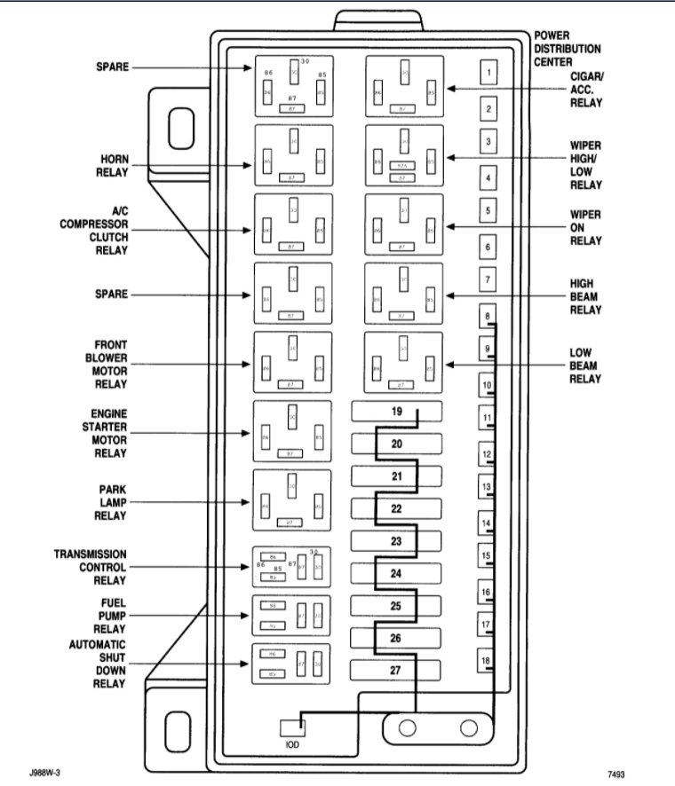

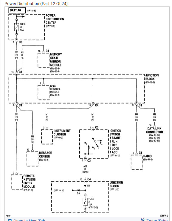

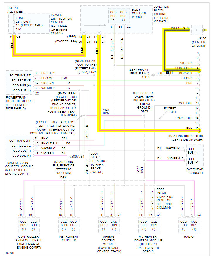

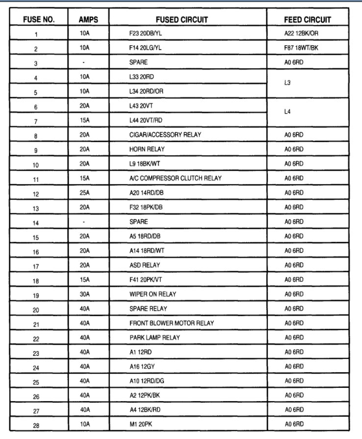

The PDC is on the left side (driver) of the engine bay and you are looking for fuse 28.
This diagram below does not show 28 but it will be on your fuse block under number 27.
You are correct that the if the wipers work then fuse 19 is ok which feeds this fuse but that does not mean fuse 28 on your vehicle is okay.
So let's start with checking the voltage with the key on at the DLC.
Put the meter on pin 16 and 4 and your meter should read 12 volts.
If it does not then you have a fuse, wire or ground issue.
So let's start with this and then find out were to go from there.

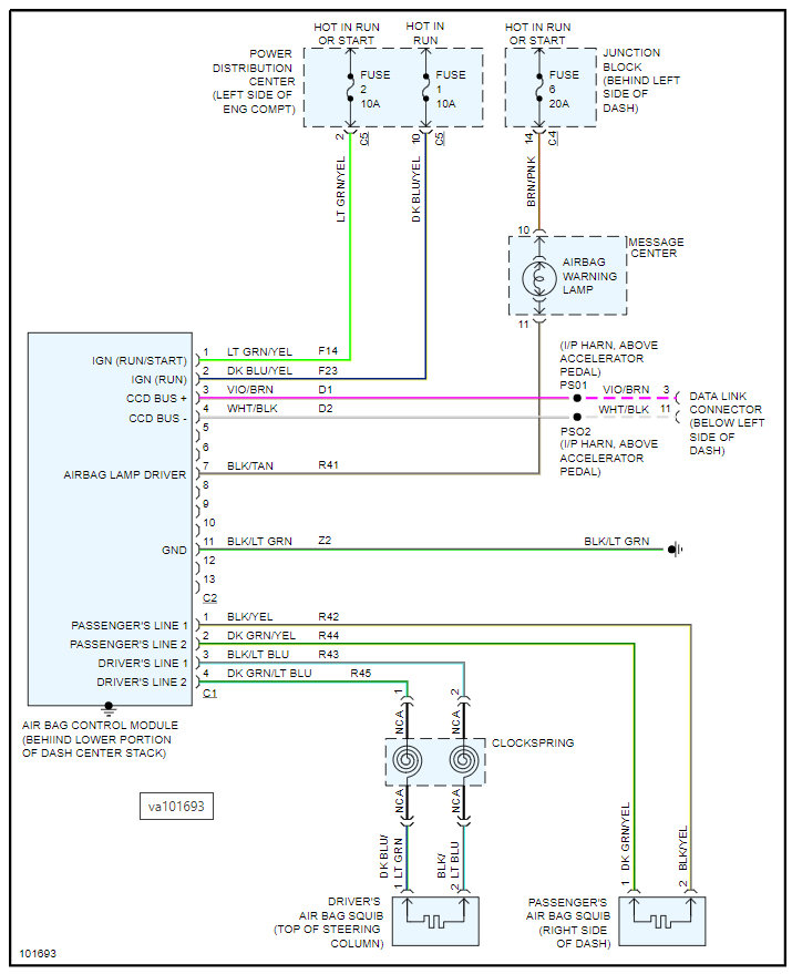

Okay. This is more than likely a module or squib itself issue.
Do you have the code they gave you? That will tell us what testing we need to do.

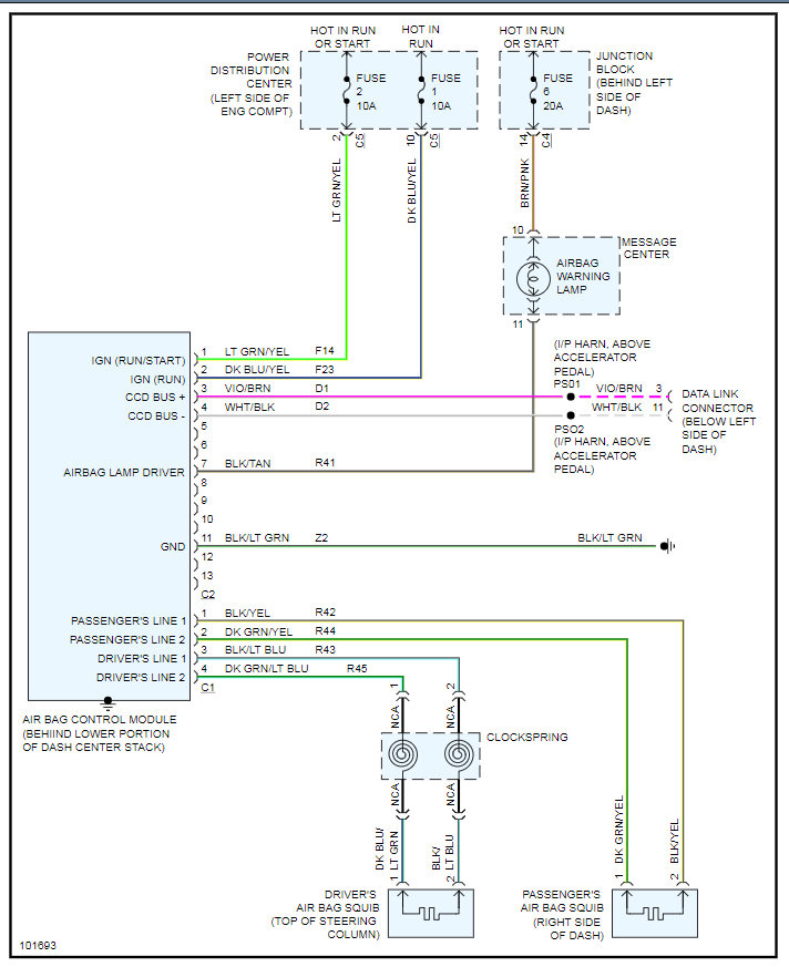

However, if you look at this wiring diagram which will probably be similar to the one you are looking at, you will see there is no fuse directly to the squib.
These are run through the module as that will completely control the operation.
So for you to have a code for a squib circuit means there is an issue from the module to the squib.
So let's get the actual code and then we will have some testing to do.
If it is the driver squib then there is a chance that the clock spring is the issue or the connector was not fully seated as this one runs through the clock spring.
Let us know. Thanks

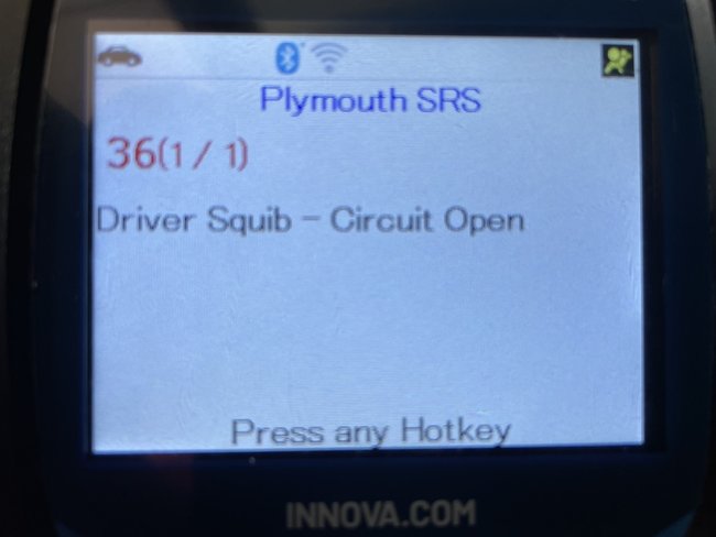

I got back from the garage and after paying another 20 to him he scanned and I took a picture of the screen.
He has some small handheld device.
Here is the image of the code screen.
Thanks
Vor
Sep 19, 2021 at 5:05 AM

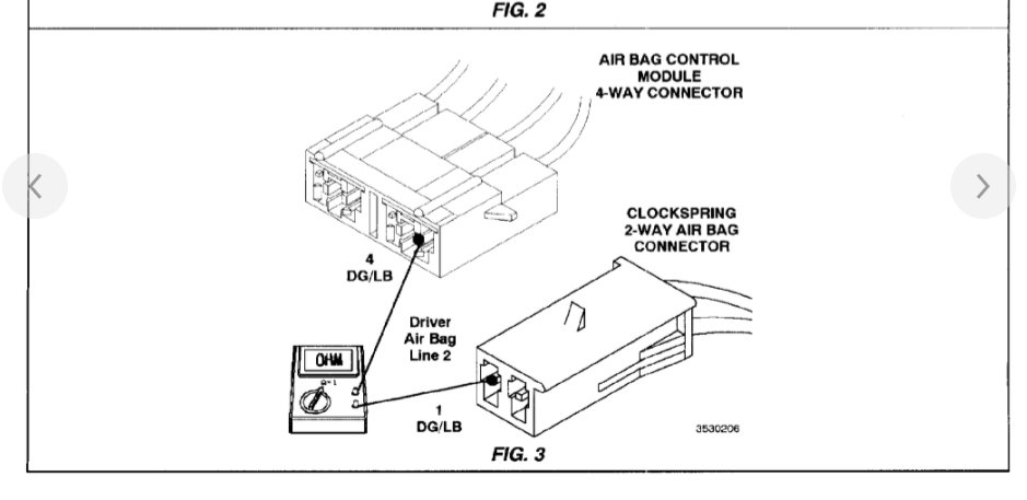

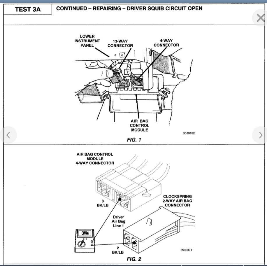

Okay. Perfect. The circuit open DTC is by far an issue with the squib itself.
However, there are a number of other things like a loose connector like I was mentioning earlier.
Basically what this is saying is the module is not seeing a complete circuit from the module to the squib and back to the module.
So we have a connector, wiring, or squib issue.

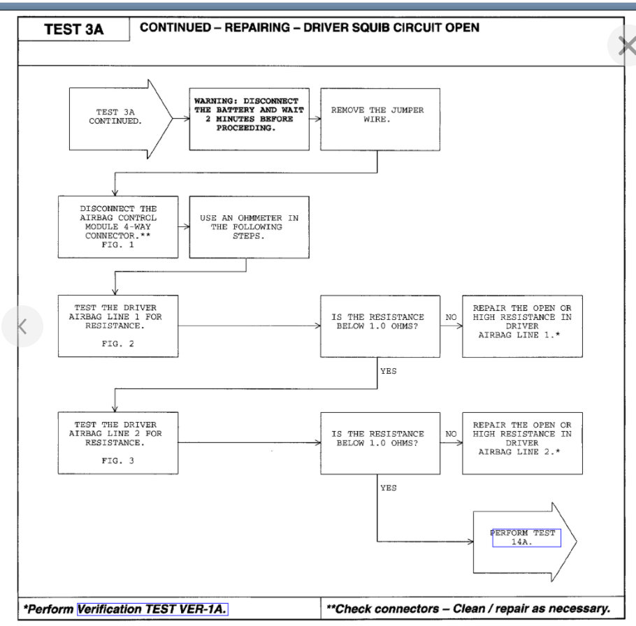

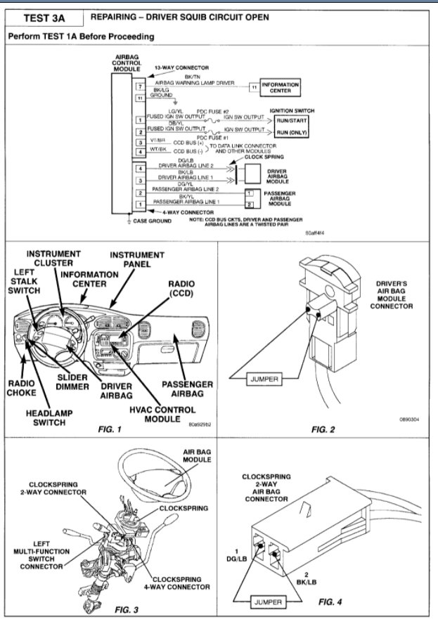

The fact that the clock spring was just replaced, it is possible that something was left loose so I would not just replace the squib. However, you can run through this testing and confirm what the issue is.
Here is a guide that will help with this type of testing:
Thanks

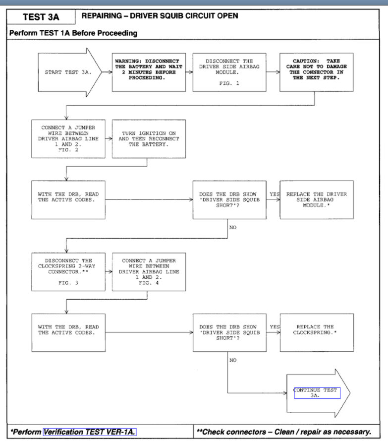

Take a look at the second screen shot above. It says to disconnect the battery, wait 2 minutes, disconnect the air bag from under the column cover, and then install the jumper, then reconnect the battery and test for the code.
Basically all you are doing is bypassing the airbag itself. If the open circuit code is gone then the air bag is the issue.
If it is not then you need to continue through the testing. The steering wheel should not need to be removed at all. You should be able to access this from under the cover.
For this part, you don't need your meter. You just need to find out if the code went stored.
Let me know if you have other questions. Thanks
