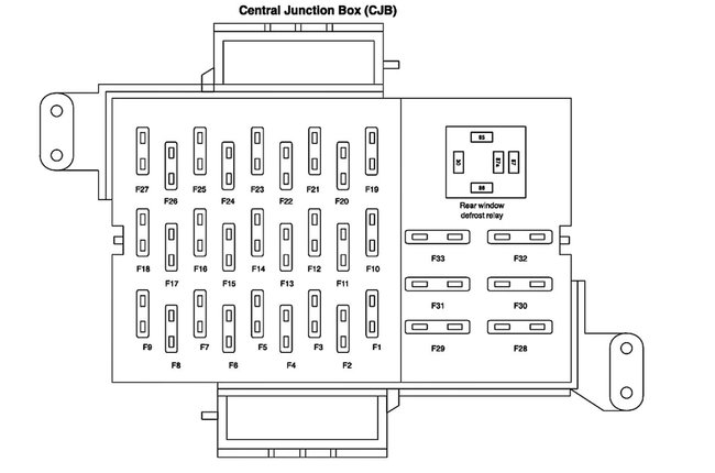

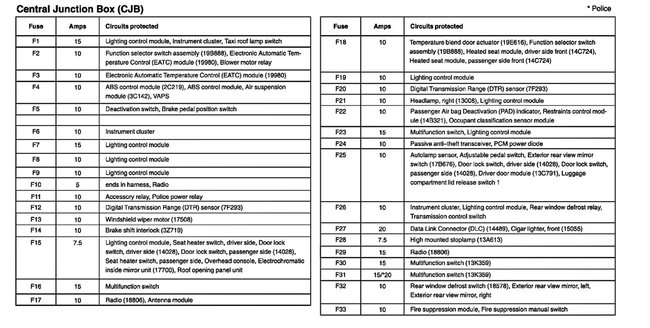

Hey 15thPanzer,
Fuse locations and fuse board layout below.
both fuses should be powered (have 12 volts both sides) with the ignition on.
Regards, Joe
Apr 4, 2019 at 4:47 AM
15THPANZER
I checked both fuses and found.crud on the blades. I put in two new 10a ones and after startup the light started flashing a 34 trouble code along with the chimes. After calling the two shops I took it to originally, they said they might have to subcontract it to the dealership anyway. So, I have at it my local Ford dealer right now. Hopefully this breakthrough will enable them to diagnose and fix it easier. I'm not really comfortable with going any further on a squrrelly airbag system. I might start doing more damage than good and I feel better with this current progress. Thanks for your help in getting this going in the right direction. This is better than having no clues at all before.
