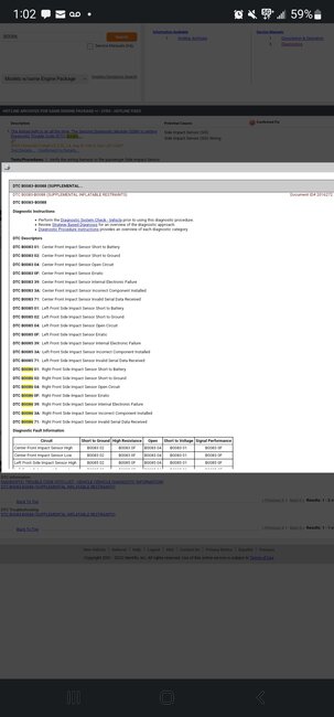

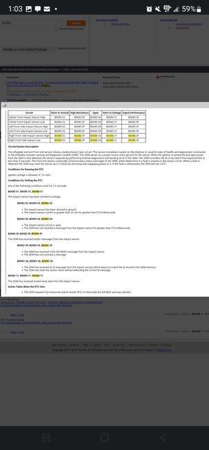

B0085_71 and b0086_71 I posted a pic of the codes, but I don’t see it on here. so here they are.

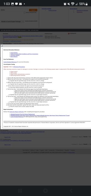

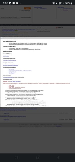

I posted the trouble tree for you but have you actually taken the inside door panel off and made sure those sensors are plugged in and wires/connectors are good to them? Thoses codes aren't for a programming error it's just saying the computer isn't seeing what it's supposed to see with the sensors plugged in.

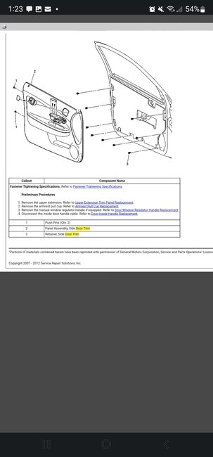

Here are the instructions for inner door panel removal.

The sensors aren't like that the computer just expects to see a set value feedback from the sensor.I would say most likely the sensor isn't plugged in the wires are damaged or maybe it's the wrong sensor and or not plugged in.
