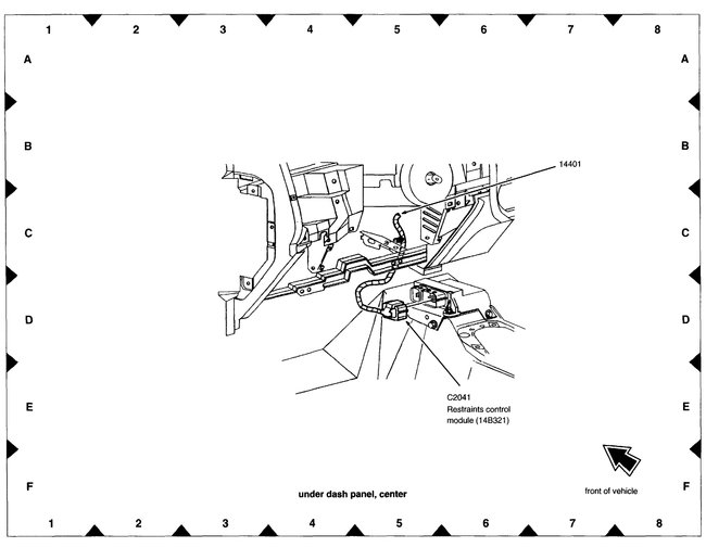

It is not in center console, pass kick panel, behind glove box. Where might I find this little evasive module? This is the Harley Davidson model. Thanks.
Oct 6, 2017 at 2:59 AM
STEVE W.
  • 15,410 POSTS
Centered on top of the transmission hump under the dash. Here is the location in the diagrams below. Please let us know if you need anything else to fix it.

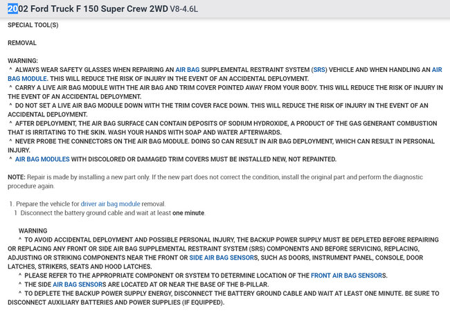

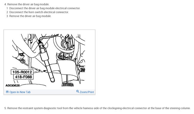

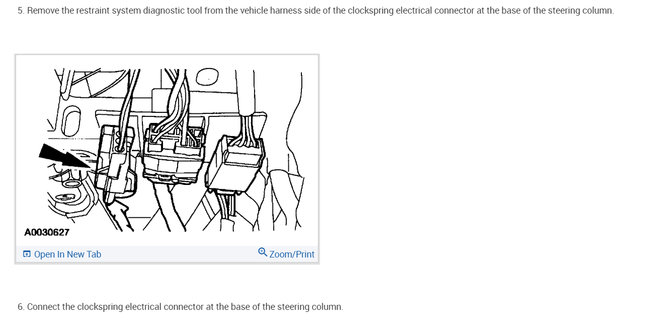

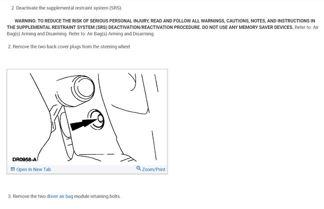

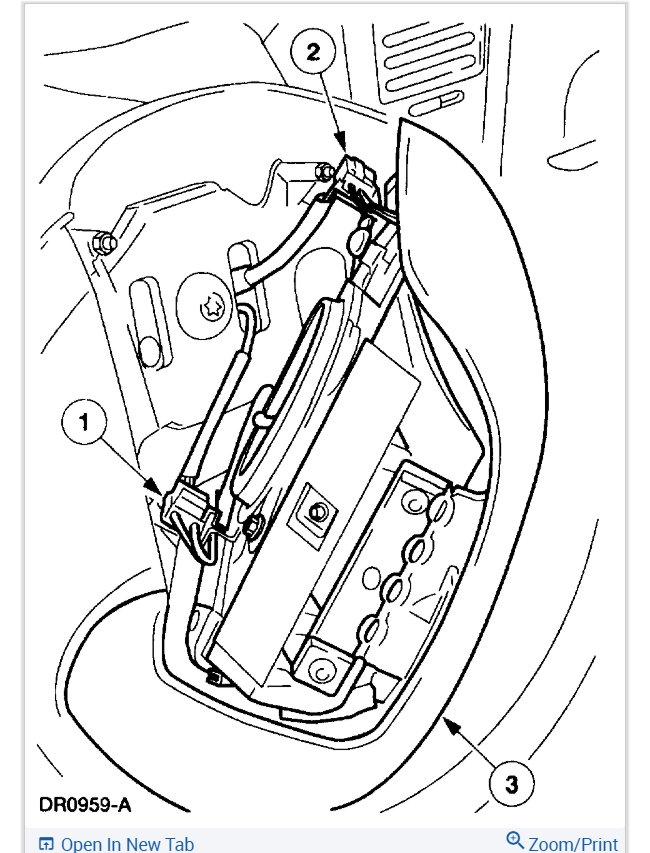

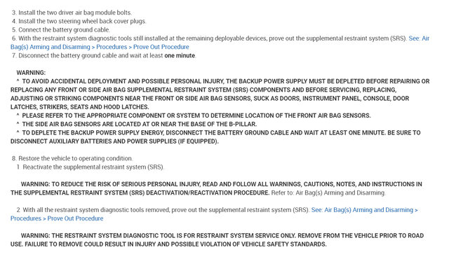

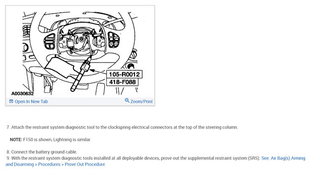

I,m looking to find the location of the airbag module. Airbags were deployed. I was told that i have to replace the module, but do not know where to locate it?
Sep 7, 2020 at 7:06 AM (Merged)
BMRFIXIT
  • 19,053 POSTS
The airbag module is the airbag itself here is a guide to help walk you through the repair with diagrams and instructions below to help you with your car.
https://www.2carpros.com/articles/air-bag-removal-steering-wheel
