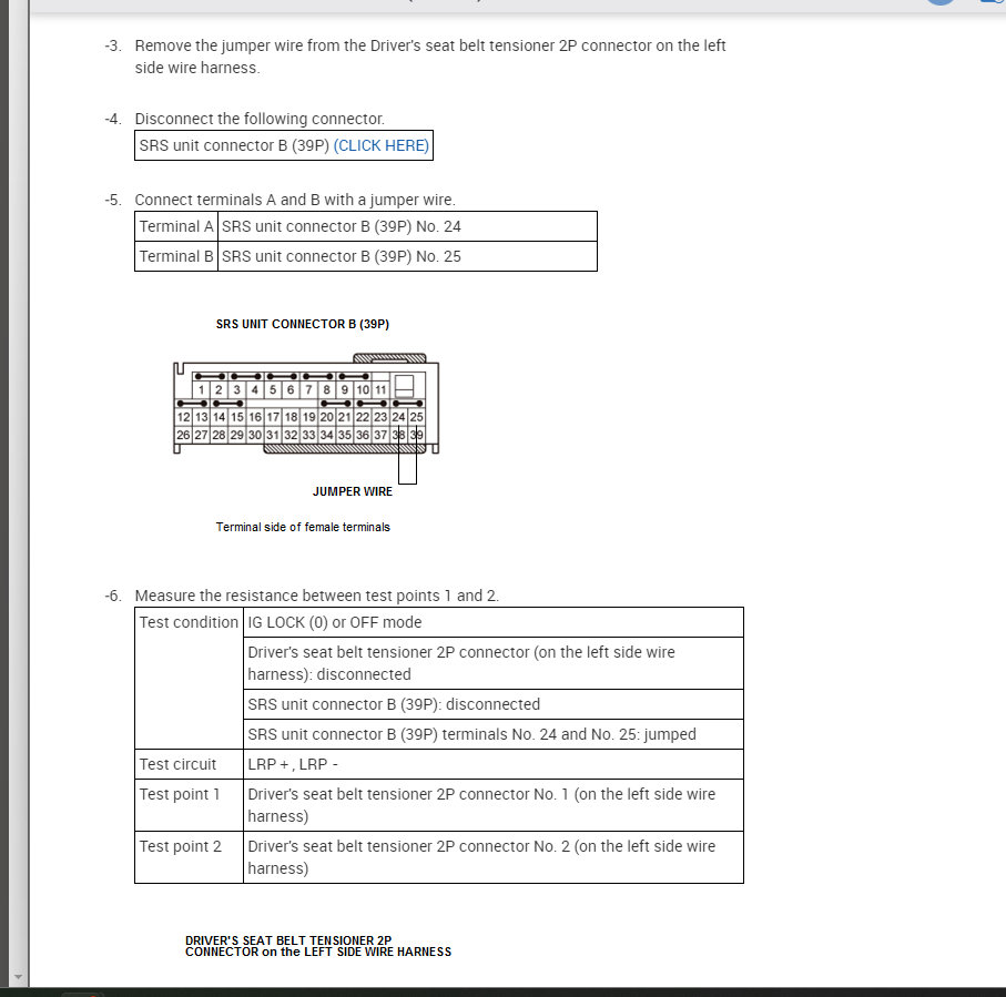

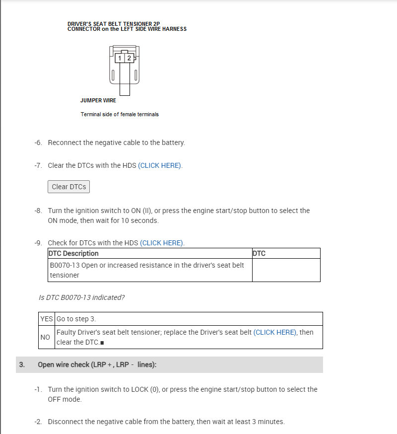

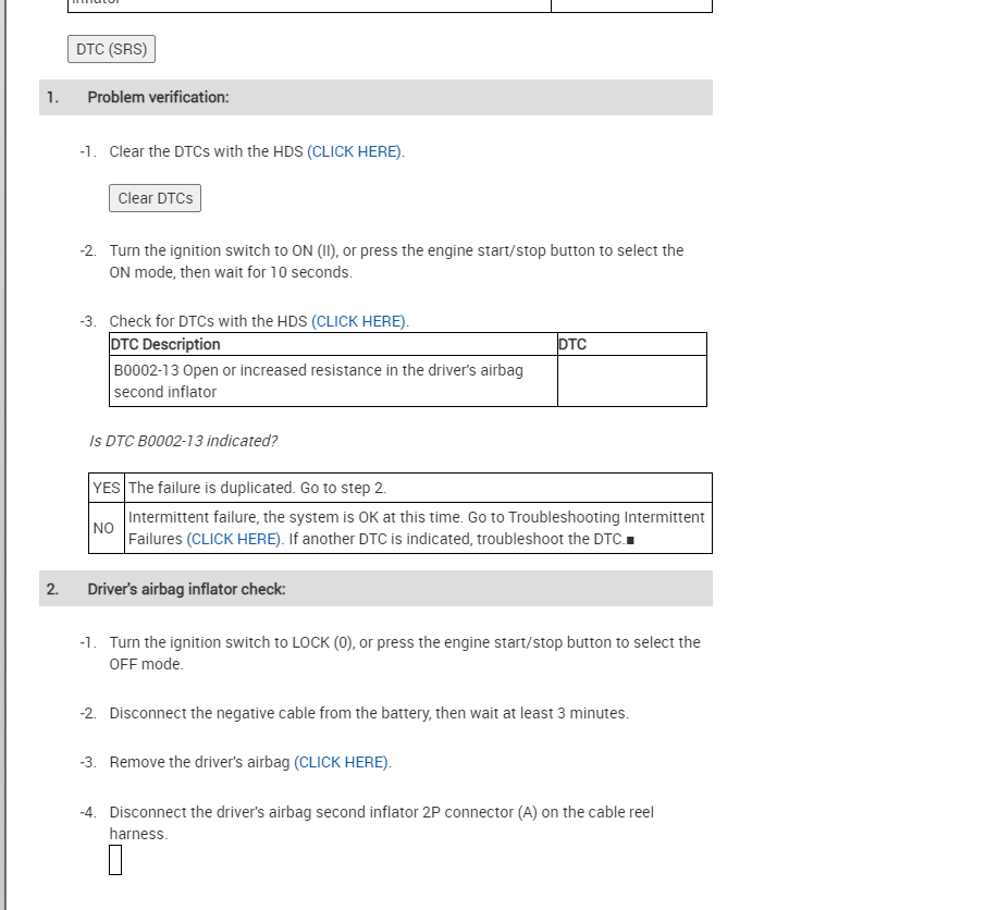

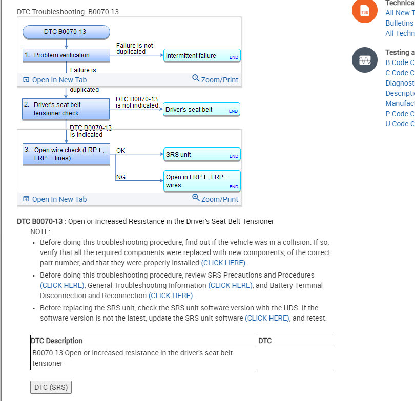

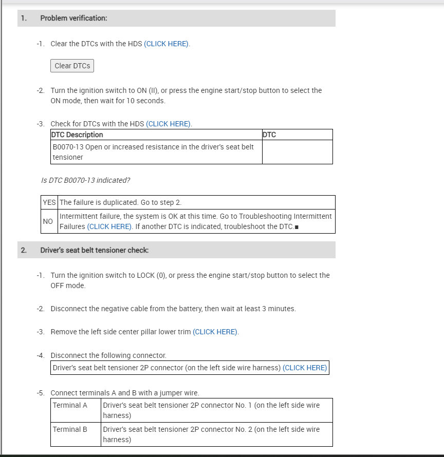

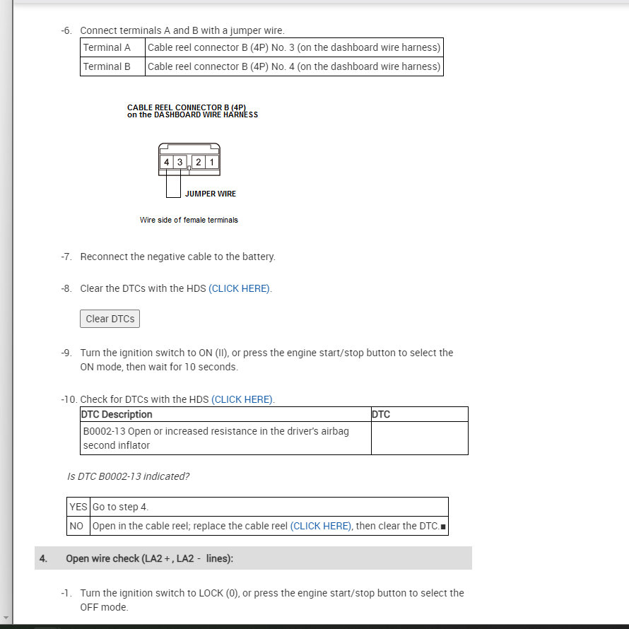

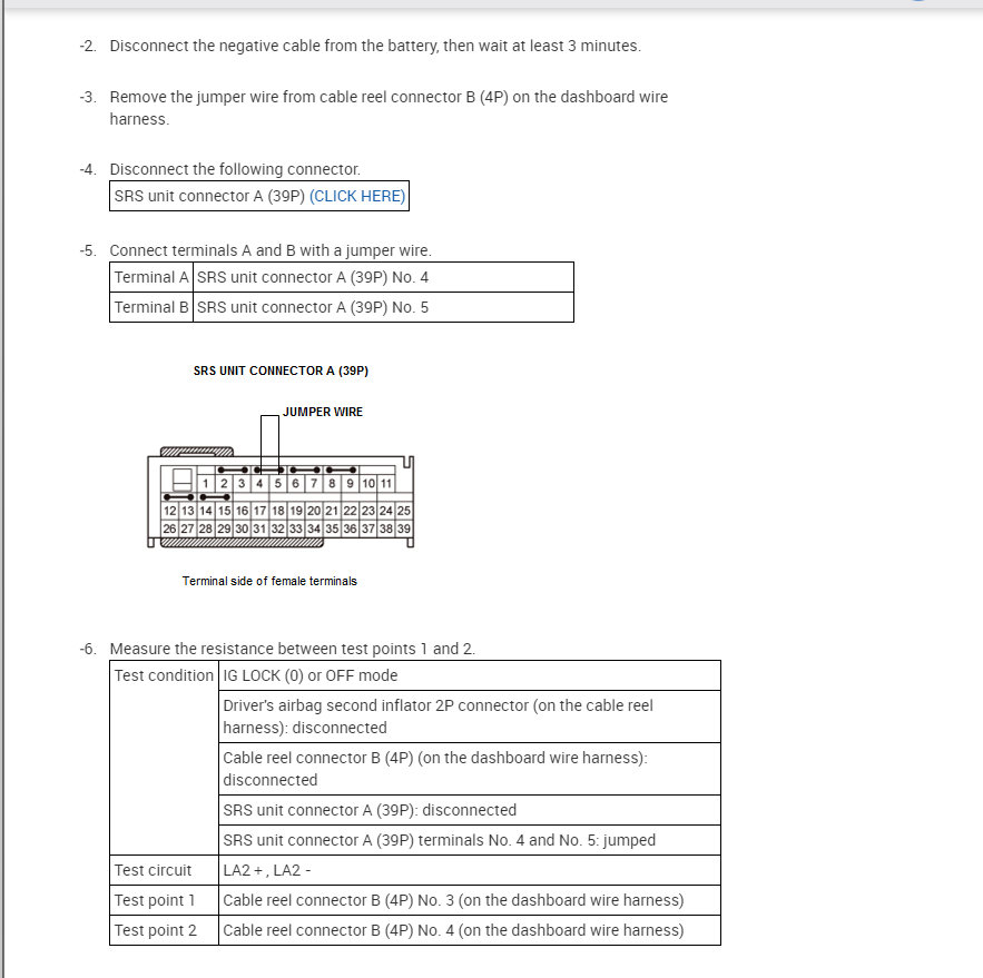

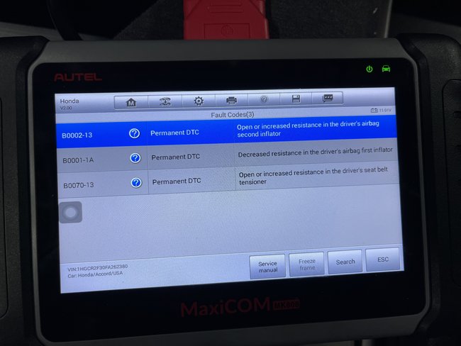

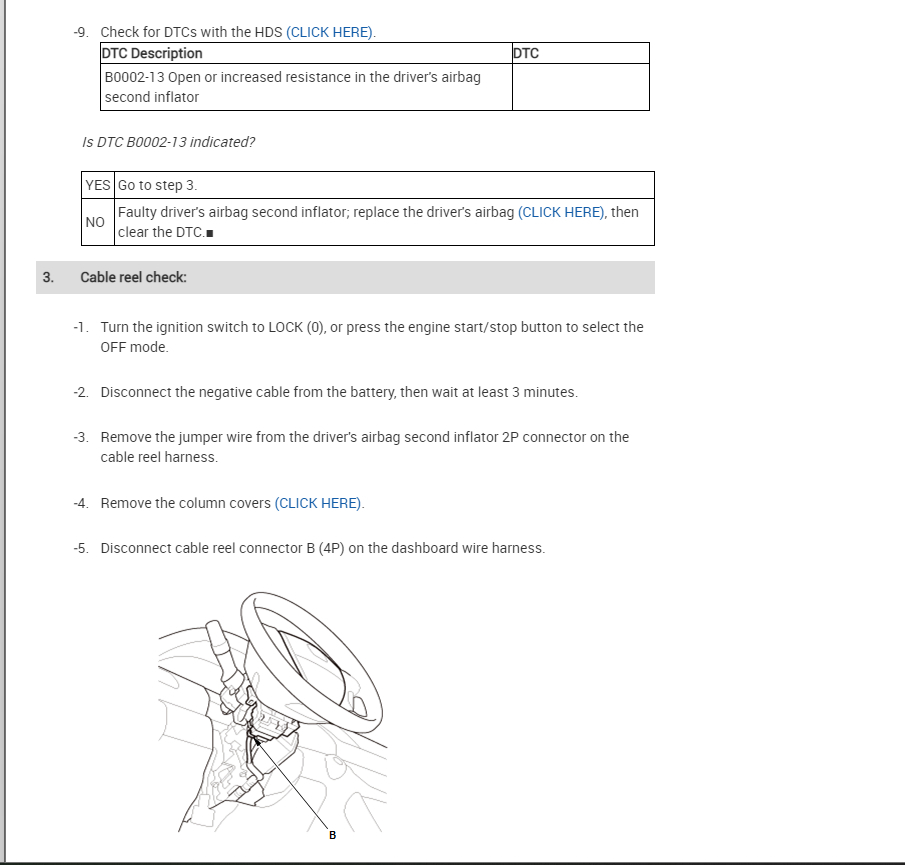

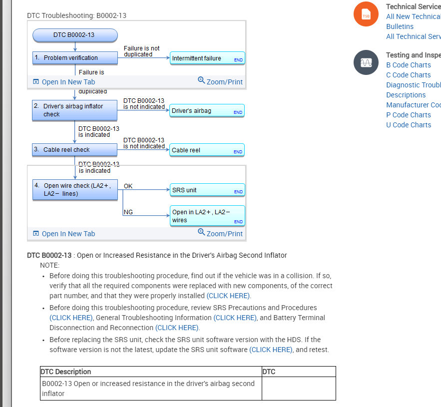

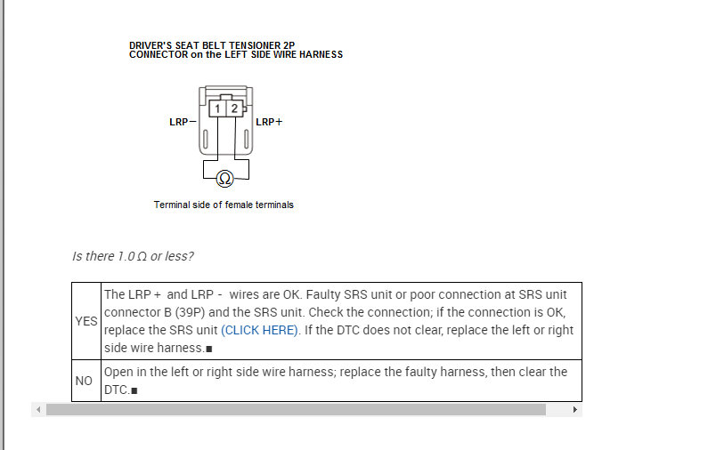

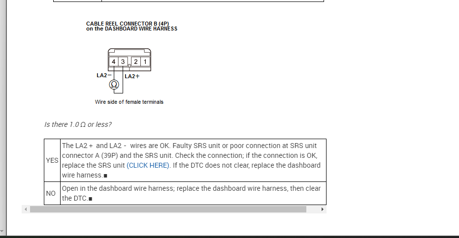

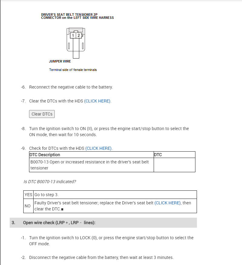

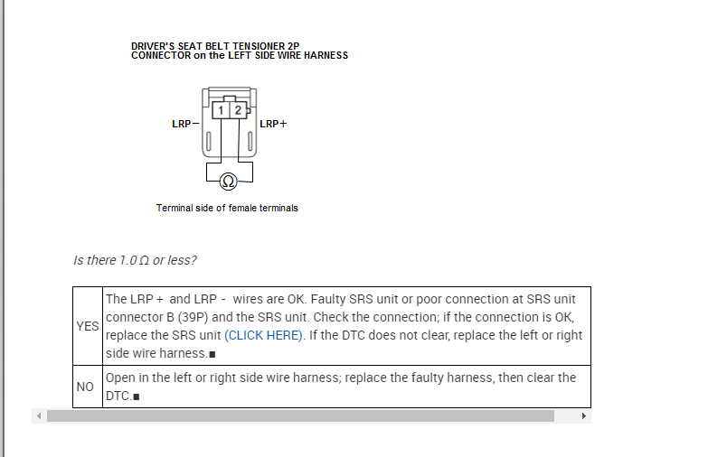

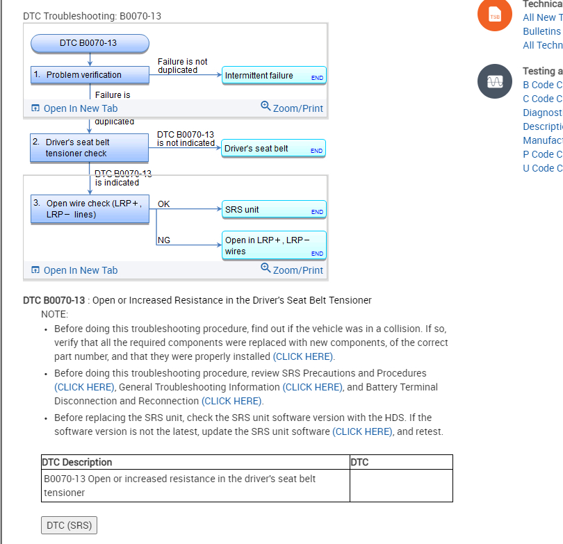

More than likely these are all related however, I am attaching the testing for the first and last DTC because they could be separate issues.
However, I would suggest starting with the first code and work through it and if the others are still there then we can address them after.
I suspect that they are all related so let's fix the first and go from there.
Let me know what questions you have as you work through it.
