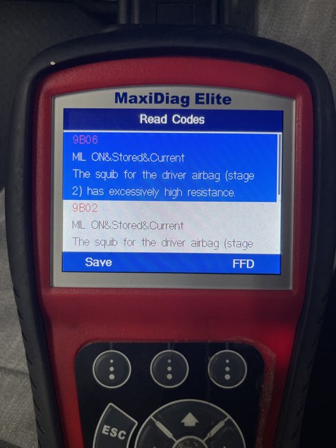

Some fuses maybe missing, am trying to find out what could this be based on codes.

This happens when the spiral wire behind the steering wheel goes out.
Here is a video of the part being changed in a simair car:
https://youtu.be/pLDjYWv-ApQ
Please go over this guide and report back.

If i order a used one with same numbers will i need to program it?

Nope, it is plug and play.
