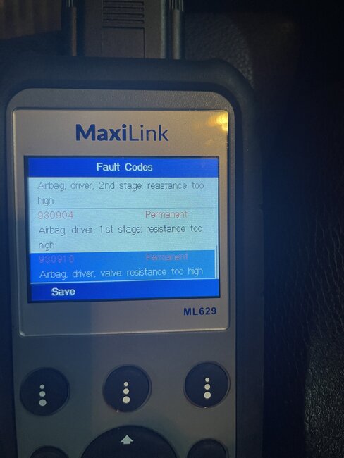

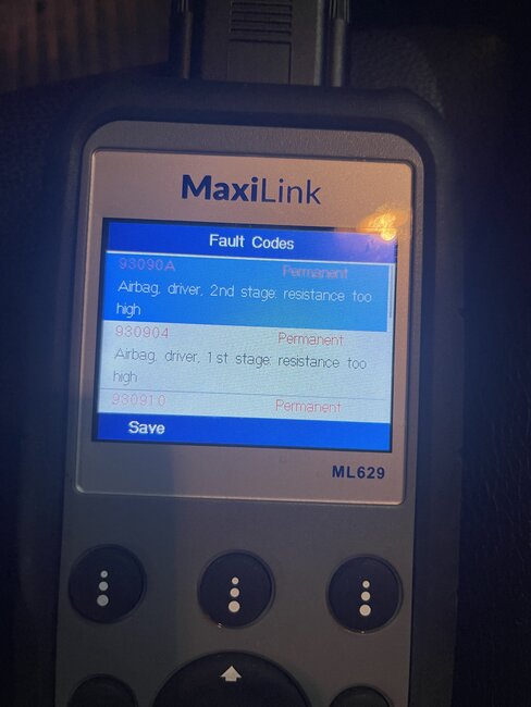

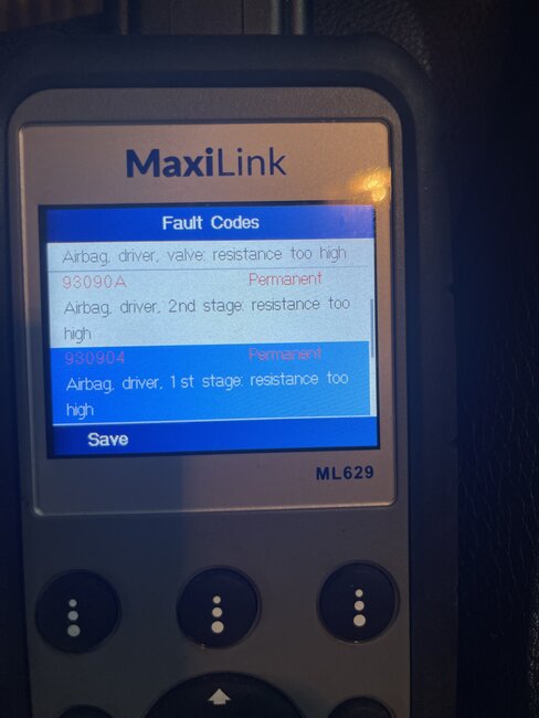

Can you share any notes on what these could mean? I have done some reading and some say it's the clock spring, others say it's the airbag, others say it's the wire on the airbag having too much tension on it. I am trying to figure out which it is. Also, the horn does not work, radio buttons on steering do not work, which is consistent with a clock spring isn't it? Would something like this cause these codes? Does a used or a new one need to be programmed?

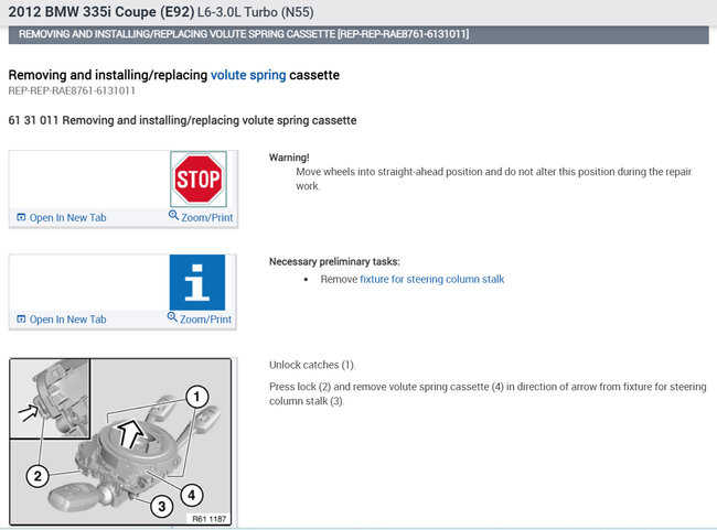

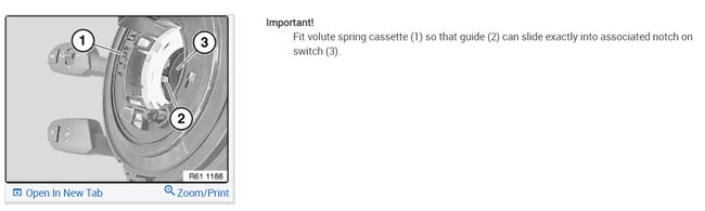

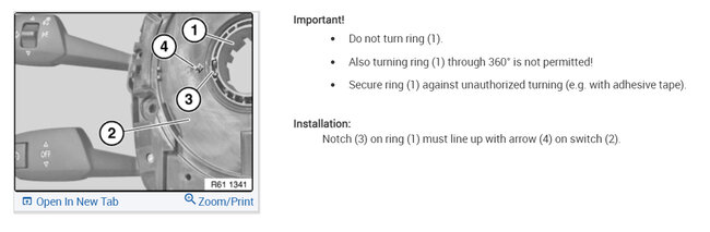

Yep, this happens when the clock spring (spiral wire) is broken and needs to be replaced. here is a generic guide to help you step by step with instructions in the diagrams below to show you how on your car:
https://www.2carpros.com/articles/steering-wheel-clock-spring-removal
Check out the images (below). Please let us know if you need anything else to get the problem fixed.
