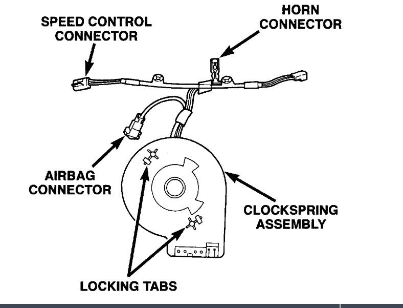

Can a bad clock-spring short out other circuits besides airbag, cruise control, horn etc?
Jul 26, 2020 at 12:57 AM
Good morning,
The clock spring will not short anything out. It will open the circuits and not allow any current.
I attached the procedures for you below.

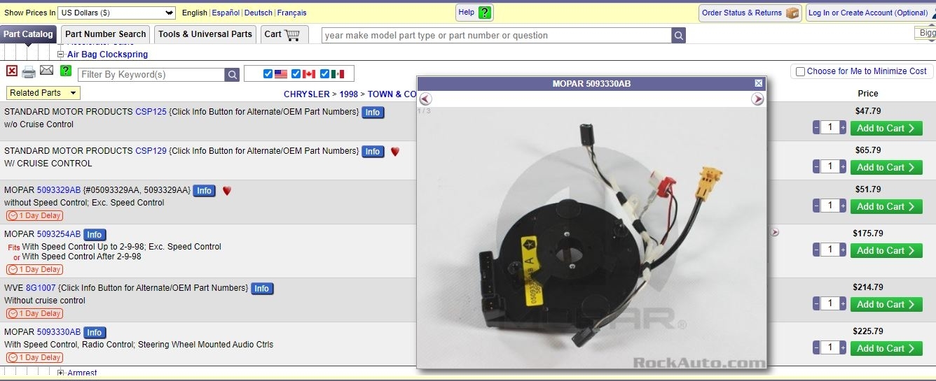

I also attached the part for you.

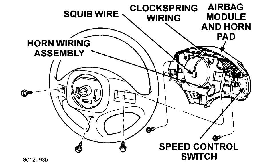

4. Remove driver airbag from steering wheel.
5. Disconnect wire connectors from back of airbag module.

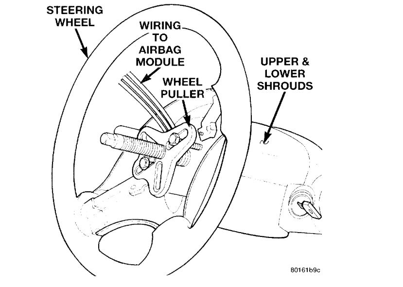

6. Remove steering wheel.

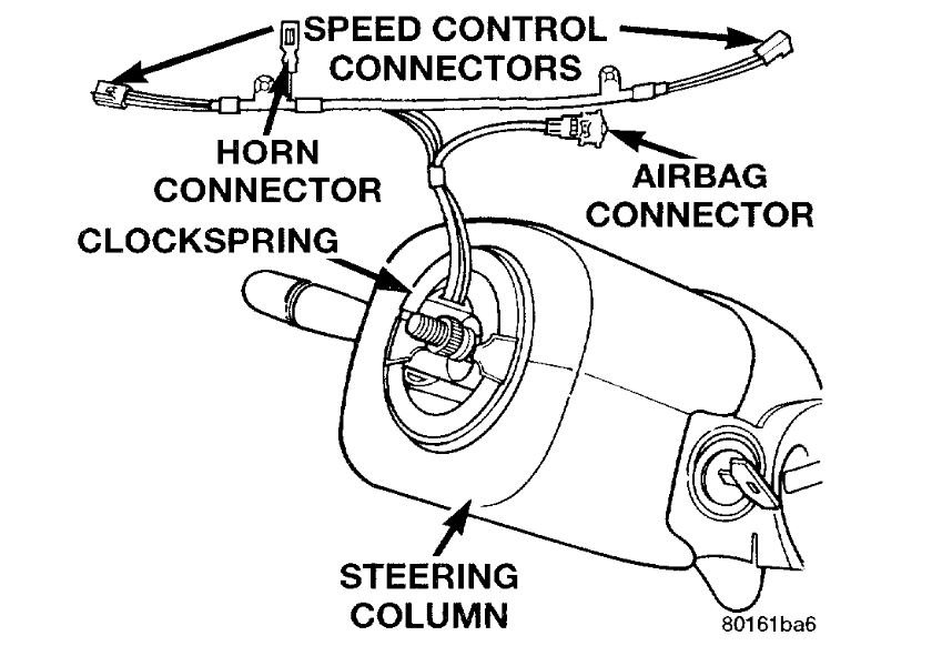

7. Remove steering column shrouds.
8. Disconnect 2-way and 4-way connectors between the clock-spring and the instrument panel wiring harness.
Clock-spring Locking Tabs
9. Remove clock-spring from housing assembly by depressing the two tabs on the clock-spring.
