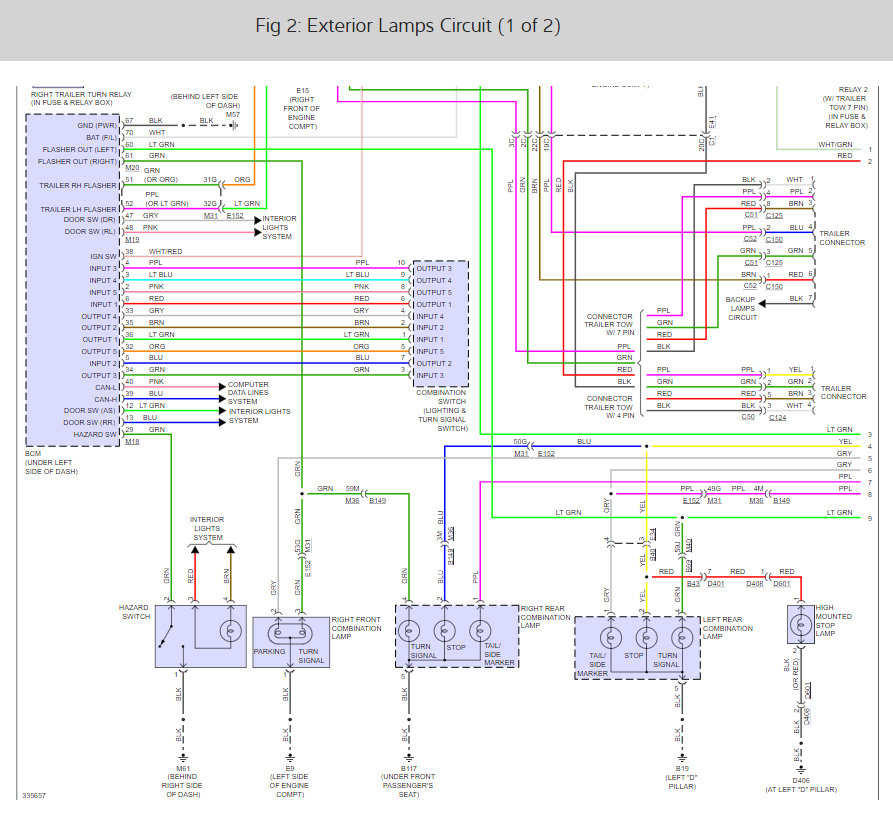

The airbag light was on and the horn did not work so I got a new one from eBay, installed it and light went out. A couple days later I got pulled over for no tail lights, so the fuse was blown and kept blowing. So I took out all bulbs and replaced one at a time to check for short. Got all in except for license plate and one of them did not work so I switched with the other and my steering wheel started smoking. I took wheel apart again and clock spring wires were melted so I got a refund from eBay and ordered an OEM part installed it and it worked great for one month. Now my tail light fuse is blowing again. Where do I start looking for a short or is there something causing the clock spring to go bad?

The first clock spring melted in two days after playing with license plate light bulbs. The second one melted after thirty days. The fuse for the tail lights kept blowing so I put new fuse in and messed with the license plate light bulbs again, one was working, so I left the other one out, started driving and things started going haywire in the steering wheel. The fuse did not blow and the clock spring sounds like it is grinding again like it did after it melted the first time. I have not taken it apart yet this time to check it out. I only changed it the first time, because the airbag light was on and my horn did not work. It was changed according to proper installation procedures and many videos I watched on YouTube and everything I read online.

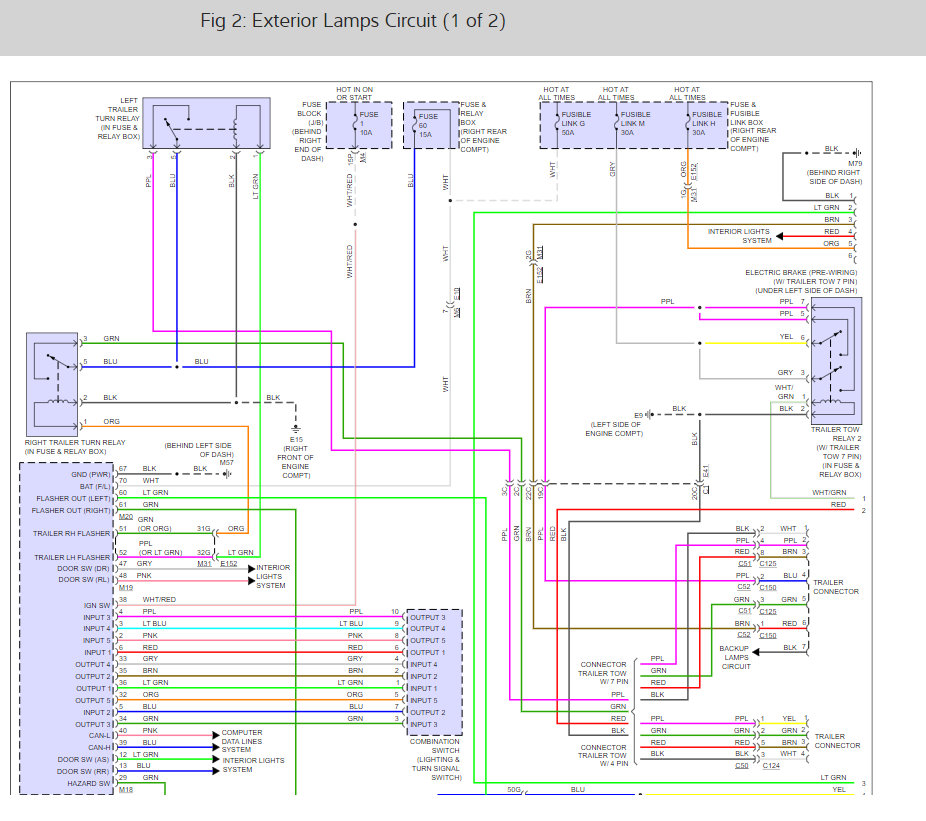

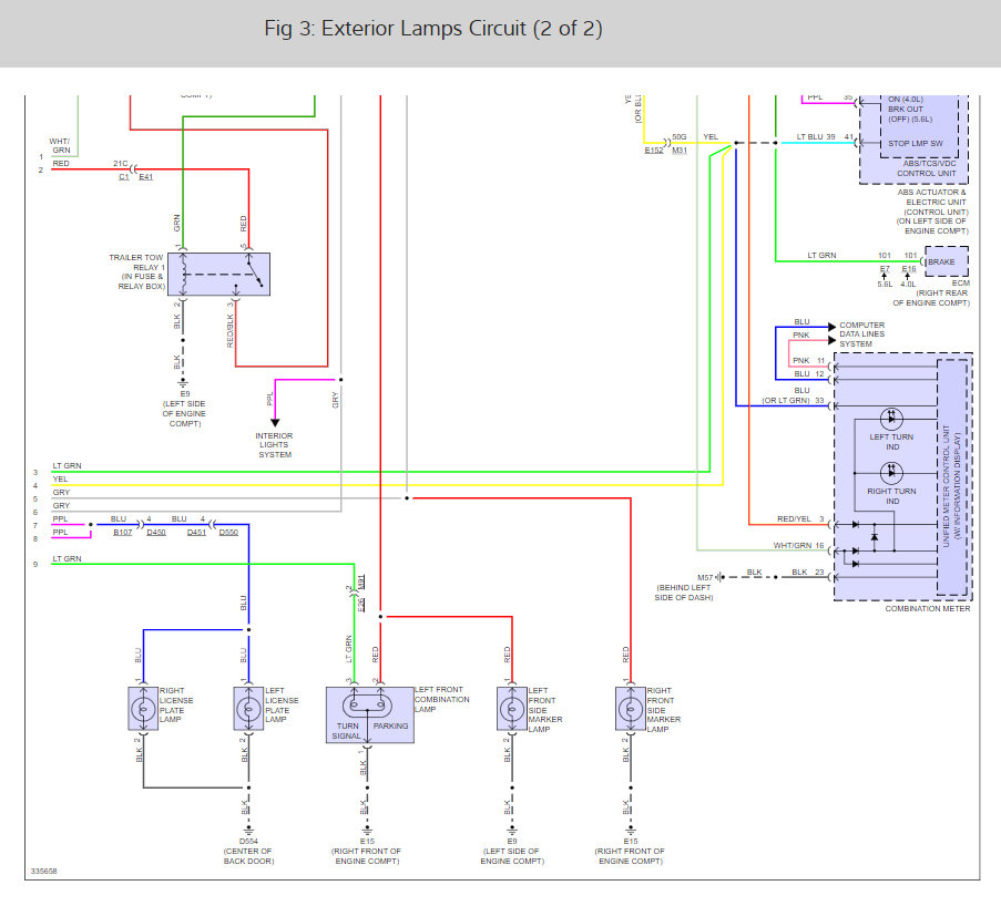

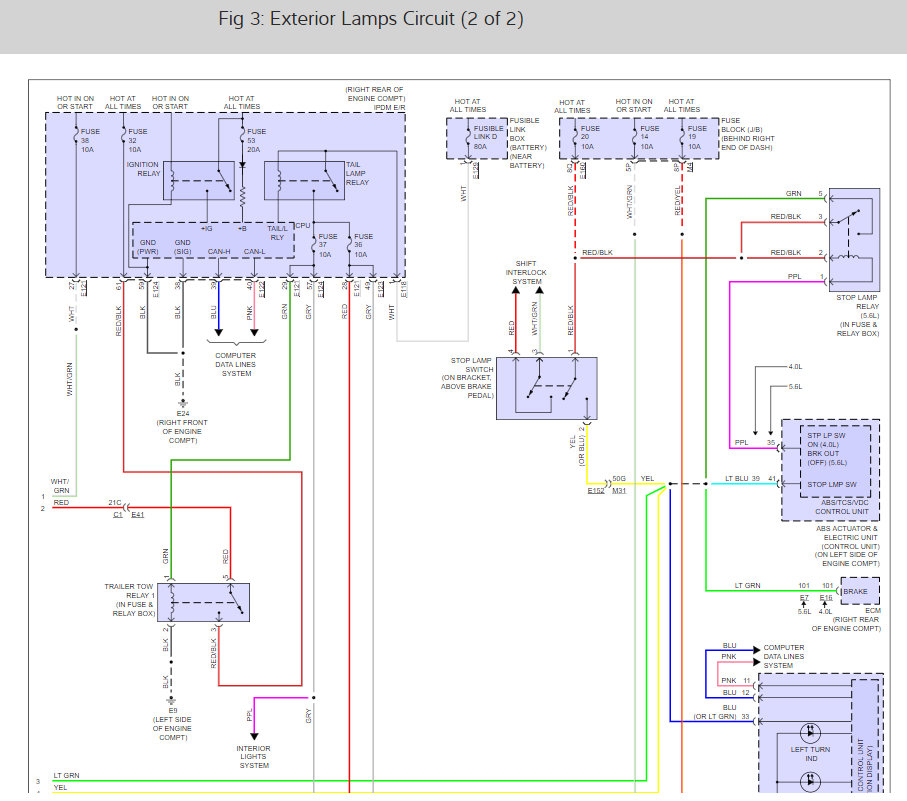

It sounds like you have a wire that is shorted to ground causing the parts to go bad. I would run a pin to pin test and resistance to ground. Here is a guide and the wiring diagrams to help you get started.
Clock springs go out all the time due to wear, the smoke is telling us short somewhere.
Check out the diagrams (below). Please let us know what you find.
